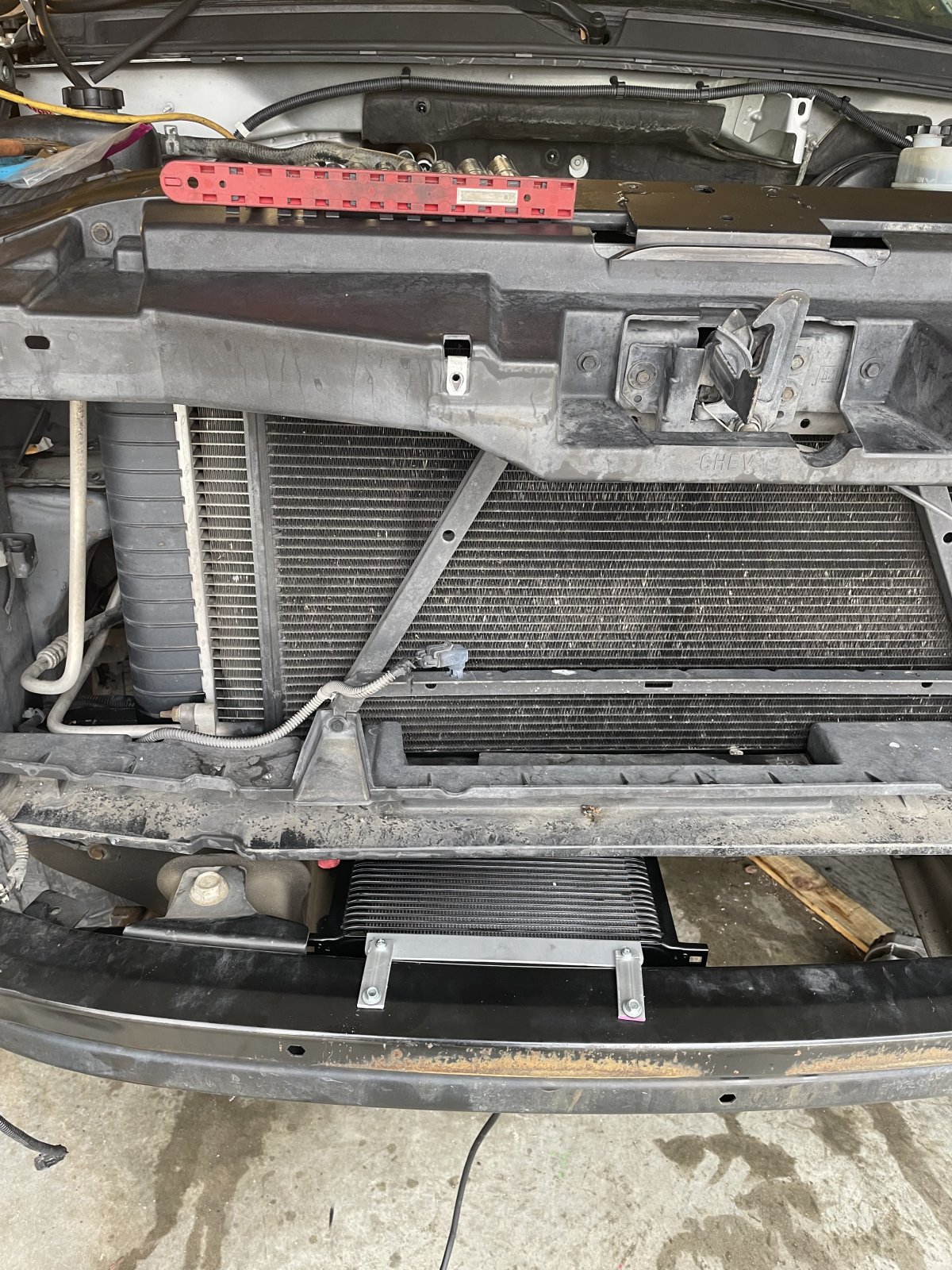

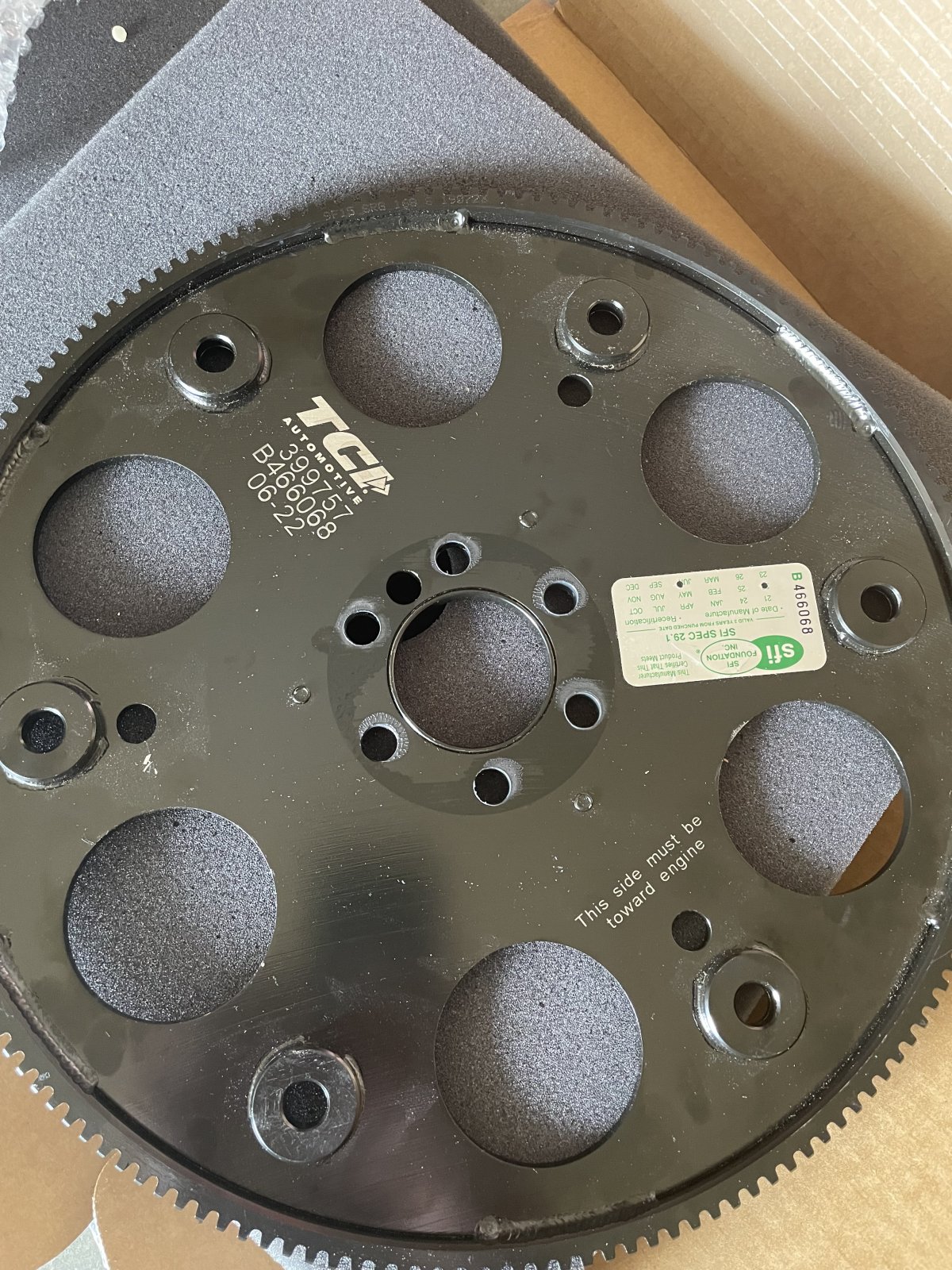

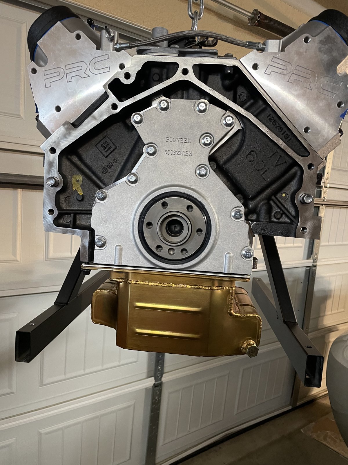

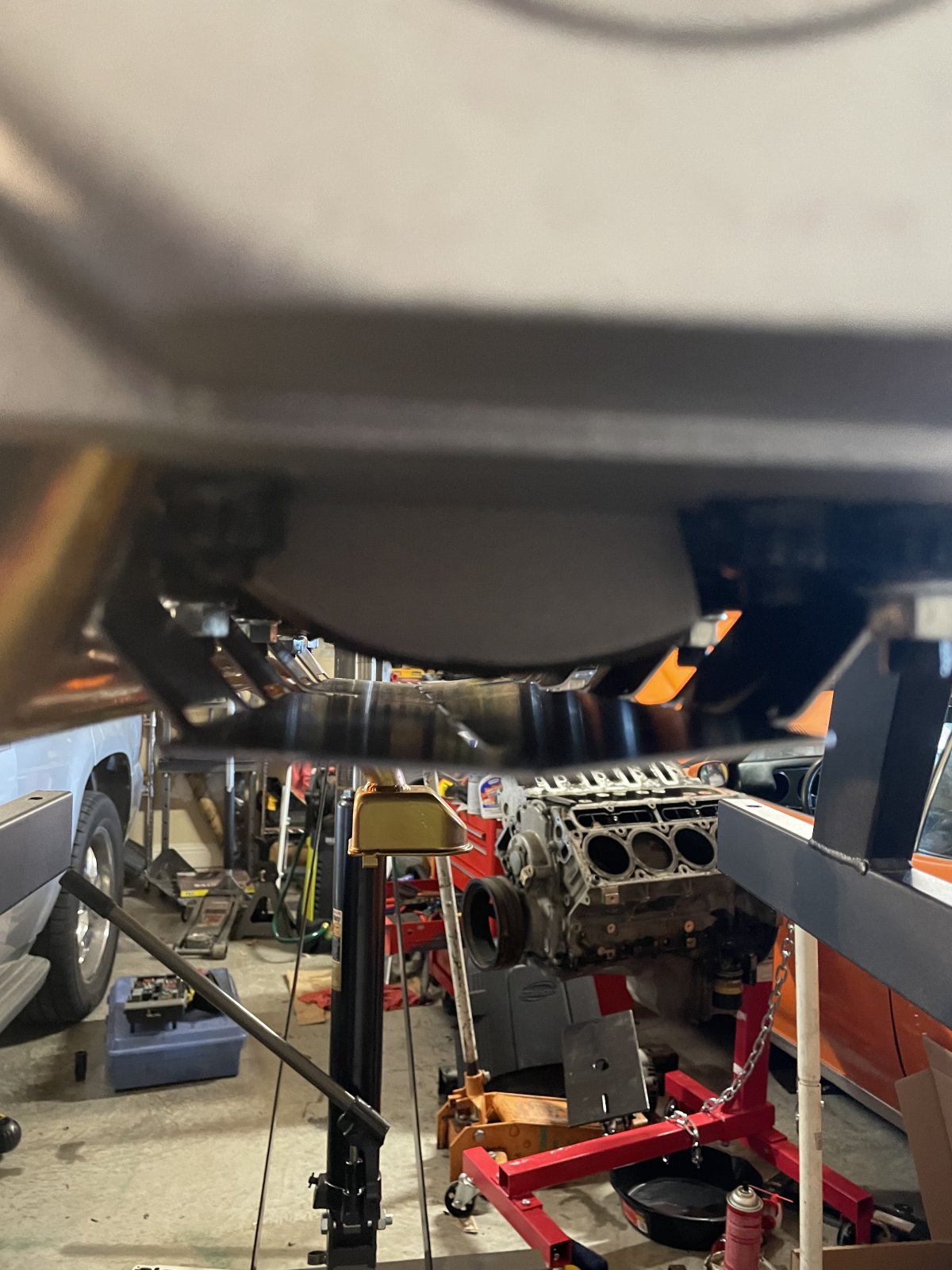

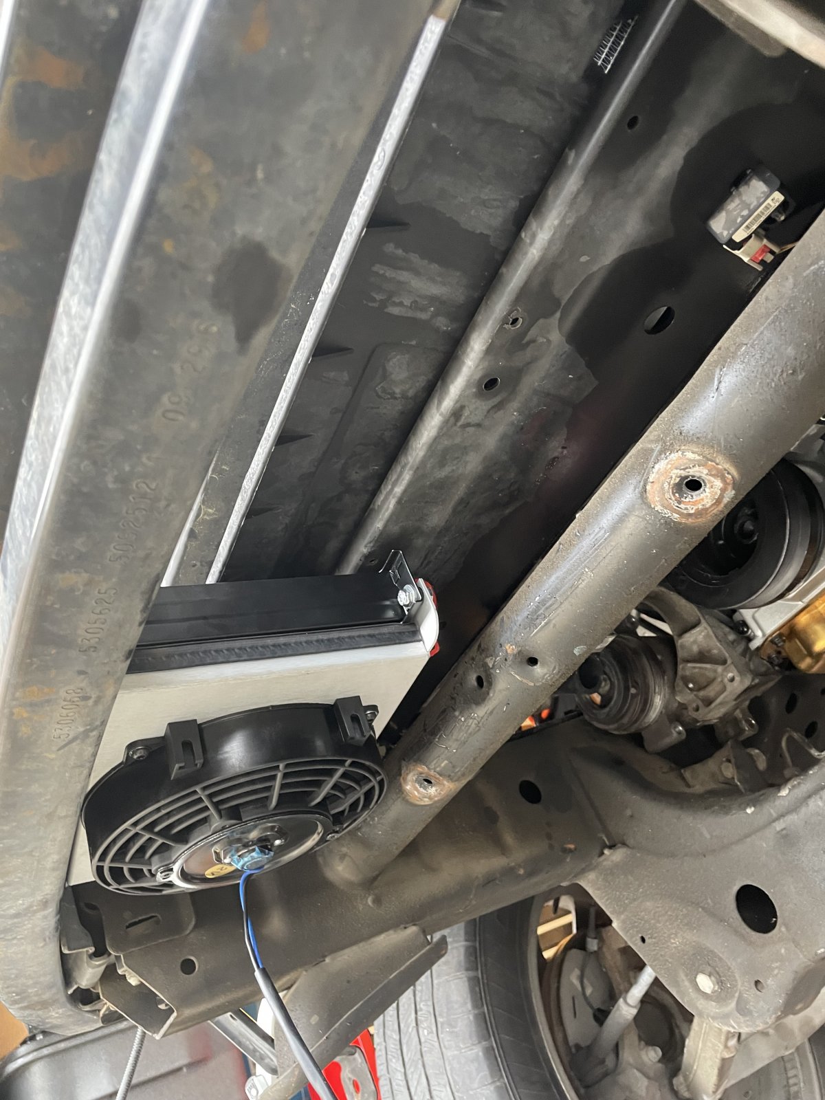

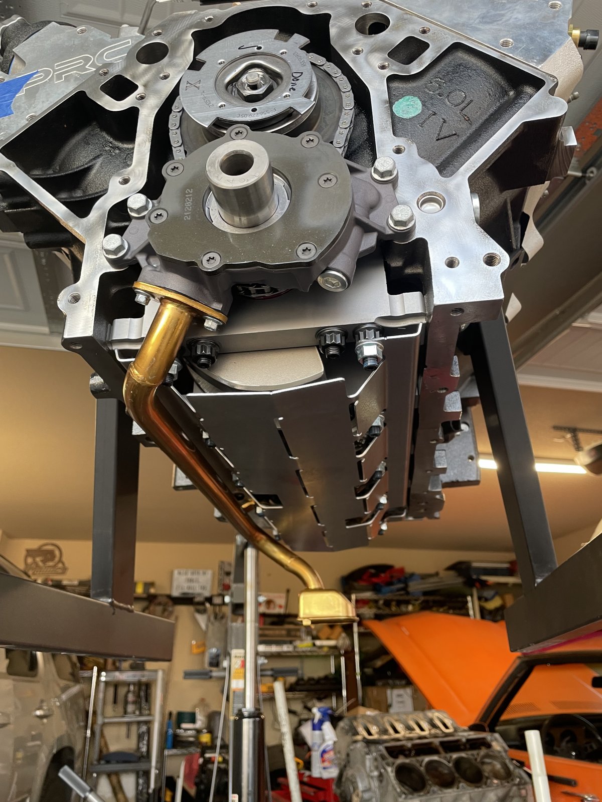

I think I read that you are supposed to flush the transmission lines and the cooler before installing the new transmission. Sounds like that is what you are recommending here also? What did you find in filter and how did you use that information to prevent disaster? I've been wondering about this since I started this process, and although I'm a few months out from having the engine installed, I'm trying to learn all that I can right now. So your input is greatly appreciated!Oo stroked 6.0
I went from a 5.3 to a 6.0, just from the tune i have been running during the engine break-in, the difference between the 6.0 vs the 5.3 is pretty noticeable.
I wanted more low end mostly, and i got it.
i haven't done much with WOT yet, but the tune still needs work.
With my build, i also went with a new circle d converter.
I think at some point i tossed some trash through the cooler lines (or trash was already there) and it ended up taking out my thrust bearing twice.
That's where i sit now, get an oil filter cutting tool too.
I ran the extra capacity filter + i cut the filter open after ever 200 miles of engine break-in.
that saved my ass from losing a shit load of money.![]()
