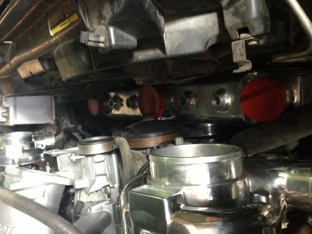

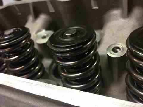

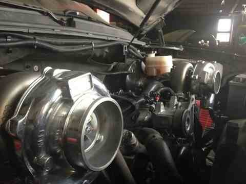

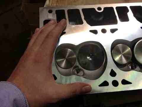

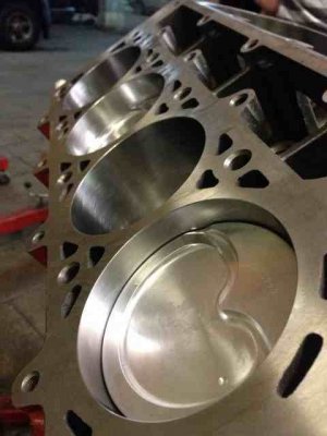

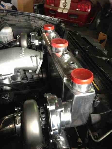

Hmmm...actually it took longer than I expected. The engine is running well now:))
During the process the concept has changed to twinTurbo application. Two superchargers on one belt was not the right decision in the beginning. Belt is burning actually in action. So if somebody will decide to built that, need to use short tooth belt instead of rib one.
So in the end we have 416ci twinturbo engine and the list of parts installed looks impressive :))
Block
LSX short block (GM Performance Parts)
Lunati crankshaft (416ci)
Lunati rods
Wiseco pistons
ATI damper
Clevite bearings
ARP lugs and nuts
Heads
CompCams camshaft .588/.588
Ferrea valves
Lunati valve springs
CompCams trunnion kit
CompCams pushrods
Rollers GM Performance
Cometics gaskets
ARP lugs and nuts
TrickFlow timing chain set
Durabond bearings
Melling high performance oil pump
NGK spark plugs
MSD wires
Fuel system
2*BOSCH 044 fuel pumps
Automotive Industries fuel pump brackets
Holley fuel rails
AEM pressure control
Injector Dynamics 1000cc fuel injectors
Aeromotive secondary fuel pump 400lph
Intake
Twin turbo Garrett GTX35 1.03 A/R VBand
Wastegates TIAL 44mm VBand
BLow off valves TIAL 50mm VBand
Holley EFI intake
Water to Air intercooler(custom)
Exhaust
Custom headers
Corsa muffler
SW 2*mufflers
Suspension
Arnott/Bilstein struts
DJM bars
Eibach springs 2" drop
PU bushings
Brake system
Superbrakes 6/4
DBA rotors 410mm
Ferodo DS2500
Here is the first engine start made monthes ago: http://youtu.be/ye5CqiQb2FM
Today the engine works with lightly modified transmission, so waiting for the new transmission built.
Also I've ordered new 3.73 axle gears instead of 3.42 stock size and new ls differential lock. So...will see, it should have even better dynamic with the current tranny :)
