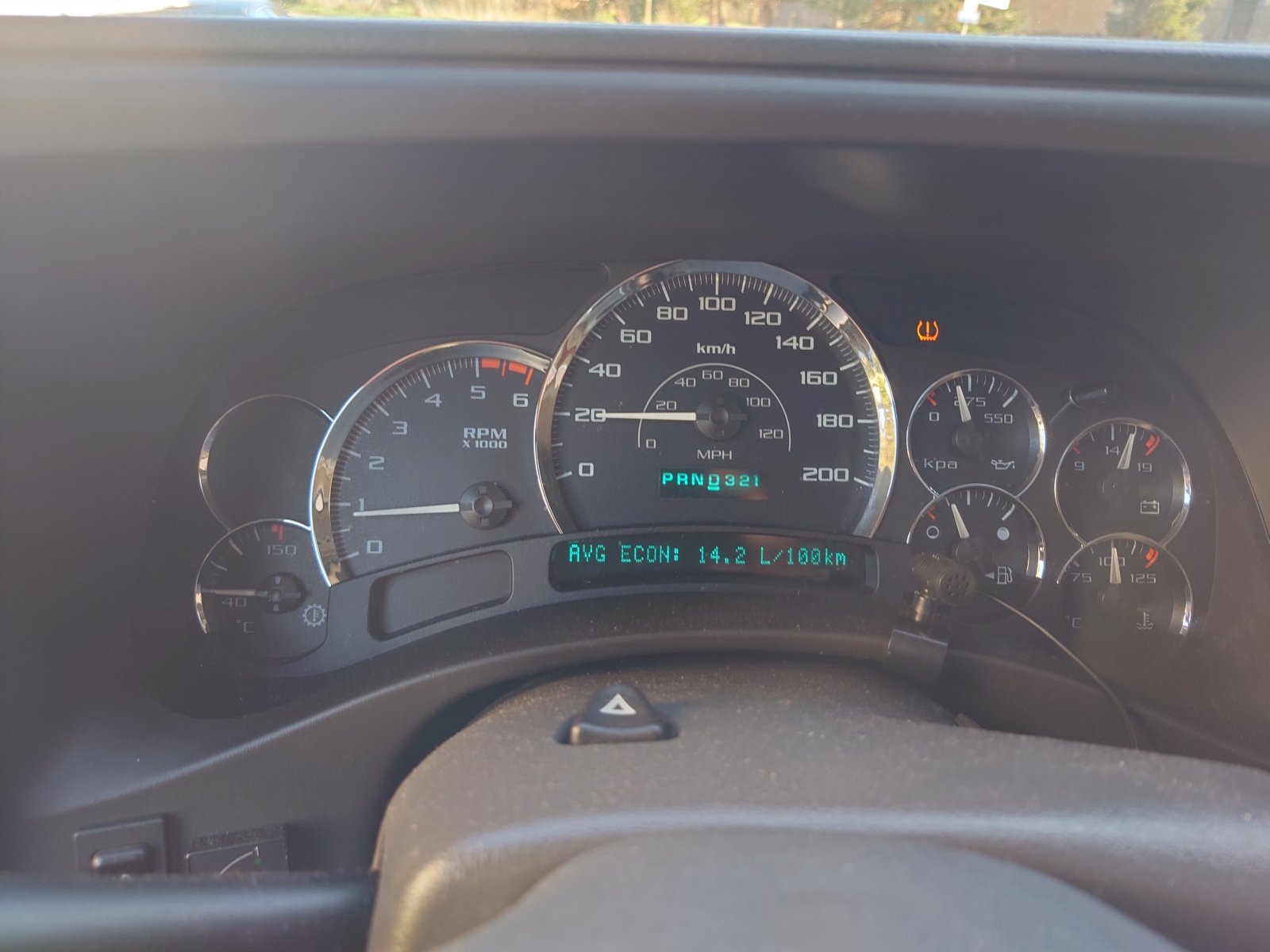

I have a 2004 Tahoe and want to get the cluster out of a Denali with the trans temp gauge. My cluster does not have the trans temp gauge. From what iv'e read it should plug right in and work. I know ill have to get it programmed so the mileage is the same but the trans temp gauge should function regardless right?

It’s a crap shoot and there’s no way to know if you need it programmed but I believe if you need it done, the programming is done to the cluster and not the PCM or ECM. If that’s the case ( somebody more knowledgeable please chime in) then it can be done by whoever programs the mileage.

You need to get it programmed to your vin to get the steering wheel buttons to work, and you might have some dash lights on too if you don’t get it programmed to your vin.

Yup, when I got mine they did the programming for free if you supplied the vin number
Pretty sure my Esky cluster came from an 04. I needed to have it rebuilt(senders), also had my proper mileage programmed and that was it. I didn't need the vin from the donor. Plugged it in my 03 Hoe and everything worked fine. Trans gauge too.

Clusters are plug n play. Only programming needed is for mileage, everything else is plug n play.
