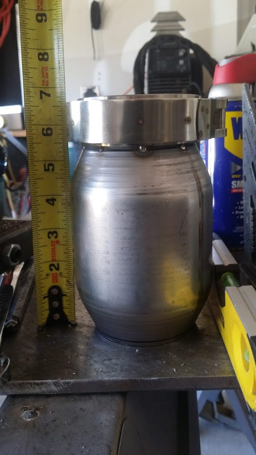

I personally like the sound with cats, especially Magnaflow hf spun cats 59956.
They're very small and legal in all 50 states. I used them in MA and NC with zero issues.
You can cut them down to make them tiny if space is an issue.
This was one I made a few years ago fitting it up to a V-band, cut it down quite a bit to fit on a LT header.
As for LT headers, you can get them catted but, they'll run yah a mint that's for sure. I like Thorley Tri-Y headers but am not sure how popular they are on here. If you know anyone who can weld I'd grab a set of Thorleys and some Maggy cats and some 3" tubing and go to town with a Maggy **** it would sound good.
