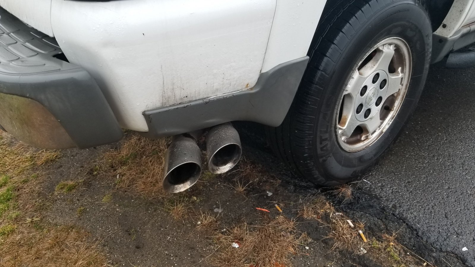

Mine dumped where the spare tire does creates a good bit of fumes, I feel like I got pepper sprayed if I leave it running on a still day while hooking up a trailer, but I still love it! :insane:

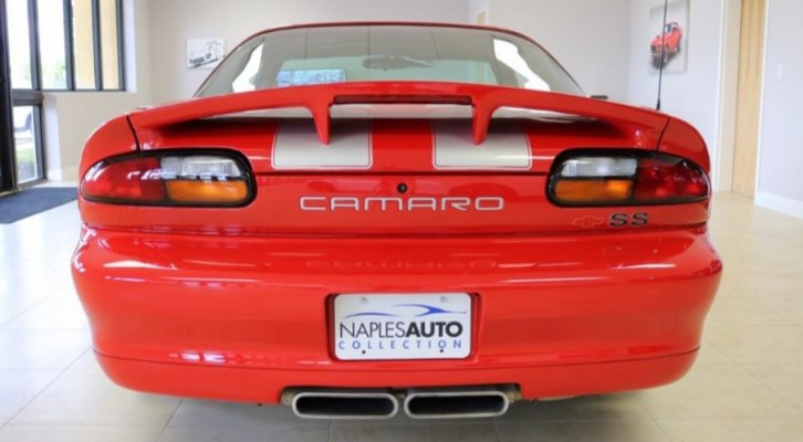

Thanks for the suggestion. I think I've settled on exhaust tips from a circua 1970-73 Corvette like the one shown below. This is one made by Magnaflow. Its inflow opeining is 2.5" and outflow opening is 3'X5.5". This should allow ~5"-6" of separation between the exhausts. IMO the sharp angles of this gen corvette's exhausts fit the linear body edge angles of 02-06 Escalade styling (as compared to later versions which have more curved edges styling). Also, the rearward rake of this exhaust opening will minimize the potential of accidental contact with hot exhausts when accessing the hatch. The top edge of this exhaust will be set back slightly the bumper face. GM added a trim bezel on some Corvettes, which I hope to incorporate when I make the valance. I think the combination of setback, the exhaust's rearward rake design, addition of a valance surround and a trim bezel will all but eliminate possibility of accidental contact with the exhaust tip.
I'm not too concerned with exhaust fumes coming thru the open hatch as I don't imagine we will be loading the truck while its running. Also, I don't plan to ever tow with it. In fact, the trailer hitch and spare have already been removed. If any of y'all need a spare, 17" Escalade wheels or a hitch and live in driving distance of N. AL let me know. I'll make you a good deal!

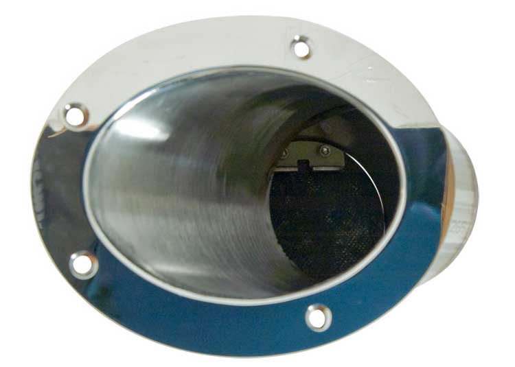

Ok, so here is one of the exhaust tips I’m considering. It receives dual exhausts. You are welcome to give an opinion.
Not sure it’s my cup of tea but it’s growing on me a little Wonder how it would look if it was blacked out on the interior so it looked as though the actual exhaust port itself was bigger.

That's an idea. I thought about going with a wider exhaust which has the same general shape. But I'm trying to accomplish a bunch of things at once looks-wise. I want the exhausts center rear and mounted within the ~17" indention in the bottom of the bumper where the tow hitch previously resided. I think this will give it a more engineered-that-way look plus the indention increases exhaust-to-ground clearnance about an inch. I also want to have some separation between the exhausts vis-a-vis C6 era Corvettes; and, I want to stay as true as possible to the sharply linear body angles of this model Escalade. It's lines are my main reason for going with an 02-06 generation. So I'm not going to design the valance until I can see the exhausts on the car to make sure they "fit" the overall look I'm after. If I have enough space between the exhausts I'd like to experiment with different center plates (again circa C6 Corvette) and maybe make it possible to easily swap out emblems on the center plate. Blacked out exhausts and matching center plate might look good, especially if I can exchange center plate emblems according to my mood, the season, events, etc..
