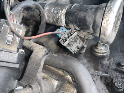

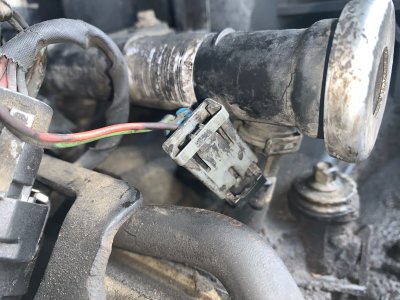

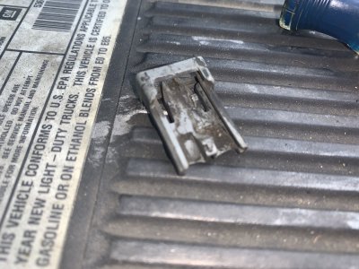

I'm already stumped on this project with removing the fuel injector connectors. The service manual isn't any help and I haven't found an external reference that's helpful, either. See attached images for my installation. The injector connector I have doesn't match the service manual. I figured out how to removed the retaining clip, but can't find a tab to push that will release the connector.
What am I missing?
What am I missing?
View attachment 248236 View attachment 248237 View attachment 248238 View attachment 248239 View attachment 248240
See if this helps...

So did you have to use the pick? Or did they come out easier than that?
