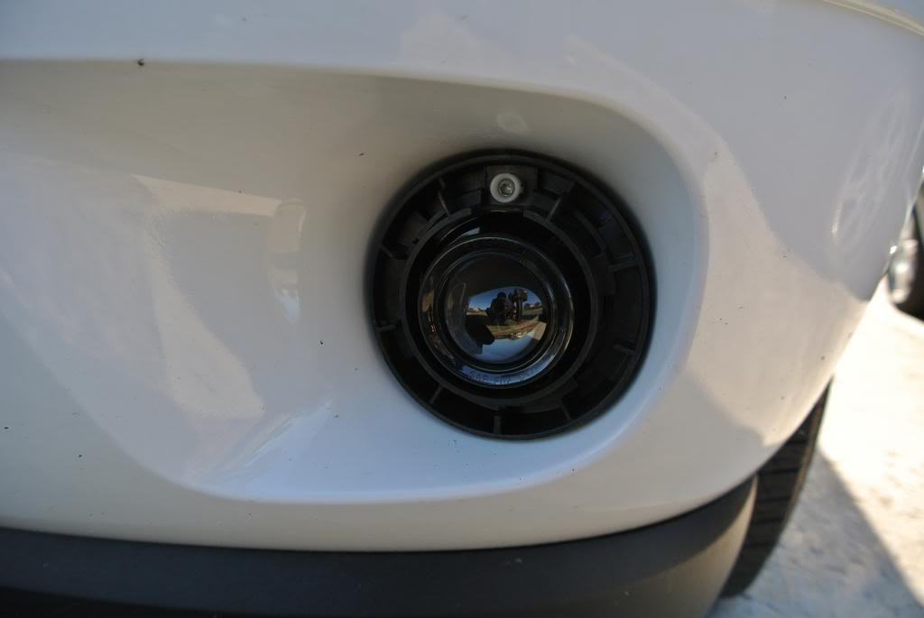

Yep...I finally got them right. I worked with a projector set before winter, but the main problem was to get a shroud that fit the projector. I could not find one that would. So I looked for a retro fit, and I think i got it right.
Here's the first photo..

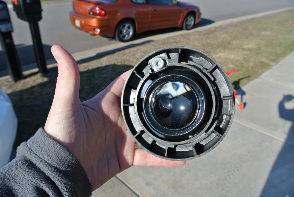

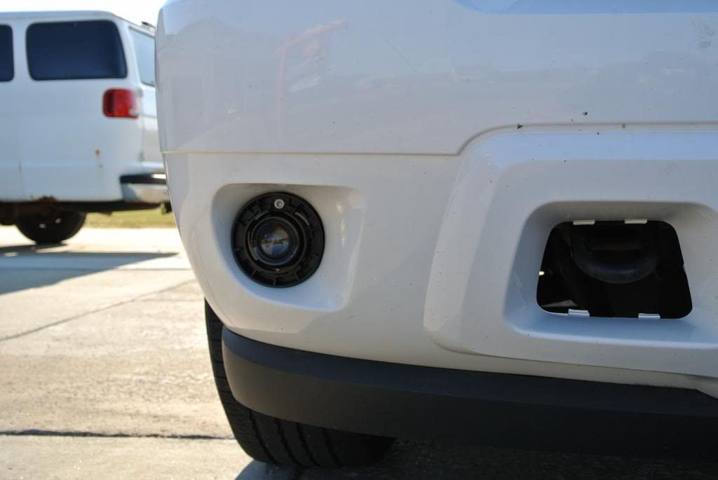

The round shape of the housing fits perfect in the round fog lamp area of the Tahoe. I was able to manuver the lights in the hosuing area and light them up pretty easily. The fogs are already water tight, and ready to go.
The part number for the fogs is 15162675. I just put the number in ebay and got a set for 52.50. They use the H11 bulb, which is what I was using prior. The look is different, but since im doing a black and white theme I like them. It appears the round black housing can come off from the light and could be painted to match any color. I plan on taking that white round plastic nut on top of the lamps off and painting them black.

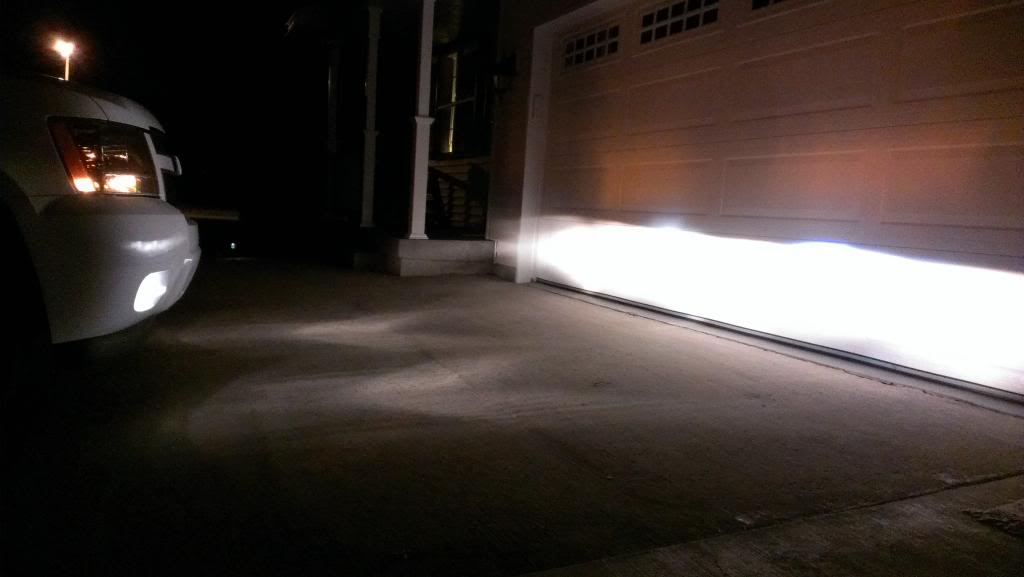

Do you have any output pictures?

Tried to get some tonight. I was playing with the up and down screw adjust, but got pulled away....dang children and their sleeping needs...Should have some in a day or so.

How was the cut off?

Im not a big HID Projector guy but for the price I think they work well. Better then what I had, which was nada when I bought the Tahoe..
Anywho...Cut off pictures as requested...
Now I am just letting the H11 bulb that came with the Fogs ride for now. I will change them when my DDE projector headlamp retro fit is done. I will change them to a nice 5k or 6k color.
