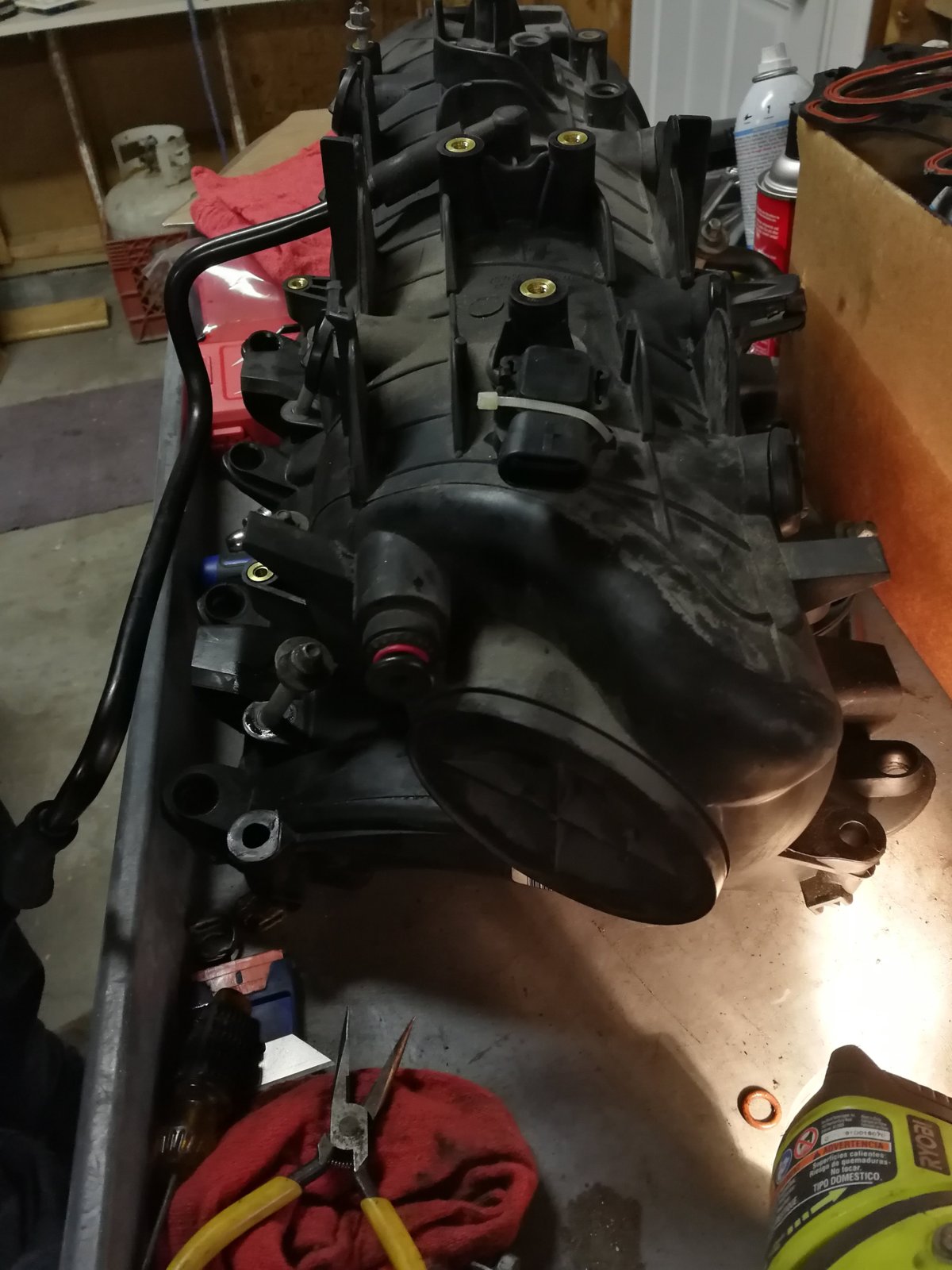

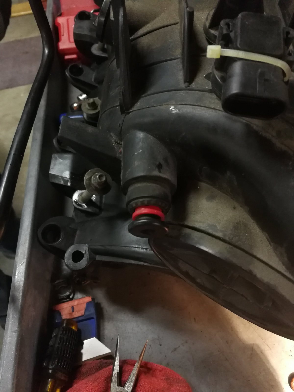

This cam is designed to work with the stock tune. Melling MTC-7. However, I am not totally convinced that to be the case. My biggest hunch is i have an air/vacuum leak in the intake manifold. this weekend, my neighbor is lending me his garage and we are going to do a few things. remove intake, check the gasket, decide to replace the new one which is of a style that 'grabs' the head bolts on the top of the head to align it. this is different than the stock ones, which are supposedly reusable and I wish i kept them. i ordered a new set of the old style, that snaps on the manifold. Then i will put it on carefully, doing my best to align and not 'jar' the gasket as I am placing it into position. This is kind of hard with that semi-rigid plastic tube that runs the length of the manifold and has to be wiggled through the fuel rail crossover. I am also going to clean the MAF. (i had had a few pending codes with the MAF, P0101). I am contemplating removing each injector and checking the screen is clear from debris. This seems to be overlooked by a few articles I have read, but I can do this when its back together, but will be easier to do while the intake is out. I am also going to put in some high strength fuel injector cleaner from GM that I have leftover from my wife's car. that will go straight into the fuel rail before I power the fuel pump on. I will let that sit for a while, then start the car without plug wires attached so the cleaner gets a few squirts into the nozzles, then let the car sit a while longer, reconnect plug wires and start. Hopefully at a minimum, I have fixed my air/vacuum leak and hopefully added some fuel throughput, or balanced them out enough to make the cylinders more equal. I have a gas smell at startup and during the warm up at idle. its not so noticeable once warmed up and idling.

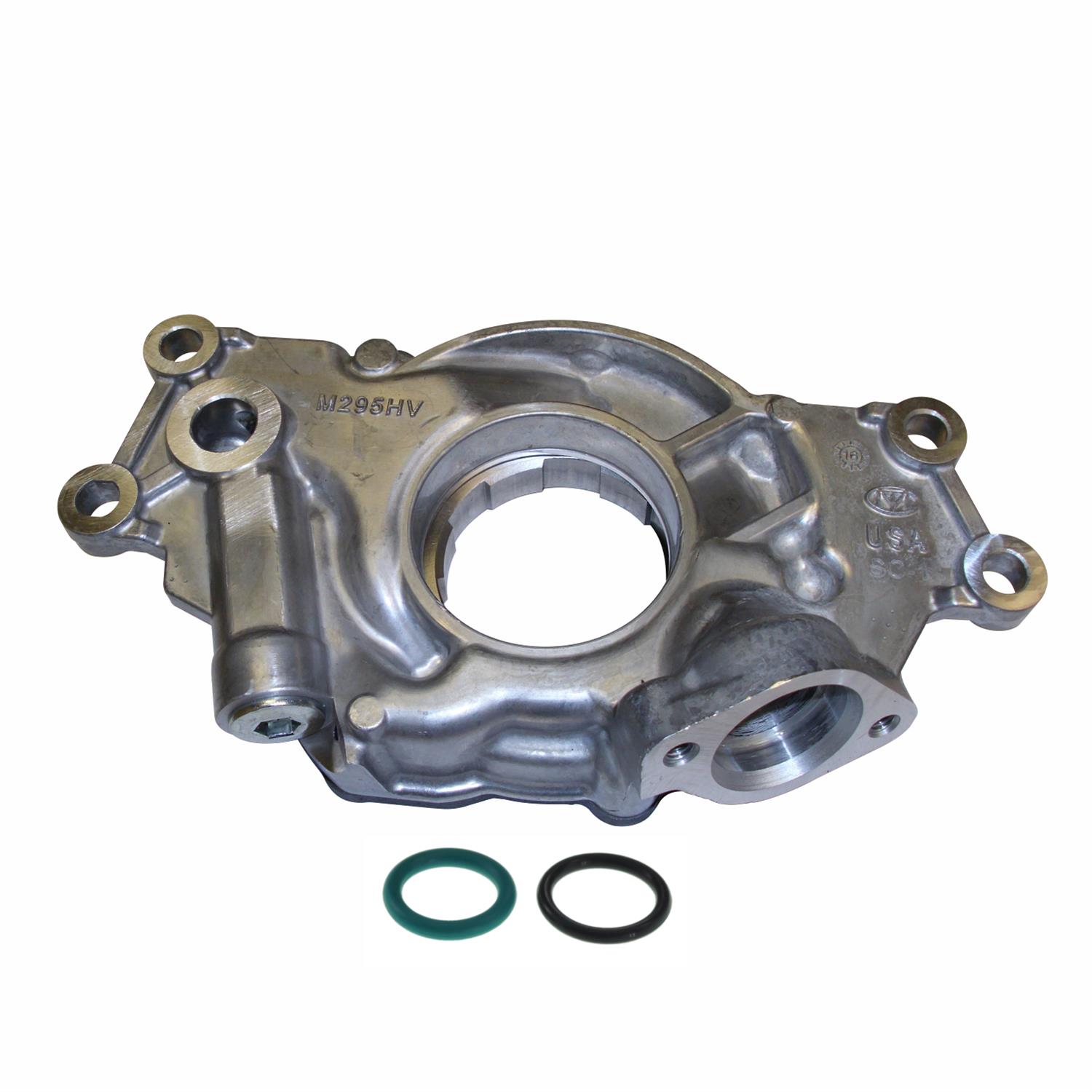

i do not have VLOM, this is not an AFM engine. I triple checked the pickup tube during its install. the first time i installed it, i saw it was crooked, so i loosened up the oil pump again, and removed the tube, then reconnected, this time being extra careful to get the tube in straight and fully. when the oil pump cover and gears are removed, you can see the pickup tube inside the pump and easy to determine if its inserted fully. that is my impression of this task, anyway.
There should have been 2 different O-rings for your oil pump and you need to make sure you use the correct one. Also, if you installed the pickup tube crooked the first time, you might have put a nick in the O-ring. This is a common problem when installing a new oil pump, especially if you don't remove the pan so you can install the tube easier.
Yeah, i am sure of the 0ring being the correct one. I received one set with the new oil pump and another with the gasket set, both said to use the Green one as i had the Red/Orange one on originally(if i am remembering it correctly). i tried to look at the ring when i had to pull it back out, from the parts of it i could see, mostly where it would have been pinched too, it looked fine. I also moved the bolt to the left/higher side by notching out the 'key' so i can flip that single bolt bracket around. I'm not ruling out that could be an issue with the oil pressure, I am finding it to be a slimmer chance at this point. I'd believe the cam bearing issue to be of greater liklyhood at this time. luckily, the weather is so cold, its not getting warm enough to get too thin. its staying up around 10psi when warmed up the last few days. I'm probably overreacting to this since i did use conventional oil, i need to change it in a few days to a week back to synthetic and probably go to 5w-40, that 40w should hold better once warm, its worth a shot at least.
