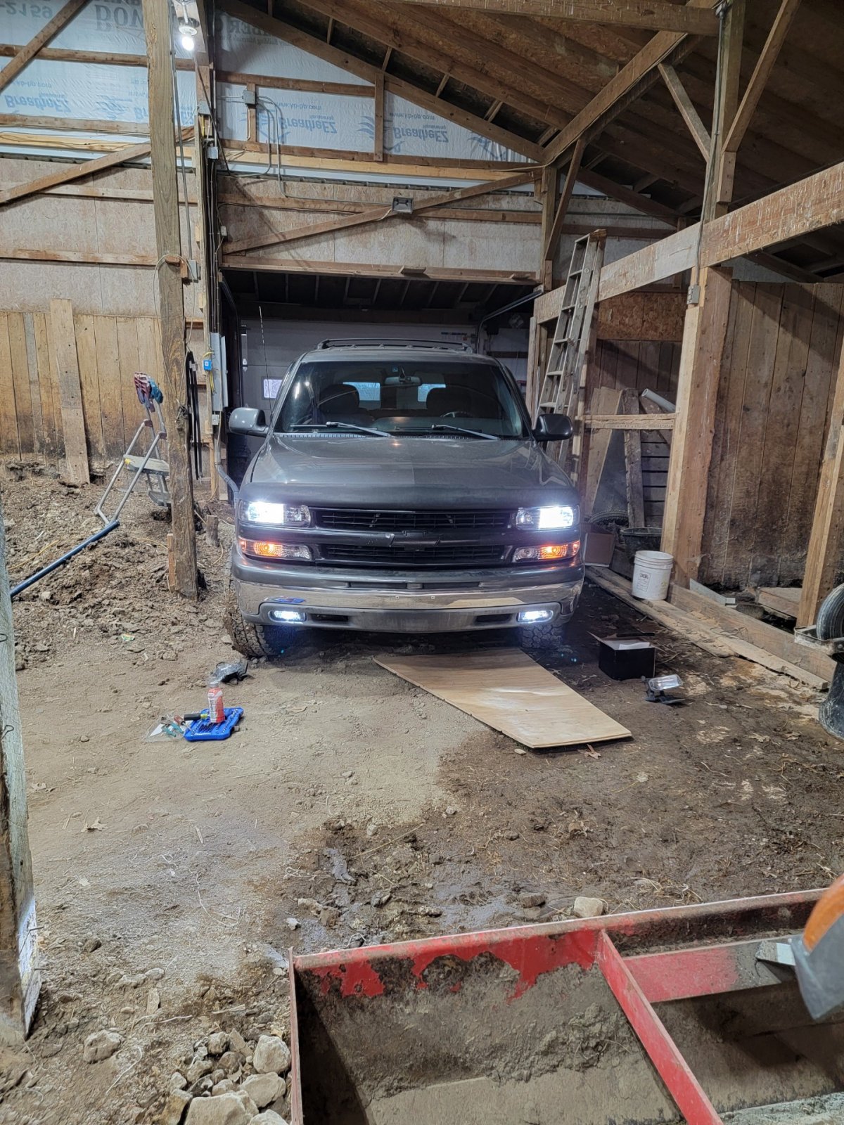

Hey yall just picked up my 2000 Tahoe Lt about 2 weeks ago...she has the auto leveling suspension which looks to be original from 280k miles ago ‍♂️ so im looking to throw maybe a 4" lift on it... looking for ideas on light bars for her...plan on to making her a nice weekend warrior just to hit some dirt roads with the kiddo cause she loves that kinda stuff...im from Youngstown ohio anyone near by? She needs some tlc but im already in love with her!

Looks great for 22 years and they are indeed fun to take off road! Had some good friends from Youngstown, Ohio a long time ago, nice people.

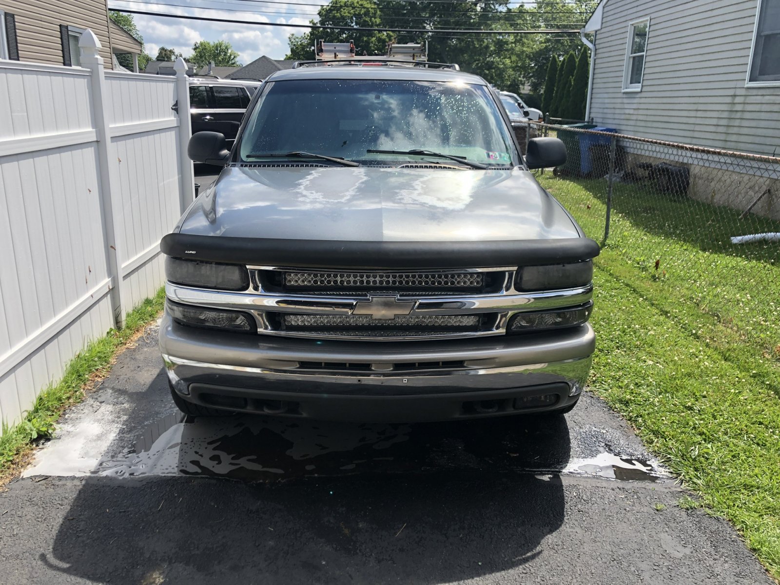

Nice truck. Paint looks good too. I mounted mine right in the grill

Welcome to the Forum from NH.
More pics of the truck, please.
Many folks on this Forum have lifted their trucks, and they will chime in.

Welcome from Miami Beach! Looks to be in excellent shape for 280K miles!
Check out the 2000-2006 section for any questions you might have. Thank you.

Thanks guys... im on a few groups on fb as well... gonna take my time and do this one all the way up im thinking, but it has a few minor things that I need to get right before I start modding away at her...

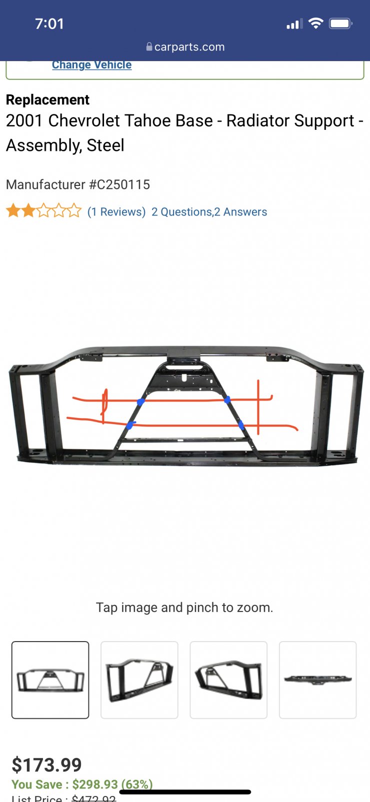

If I had more pics I’d share what I did. But here’s some crappy illustrations on my iPhone lol. When you pop your grill off you had the radiator support there with a triangular frame in the middle. I just made like a rectangle out of angle iron with holes. So 2 long pieces horizontally and 2 small pieces vertically to keep everything straight. Then I mounted them to the triangle part with nuts and bolts. You’re gonna be pretty close to the radiator. So short bolts and carefully drilling is key not to damage anything
Red lines are angle iron. Blue dots are where I drilled in to the radiator support to secure it B82EC4A7-4E55-42CD-B3A6-676EA05829CE.jpeg
