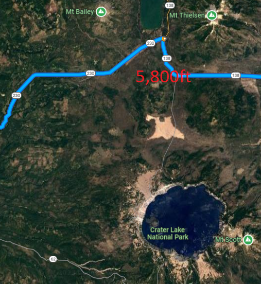

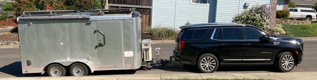

Thought I'd share our first experience towing our 5300lb 7 x 14 dual axle trailer -> camper on a 400 mile round trip over 5800ft mountain and back.

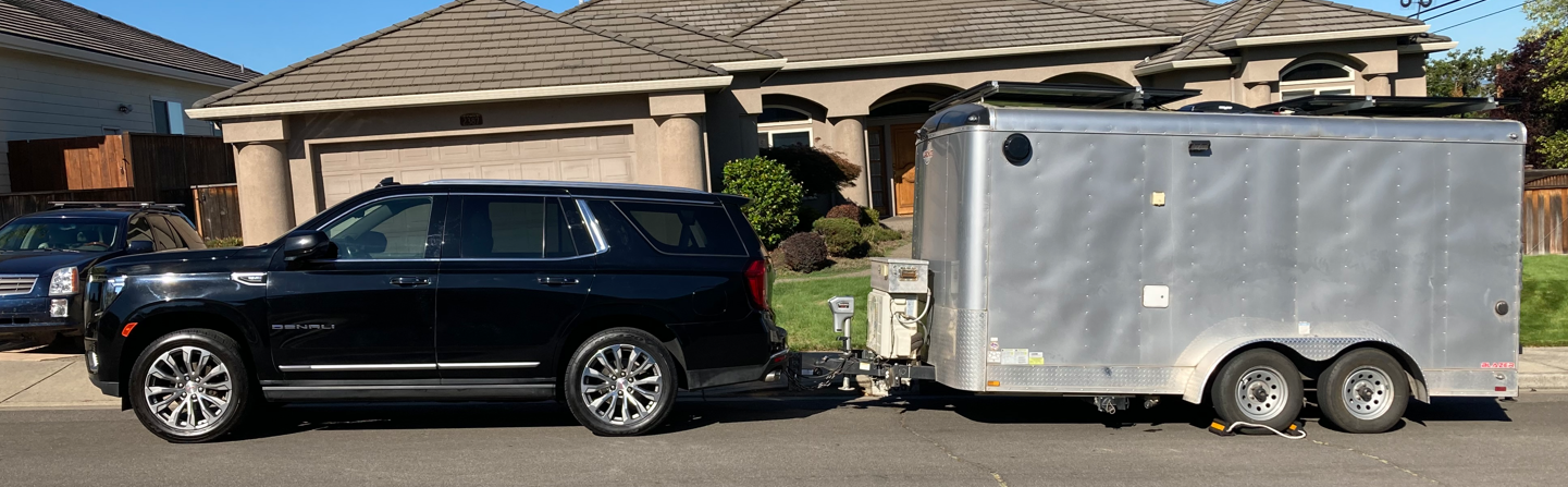

We have a 2021 GMC Yukon Denali 6.2L with middle package 22" wheels but no air suspension. Installed a Curt brake controller.
Starting with ordinary hitch. Tonque weight ~650lbs. Rear sunk from 33" to 32" (ground to top of wheel well) and you can see the front is 'up' a bit.
We got SWAY!!! at anything >57mph. It would drive normally but then for no reason start swaying - I could see the trailer swaying in the mirror - maybe 2" back / forth looking in mirror at front of trailer. I've towed about 4,000miles - some experience but not a lot. Even a little sway causes me to tighten on the steering wheel as it moves unnaturally - doesn't feel like I can correct and have to slow down immediately! Not a pleasant drive. Not sure if there's any safe amount of sway.

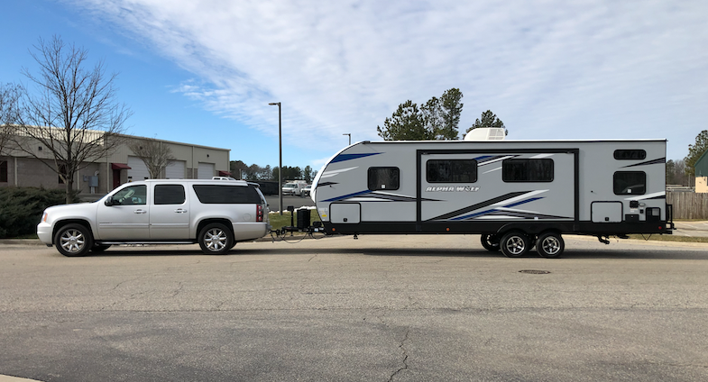

Heading back we put on the Blue Ox anti-sway, weight distribution hitch that we bought for our previous vehicle (2004 SRX V8 in pic above). The Yukon seems level (pic below) and had no sway up to 70mph cruising. The Curtis break controller worked well to give me good stopping capability.
Not pushing weight distribution / anti-sway, just sharing our hands-on experience. 5000lb trailer seemed like it might be light enough but turned out to be absolute game-changer for 65/70mph travel. Made a tense drive into a boring drive.

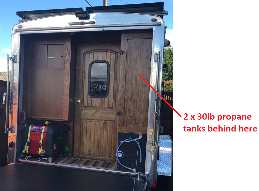

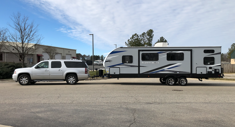

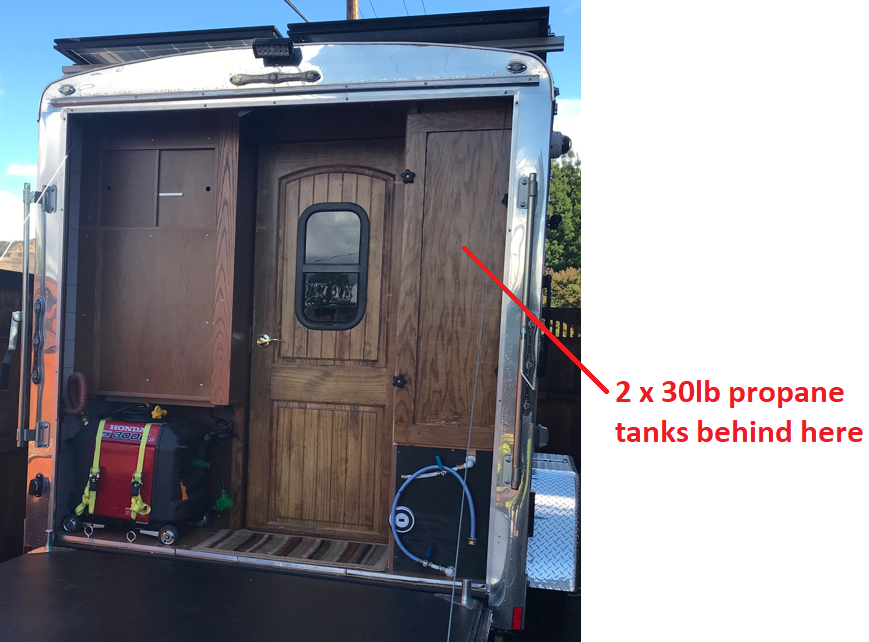

Don't understand what causes sway. This trailer is top heavy with solar panels and 7ft tall - maybe that contributes?
