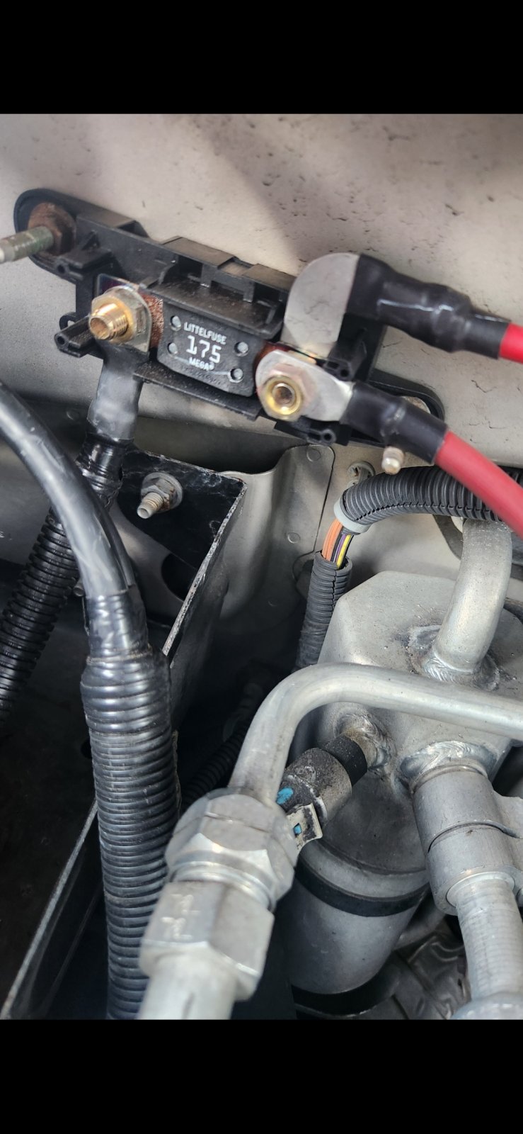

I hope that the pics of the Mega Fuse connections are the "before" pics.
Yes. I tried cleaning them but still flickering so replaced everything. That terminal comes with the GM replacement cable that runs to the fuse box. The new fuse looks rusted but it's not..the brass came that color from the factory. 1000004873.jpg
