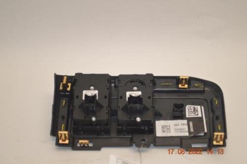

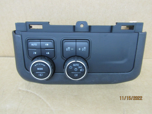

Do you think using a GMC Yukon switchboard would work if the fogs are wired to it? I am planning on doing the same install but wanted a factory like switch.
I don’t think so. That switch is only a momentary switch. It doesn’t lock on/off. Also, it is only pilot duty, it can’t carry a load. It is meant to send a signal to the BCM.
