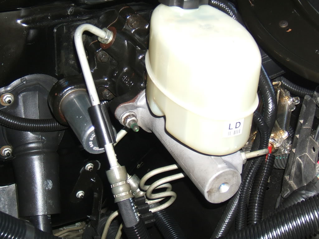

Have you had to add any brake fluid to the reservoir? (other than when you were bleeding the system)? The residue up at the firewall points to a bad master cylinder and so do some of your symptoms. At this point I dont believe its your hydroboost.

Yah k you rockola! I haven't had to add fluid yet but from my research I'm beginning to agree. I will change the master cylinder today but I am unclear how to properly bleed. I have searched and it gives me the bench bleed method so I can do that but wouldn't I introduce air past the master cylinder once I disconnect lines at MC? So can I just do the traditional pressure bleed at each wheel afterwards or is there something more?

Well shoot! Parts house didn't have one in stock. Guess I'll order one and get to it some time
