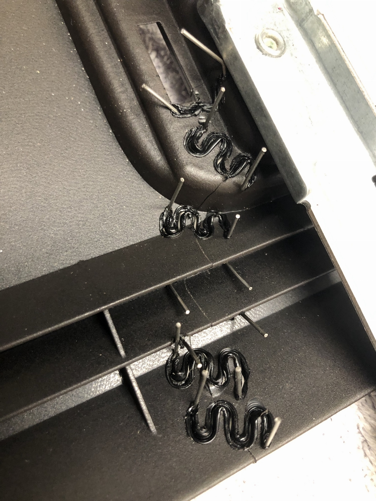

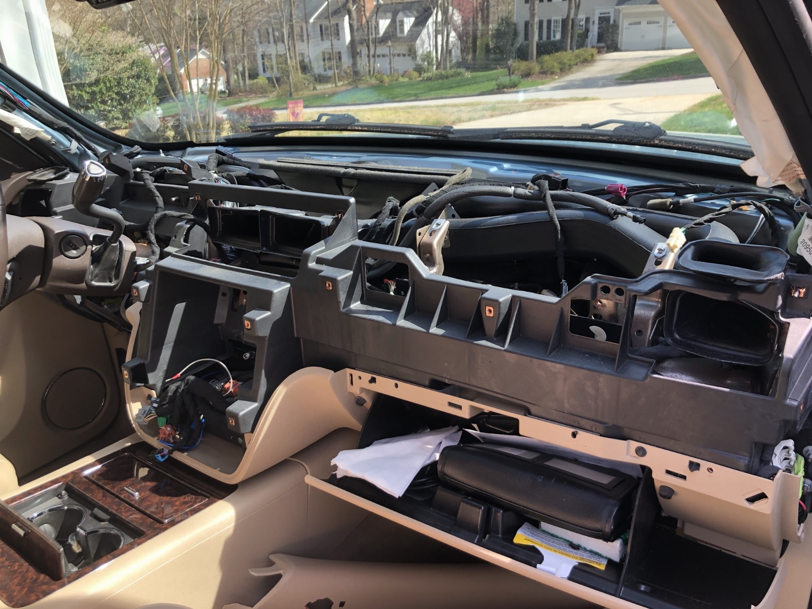

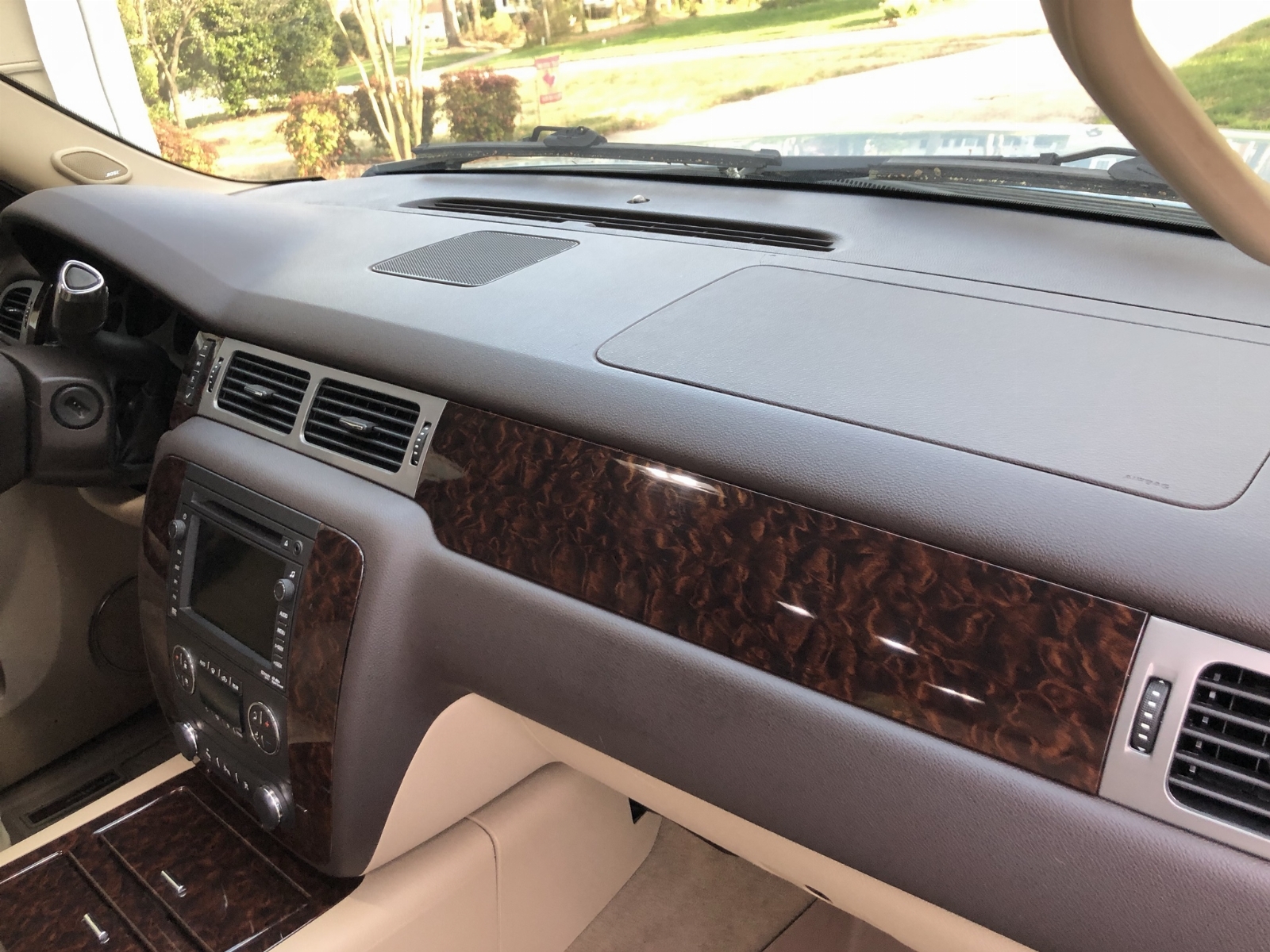

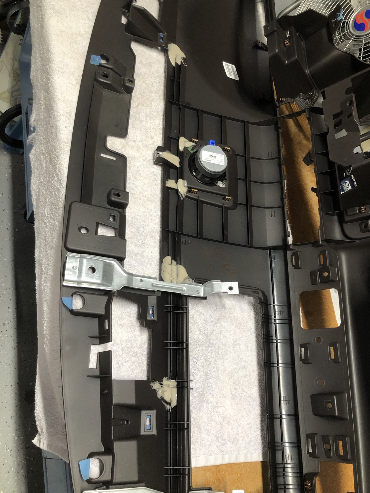

You can repair it yourself if you take your time. I posted the steps I went through to replace mine in another thread. The new dash, whether you order it online or at the dealer, will come in a pretty large box as they pack them pretty well. I can't imagine they can be repaired on the surface without cracking again. When I removed mine, the cracks traced all the way back to the mounting bolts on the instrument hump and near the airbag - makes me believe the entire issue began with over-torqued bolts. My new dash was identical in design to the old one, so it doesn't appear that any design changes were made.
---------- Post added at 07:24 PM ---------- Previous post was at 07:19 PM ----------
Read this thread for pics and basic instructions for dash replacement
http://www.tahoeyukonforum.com/forum/showthread.php?t=54372
