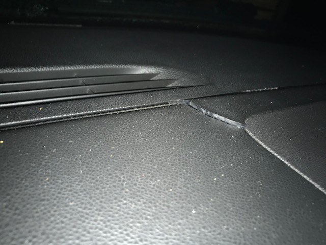

New member here. Hello Everyone. I have a High mileage 2009 Tahoe with 2 dash cracks one at left of pass airbag and one at base of cowl drivers side. Seems to be the most common spots. I saw an older post from a mattjones (2015 I think?) on using a permatex plastic weld product for dash cracks. I was really curious if it had been tried by others and what the long term results were? My Tahoe is almost 10 yrs old and with a lot of miles so I am sure the dealership would only laugh at the request of a replacement dash. I would like to make the crack stay together and not spread too much more. If anyone has tried the permatex and had success please post a reply. I pulled the permatex pic from mattjones post. I added a couple of pics of the existing cracks.

Personally I don’t see that working based on my experience. I used a plastic stapler that melts staples into it from the backside, topped off with epoxy similar to that as well as reinforcing steel rods. The cracks were still barely visible but I would have been ok with them. But a week later a new crack appeared. The plastic had just gotten brittle. I mean, you can always try it but keep in mind it’s a ***** to pull the dash out and put it back in. Check out this guys video on the repair but keep in mind he makes it look super easy. It’s not lol.

I would be infinitely pissed if I plastic stapled it all together only to have a new crack appear a short time later. I think I'm going to try one of those plastic dash caps... Has anyone actually tried one?

Hell yes I was pissed. And on my Silverado I had to drop the steering column to get the dash in and out. Plus the first time I removed the flat panel that goes between the windshield and dash, half the clips broke off as well as a whole corner of it. That part is another $250-300. I also tried to repair it. No way. It kept breaking. Brittle as hell. All told it cost me $600-700 plus days of work. I returned the plastic stapler otherwise that would have been another $100. It was my Silvy which is more of a show truck than a daily so I put new parts in, and the windshield is getting tinted to keep the UV to a minimum.

Great video I think that guy has done a few of these before. I have pulled the dash out of a grand cherokee once and said never again LOL. to the poeple that would want to do this, that video is invaluable. I think that I am going to try the glue wihtout pulling the dash. If I painters tape off the area maybe it will come out 1/2 way neat LOL it has to look better than the piece sticking up and out of alignment. That is what bothers me. Worst case if it really turns out bad THEN I will replace with a new dash piece but I doubt that it will EVER bother me that much (maybe)

Yeah, I tried the plastic weld Permatex stuff and it just cracked again along the same crack. I just said screw it and got a dash mat of Amazon. Not gonna pour money into a 10 going on 11 year old vehicle.
