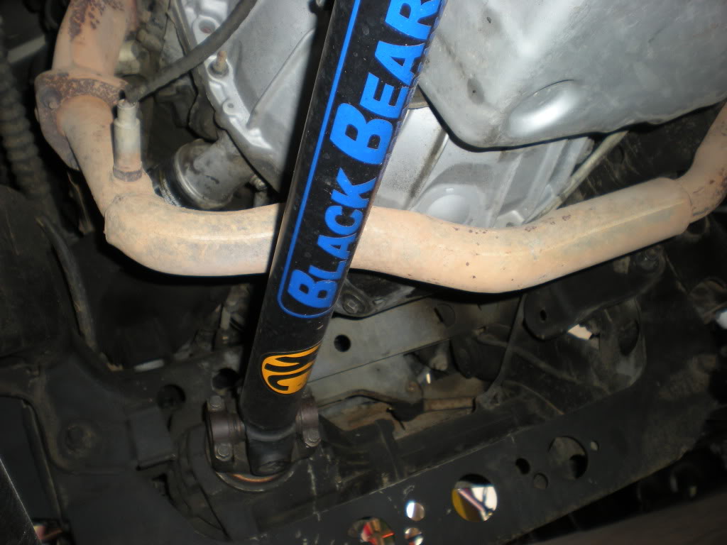

if you have never done gears or anything along those lines it would be a good idea to let the pro's do it as i wouldn't start with a front end like ours to learn on.
x2 on the exhaust being in the way, you having an auto-trac truck, and i would bet it wasn't regeared in the front. (would be stupid to regear the front and then just not spend a couple/few hundred on a driveshaft IMO)

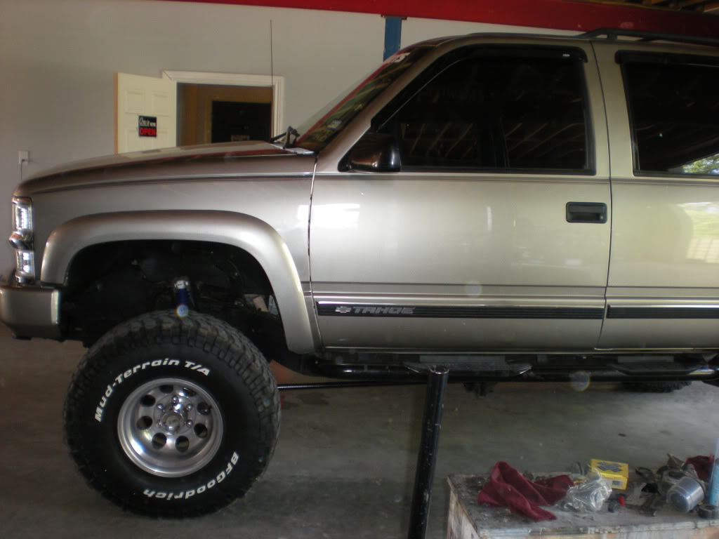

truck looks good BTW!

there was an auto trac thread in this section that had a link to the new shaft, OR you could just have a shop build you one. the length of the shaft isn't really the problem (i have the stock shaft in my 96 NON Autotrac) it is said to vibrate pretty bad over 35mph.
you could always lose the IFS for a straight front axle along with a 5 speed and a manual T-case :) would fix your auto trac problem but you'll still need a custom shaft
