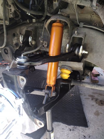

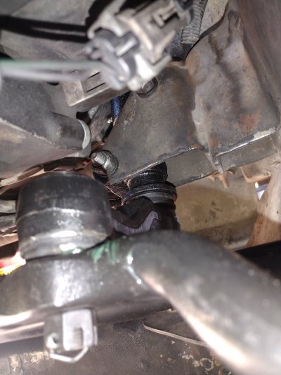

All done finally. That was definitely harder than I expected and I thought I had it close as far as installing new parts in the same orientation as previous ones but that was not so ... The drive to get alignment was def a stressful one but now all complete and I don't feel much of a difference as far as better, smoother ride. Maybe I ought to reinstall the previous shocks. I bought new Delco professional gas shocks which are beefier than the KYB Excel-G that were on there.... What y'all think?
