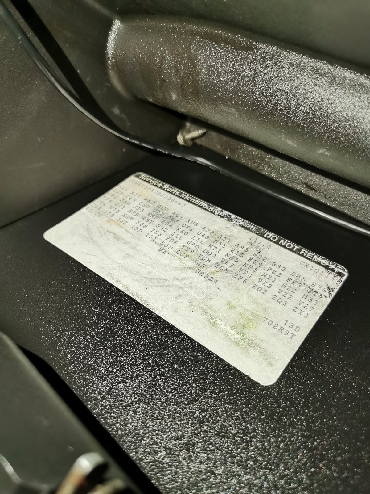

Just looked and my sticker says Gu6 and then G80 right after, How bad is the G80? Im clueless. I will be getting new tires 265/75/16, is 3:42 gearing going to be betteror worse for gas then another? sorry for all the questions, just trying to learn.

for those tires, your gears are fine. You will never see a difference. The G80 can be the start to a bad day....
Do you ofroad the truck or beat the piss out of it on the road? If yes, your days are numbered.
Typically I hear guys toasting them when spinning the tires then catching and BOOM.
I ran one for 8 years with no problem, ignorance was bliss and I had no idea what was in there. I swapped it when I regeared. But many run them for a long time. Others, kill one a year or more.

great info , always been told at the dealership mine was the 3.73 not according to my sticker says i have the 3.42 g80

3.42 is a very common ratio. It seems if the truck came with a towing package you will see 3.73 or even 4.10 though.

well thats just it i have the towing package truck came with a class 3 hitch and "heady duty trans something according to my RPO codes guess thats why I and the dealership always assumed it was a 3.73
Z82
VR4
KNP
are all codes i have but appearently i have the smaller ratio? kinda seems a bit odd to me
