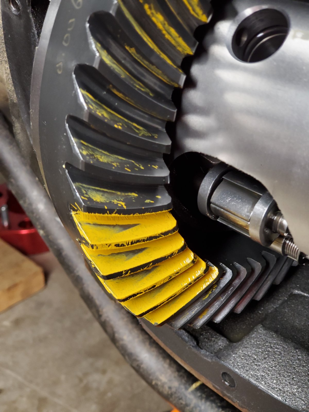

Alright, brought it back in. This is the patterns from just a few min ago. This is how it was while driving.
W
WFOALASKA
Mar 22, 2021
27
12
Alaska, Delta Junction
Drive is toe/middle. Coast is mid/heel. Picture is same no change, just after paint. Seem to show a bit better.
