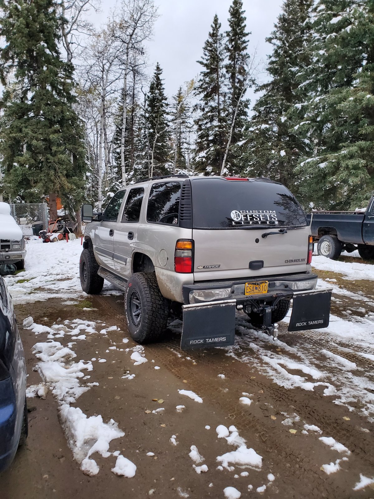

Alright, finaly got it. Watched a few of the school type videos on gear setups. Basically did a little schooling, so i knew exactly what to do. Before I was way off (backwards) on the mechanics of it. Brought it back in the garage, tore it all down and started over. Only took 3 tries on paint patterns for the correct pinion depth. Is .04 now (pinion depth deeper) insted of .07 ( too shallow ) backlash set at .08. Preloads are in speck now too. Buttoned rear diff up and pulled the front diff out and regeard it as well. Took it for a drive, no wine, growles. Totally silent. Really happy now. I rebuilt the 4l60e a few weeks ago, with all the sunnax goodies installed. Now with that rebuilt, the 4.56 gears, it rolls down the road in overdrive at 2,200 at 65-70 on the 35" Nitto Terra Grapplers with ease. Will be able to haul our camper, 4wheelers, loaded inclosed trailers around much better. We have steep grades on our roads here. Finally able to pull them much better. Front is gears are dead silent as well.. super happy. Next is the LM7 to rebuild and the transfercase.

I just caught it in one of the pictures, are you still using the govloc? That seems risky with a steep gear.
Yep, it does. Going to swap it out in few months. What would you guys recommend? Would like air lockers front and rear. Richmond or Yukon? Haven't started looking real hard yet. Low on toy cash now for a bit LoL. 6" lift, wheels and tires, transmission rebuild and gears were pretty spendy. Im able to do all the work, so that helps with being able to spend a little more on the parts. Next project is a Duramax/ Allison 6sp swap in my 86 chevy pickup. Have everything for it, just have to do it now.
