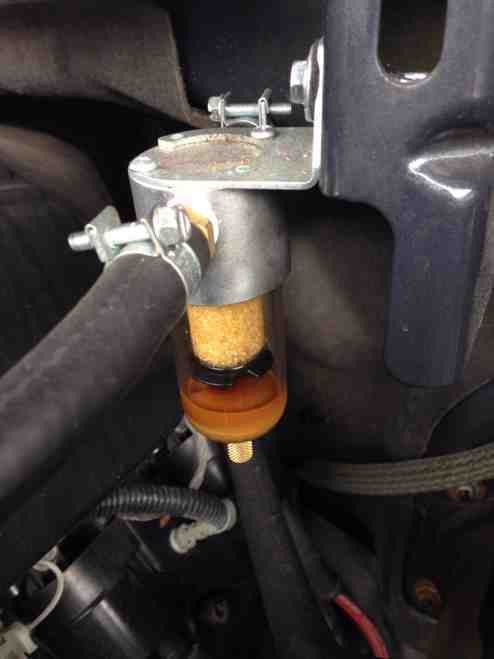

Anybody for something cheap that works pretty good?
The filter element substituted for the one inside is made of:
Cut round pieces as needed.
Unscrew the bowl to empty.
Lowe's or Home Depot can fix you up with the separator, 90 degree barbs, and hose clamps. 3/8" hose as needed from parts store. Cost about $35.

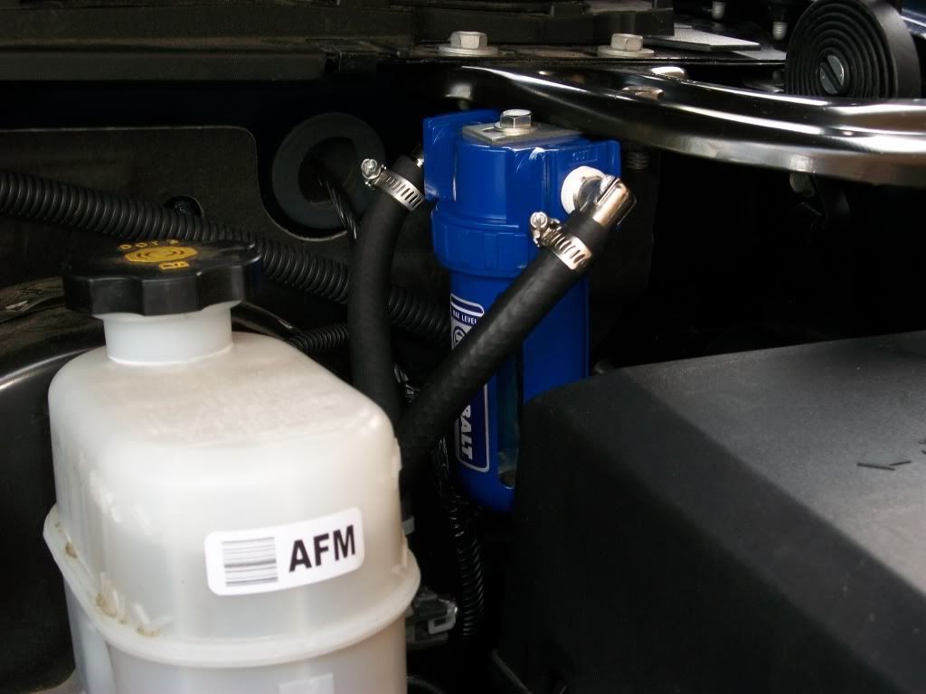

Just thought I'd add some pix of the set-up on my '13 Sierra with the hoses re-routed for more access to the drain and the windows to see the level of gunk collected. How many of those high-dollar cans have that?
Hose route to the engine:

Ok my bad BigBlueLB756 was right just pull up the engine cover and work it out, but I would not go as far as to just yanking it up.
My next question is I don't see any clamps of any sort just a larger hose over the smaller hose, how does the hose attach ?? Just slips on ??
It connects the same on top of the intake and at the back of the valve cover on the drivers side.

I would recommend clamps if possible. We have seen many a vacuum leak due to poorly installed catch cans. Three this weekend alone.
Yes that part I get, it's how does the factory dirty air/PCV hose disconnect it does not have any clamps. I just don't want to snap anything off trying to remove it.
Dirty air hose is what the dealer calls it.
