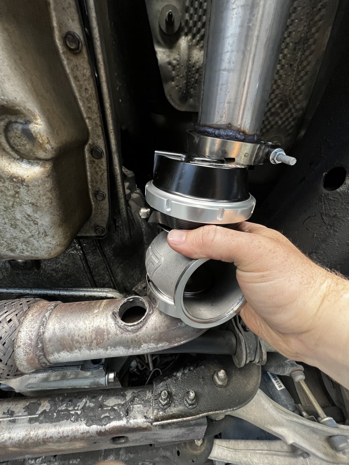

Time to tackle the wastegate, this ebay one was coming apart. We are now in April of 2023 and work has been a bear so the PPV got sidelined for a bit until I could address the wastegate and tune.
Dang she thicc! Got me a turbosmart powergate 60mm
chopped off the 38mm wastegate flange, hogged out the hole
Should be zero issues now dumping boost and holding spring pressure with this 60mm. Its nearly as big as the turbo!

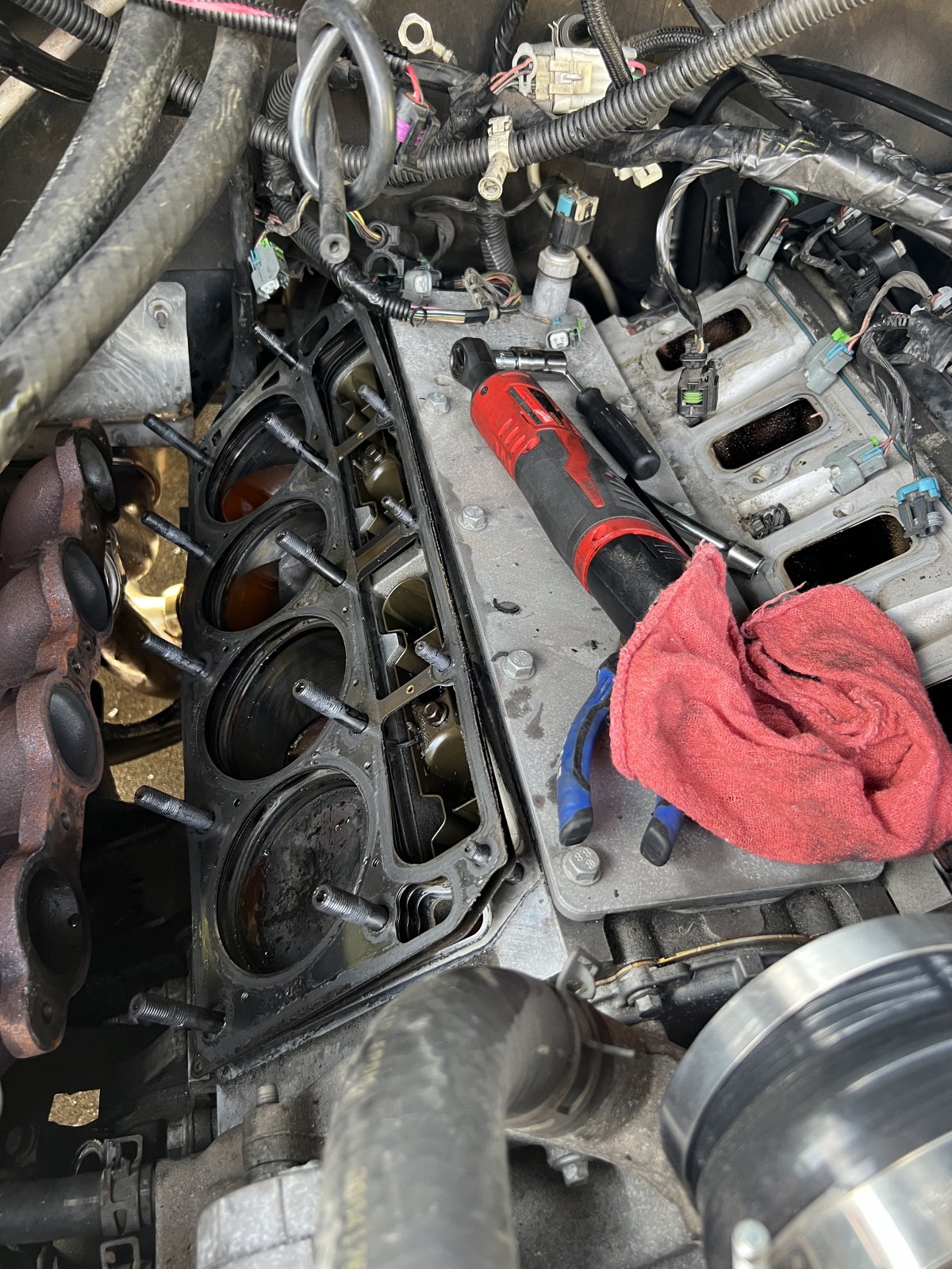

Its now July 2023, been driving it for a few months and partying with this little 62mm turbo. It's on spring pressure at about 6-7psi at this point and I am racking up miles as much as I can and saving up my pennies for a regear and trutrac. Unfortunately, I start hearing a tapping noise and dig in to investigate. I got these carnage pics to share, its a major heart break.

Yuppp thats valve contact on that underside of the exhaust valve there, rockers destroyed every single valve tip, there's metal EVERYWHERE!

I was left scratching my head here but had a good idea to reach out to BTR since the pushrods, rocks, springs, retainers are all BTR and maybe they can work through some root cause analysis with me.
What you are looking at is an email from Kyle@BTR telling me that THE Brian Tooley was able to identify that I had 1.8ratio LS7 rockers in these LS3 heads. The second picture is the LS7 rocker on the left sitting next to a stock LS3 rocker on the right. 1.8 ratio rockers no worky in 1.7 ratio heads. Notice the wear pattern on both. WOW!
Well, problem identified. I can fix this but I do not trust this block anymore. It's coming out and getting sent to the machine shop for some work and a rebuild.

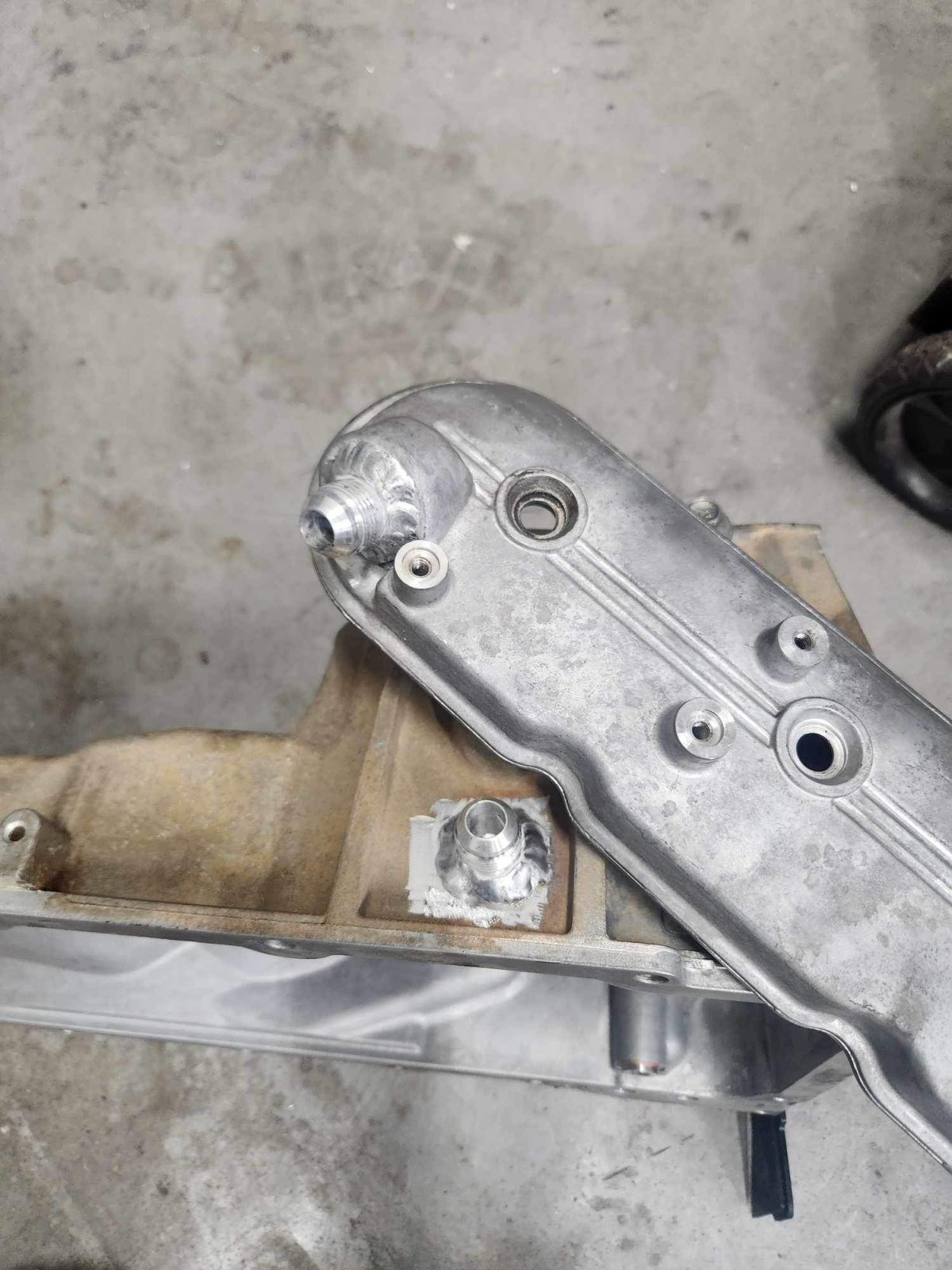

Some choice upgrades while its apart. -10AN turbo oil drain bung off the oil pan and another -10AN bunch for the driver side PCV connection.

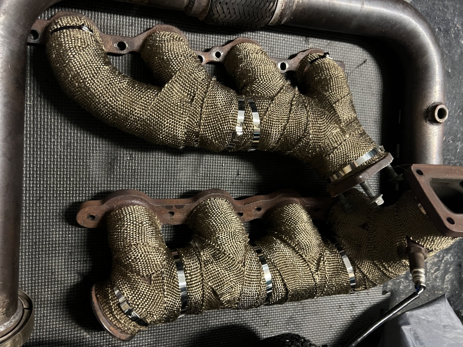

I have already popped an AC line from being too close to the turbo hotside and extended that line away. I also extended the heater core lines and relocated the passenger side battery ground from the front to the rear of the passenger cylinder head. I was in heat management mode, this stuff sucks to work with and I probably should have wet the fiberglass but under hood temps are down and I haven't had any more issues with lines around the turbo T4 flange. Next time I'd look at cerakote or some high temp paint perhaps.

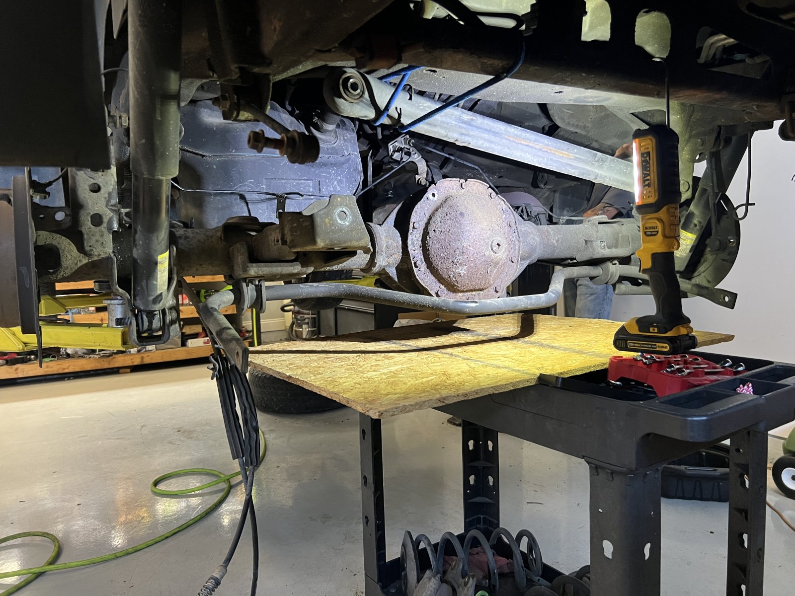

Its now December 2023, the PPV has some miles and is out of break-in. I stumble across this thread: 9.5SF Swap and source a $120 denali rear end. I decide to rebuild it with all new races, bearings, seals, brake hardware, rotors, pads, everything but new suspension bushings and in she goes. I get as far as setting backlash and first time around installed the crush sleeve backwards, I phoned a friend that is big into offroad stuff and he knows a few things about setting up an axle. Once he discovered my backwards crush sleeve, everything went back together smoothly.

Big upgrade going from an open diff/1310 yoked/8.5"/3.08 gearing to g80 locker/1350 yoked/9.5"/3.42 gearing rear end. I think some of the other people in this thread will be pleased I finally did a re-gear, and frankly so am I. It helped tremendously with drivability, converter flashing, gave me some traction control and I don't need to worry about breaking this heavy duty 9.5" semi-float axle adding any more power. A++ would do this mod again!

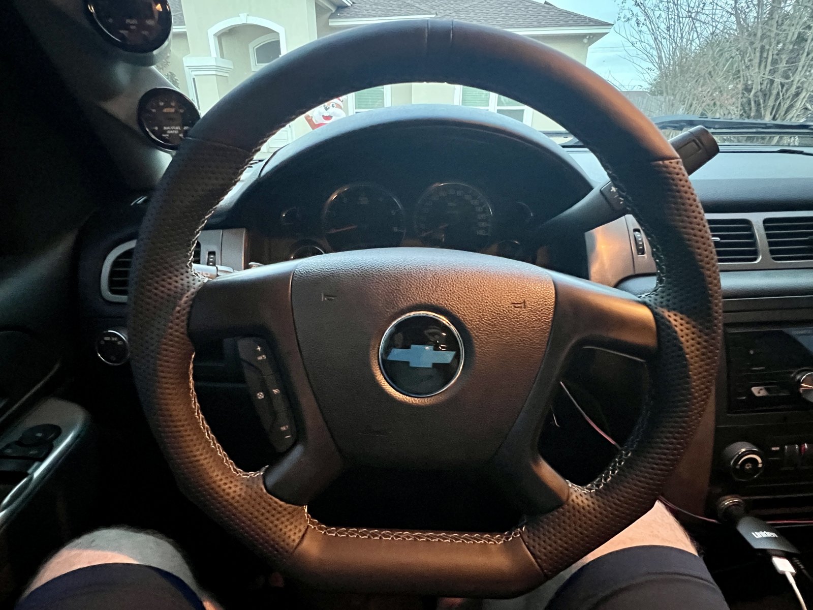

Last mod to finish out December right before the new year I upgraded some cosmetics. Steering wheel was coming apart at the top and trim top layer was peeling off. Lets fix that with a new steering wheel and emblem.
This was also pretty inexpensive compared to other vehicles I have that I have shopped steering wheels for. Normally something like this id expect to be in the $700+ price range. This was $250 from a seller called Revesol-USA on ebay, they even have a carbon fiber option now!
