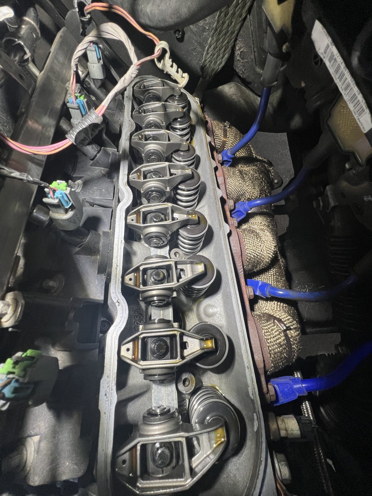

I also take a quick peak under the valve covers and make sure things aren't going sideways on me again. She's mint bud!

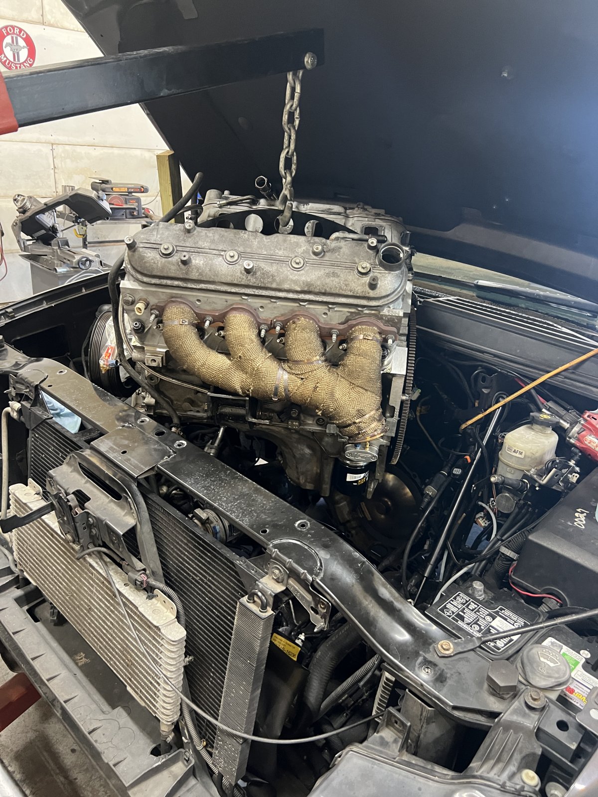

Out she comes, yea PHQ is right lol.

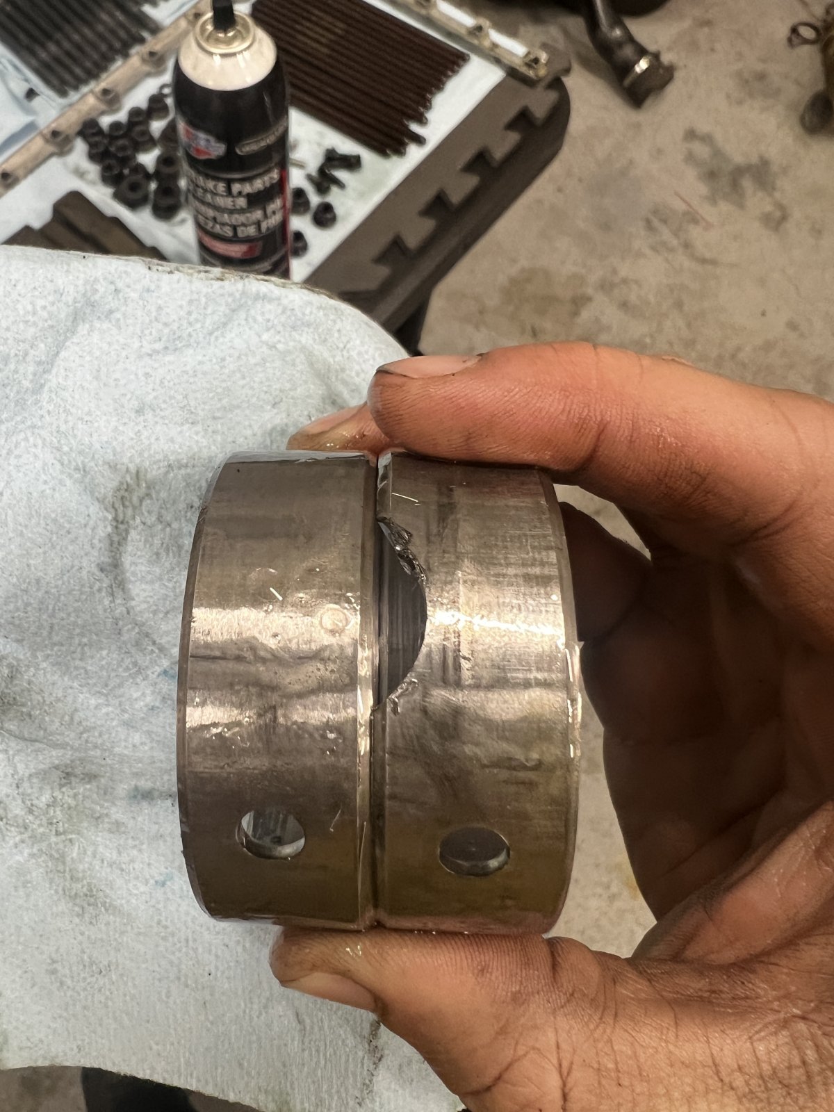

Camshaft bearing #4 has left the chat...
I also mic'd out the oil clearance on the other bearings and they are all above the service limit of .005" and consensus is you really want something in the neighborhood of .002-.003 on new cam bearings. A little self-clearancing by the lifter on that #4 bearing.
I am not going to lie, I am pretty disheartened at this point. I consult with the machine shop on wtf has happened here but at 8000miles there is no warranty. If you have been following along, you will remember that the only thing I reused was the camshaft and while its journals were the proper size I didn't trust it any more. Also found that the rear oil galley barbel slid aft and an O-ring on it had failed. A momentary drop in pressure when this happened I suspect caused the mayhem. This oil pump was fighting for its life to save this motor, that camshaft bearing sliding aft but staying partially in place allowed oil to keep things lubricated enough to prevent a bigger disaster. Cylinder bores, lifter bores, all bearing surfaces otherwise have zero damage. I'm not excited to spend two Christmas seasons rebuilding this turd, its certainly not my preference. But the story doesn't end here...we must keep going!

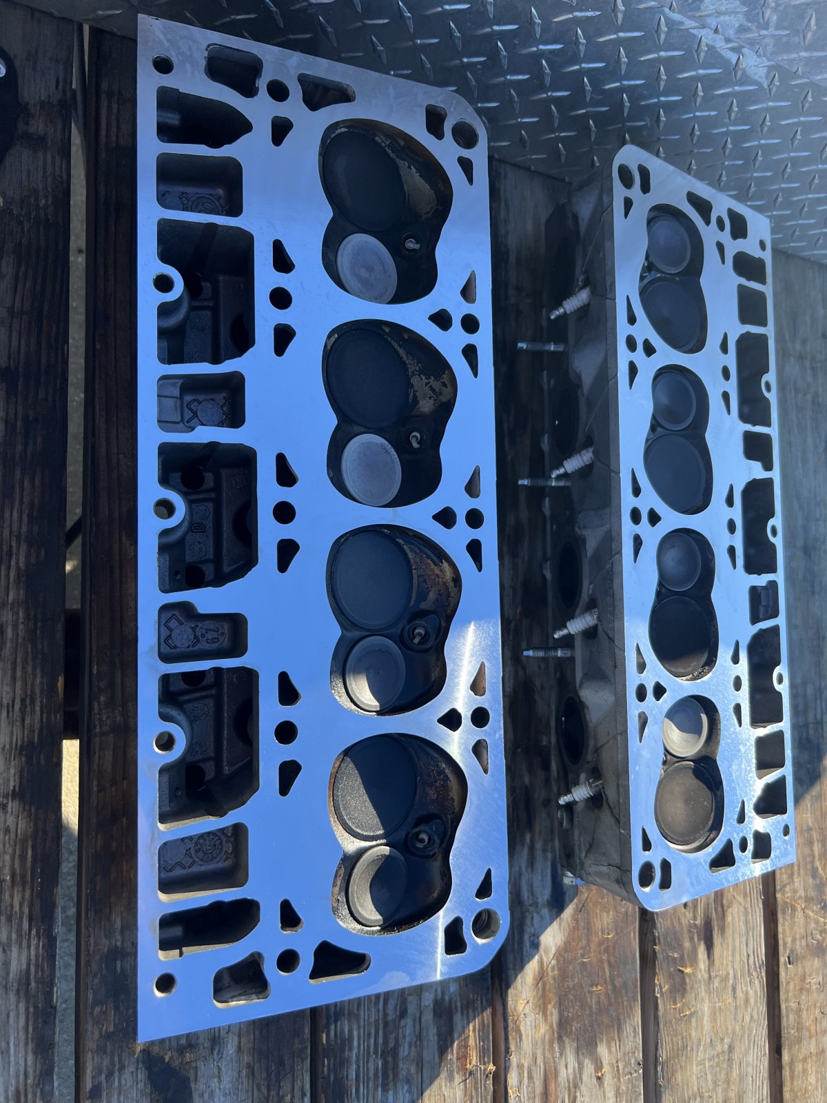

Going through the heads, all valves seal up. No repeats of last year's fiasco.

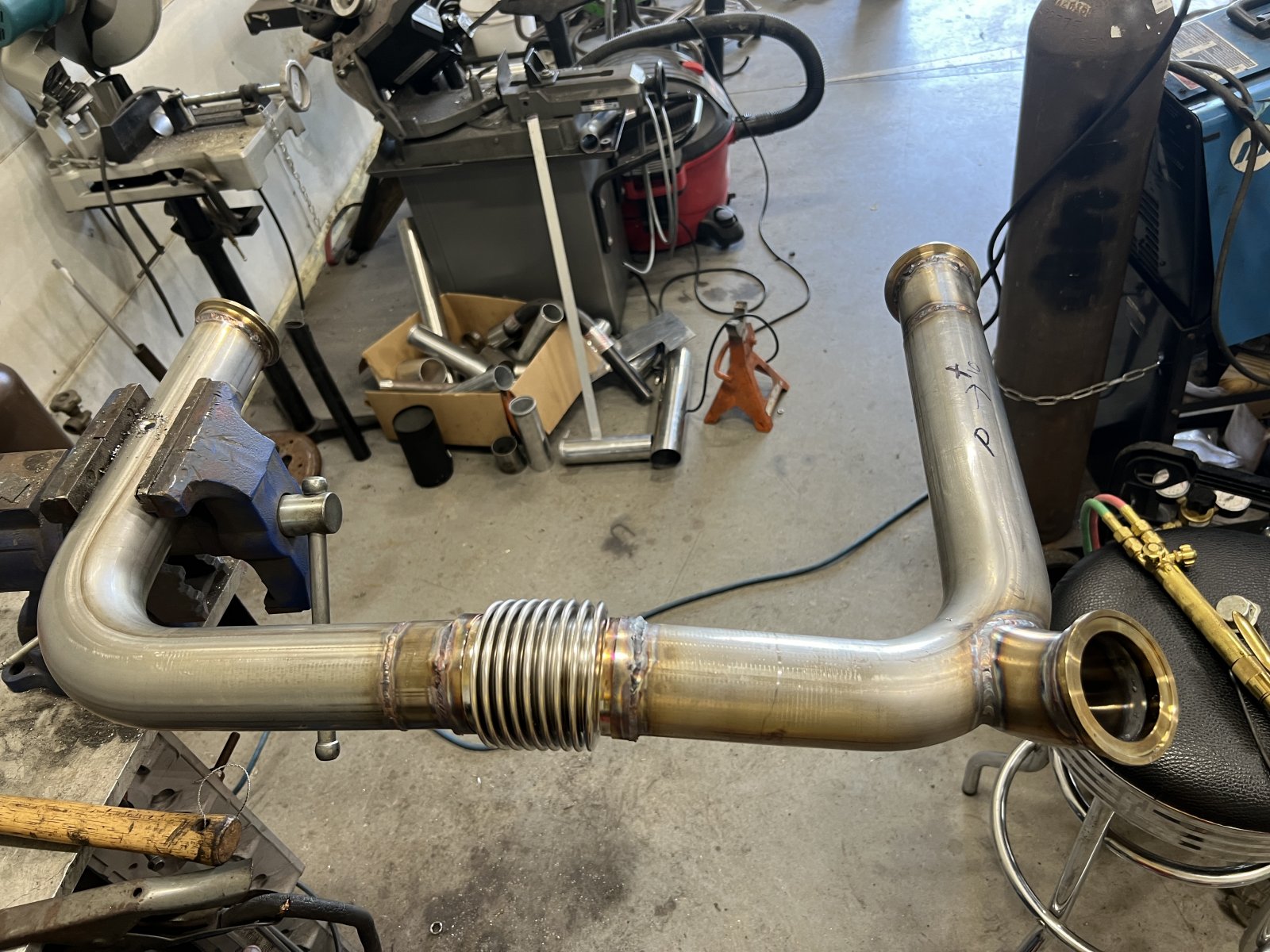

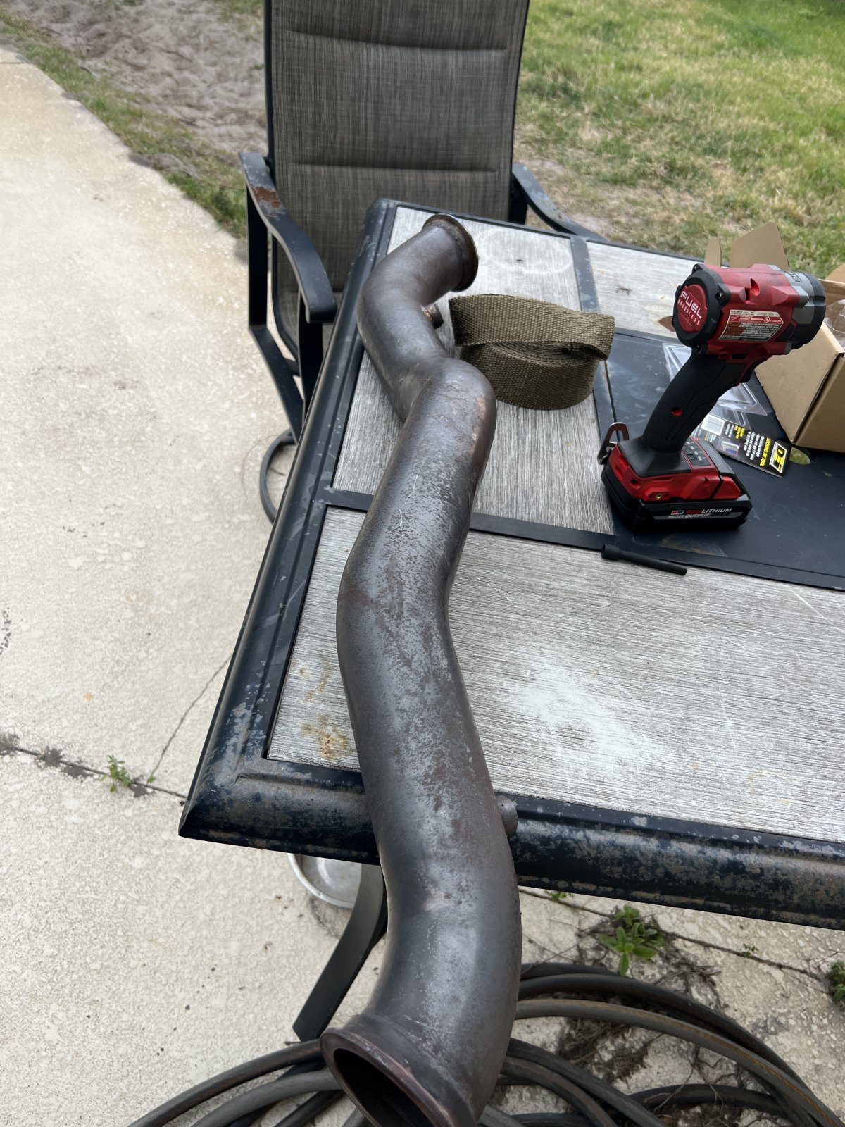

I am a big fan of "while you are in there" mods. If you look at my earlier post installing the turbo kit, you will see that the driver manifold is a stock truck manifold with the 3 stud flange. Lets v-band the whole exhaust, fix the crappy flex section in the cross over and make things a bit more blue.
V band welded to end of driver manifold
Screw it, new cross over build. Fancy double walled accordion style flex piece from vibrant performance.
My boy being a major help getting this fitted and welded up!
Beautiful new crossover, fits better than the one that came out and shouldn't leak from the new driver side v-band or flex section ever again.

Time to drop it back in, I am so ready to put this thing back on the road and boil some more tires!
Dropped it in with other valve covers, didnt want to damage these freshly painted ones. Once it was in and bolted up to the bellhousing, I swapped them out.

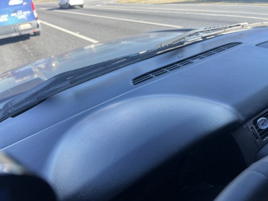

Christmas came and my wife...I mean Santa brought me some goodies. New Dashskin dash cover and headlights landed. She's seen the headache I've been through and also drives this car from time to time and wanted to get me a little something.

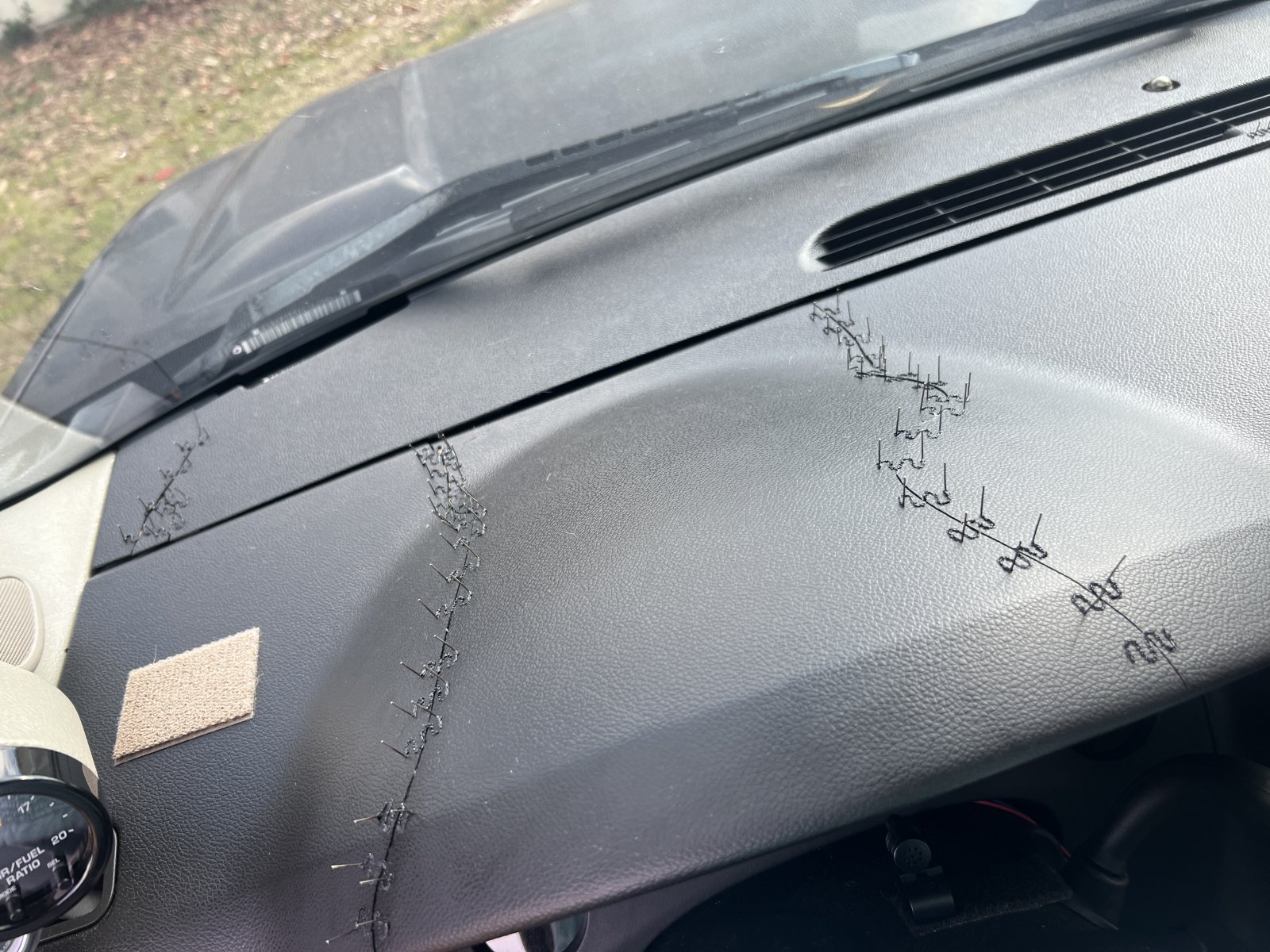

Like every GMT900 vehicle, the dash cracks. Luckily I had all the pieces still and plastic welded everything up to reinforce it the best I could before putting the topper on.
Installed and silicone setting up, I put about 20 books and tension rods on this thing to hold it down for 24 hours. The smell lingered around for about a week.
All cleaned up and out on the road, this turned out very nice. No more rattling!

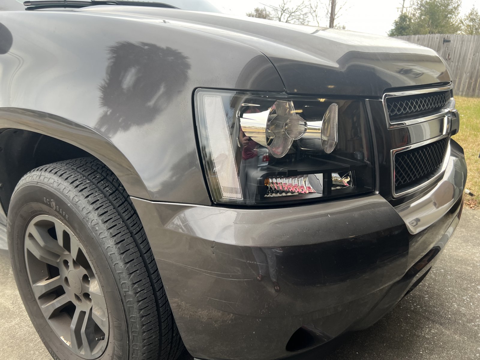

Headlights are clapped out with some LED bulbs that blind everyone and the plastic is cloudy. These new units came from an amazon seller Auto Dynasty for $105, I opted for the OEM style halogens with clear reflectors, clear lenses and black housings. Also tossed the LED bulbs out and installed some Sylvania silverstar ultras.
Before:
After:
At some point I replaced the missing front lip on this thing too, that was less than $40 delivered to my door and installed in 5 minutes. This PPV headed into 2025 with a newly rebuilt motor, new cam, new crossover, new headlights, new front lip and new dashboard topper. I get it retuned and work through break-in and tune revisions with the remote tuner again. This thing is getting dialed in and looking better and better. I snapped a picture during the snowday we caught here recently and it was looking good that day.
