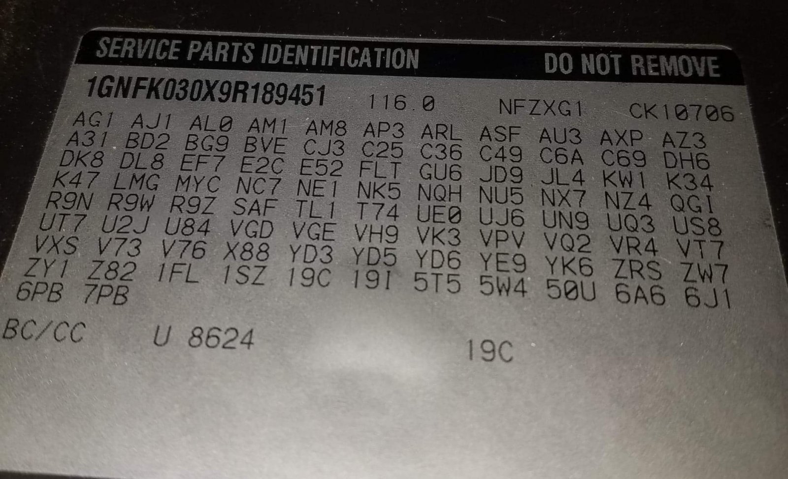

Ok, so I've been trying to figure out what options I have to replace my rear shocks on my 09 Chevy Tahoe SSV 4x4 LS. So I am attaching my RPO codes from inside my glove box. Could someone please tell me what I have and what I am able to replace with. Thanks in advance
Using your VIN and options I came up with 540-433/25871225. If you want a more off-roady shock, use 540-300/25871229.
