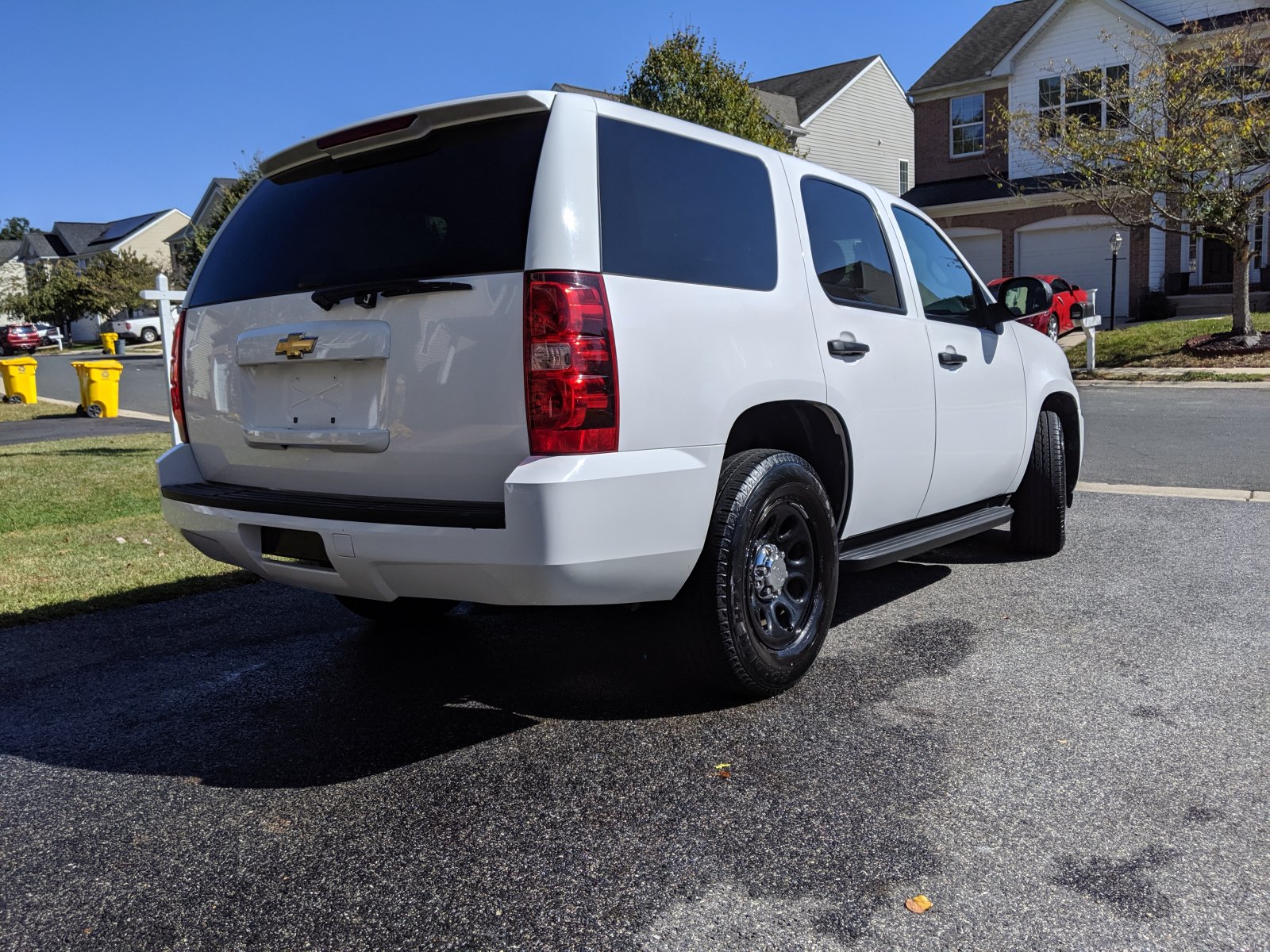

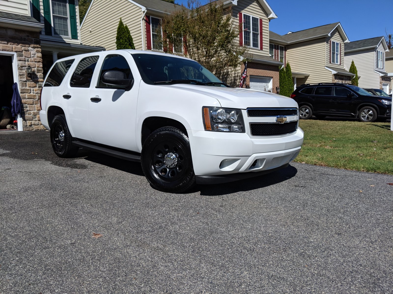

Well I have been reading and commenting up in here in anticipation of picking my PPV and I'm it now!
I flew out of BWI (Baltimore) at 0500 on Friday, left the dealer by noon and drive back to Baltimore area from Chicago......what a fun drive that was; got home at 2300. Ok, enough BS here is whats I have and know as of right now.
2010 Tahoe PPV - 69k, it was a GSA federal purchase (fleet/bulk order), it was in service some place in SC, and I have identified that it was a K9 Unit (the rear glass had decals), came with key less entry active and one remote.
Was not equipped with: A- pillar lights, headlight/taillight flashers, rear window/locks are active, no push bumper or bull bar installed, no LED/strobes installed into the headlights, taillights, foglight openings or on the running boards. No over head console or add on dome light.
- Appears that it was not original equipped with a rear seat or door panels (can see where flat panels were install on the rear doors). I have seen this in other K9 Unit trucks here.
- All of the emergency lights were on the inside of the truck - top of windshield, rear windows and rear hatch based on all of the holes drilled into the interior plastics.
- Only one hole in the roof for single antenna(the base is still attached)
When I took delivery - complete rubber floor covering, vinyl rear seats were installed, OEM rear door panels were installed, top of the dash is cracked (F$%K, they failed to disclose that), on the trip home I discovered the front rotors are warped and the front sway bar endlinks need to be replaced.
Surprises under the hood - new motor mounts, new revised GM valve covers, new battery, all the fluids looked good (minus the DOT3, needs to be flushed), not a single leak on the motor.
I'll get some pictures up when I get home.......GOVT computers don't like you up/downloading pictures
Cheers!

Project name "Undercover Sleeper"
What I have done, so far (as of 3 JAN 2020)
- Ported LS7 Throttle body (bought a new one and ported it before I had the truck LOL)
- Ported OEM intake manifold w/intake manifold gaskets & injector O-Rings
- AiRaid MIT intake tube /
AEM dry filter
- Airbox mod (opened up inner fender and matched the Airbox)
- Hypertech Max 2.0 - tuned for E85/AFM off/trans tune
- Denso IR plugs / Taylor 10.4mm plug wires
- Gates HD Green belt, ac belt, idler pulley, auto tensioner
- Holley powder coated valve covers (Tall) / new braided hoses & inline PCV
- UDR Catch can (black with black braided lines)
- Magnaflow muffler 12259
- Rear resonator delete
- Cleaned the MAF
- Royal Purple HMX oil change
- Royal Purple 75w90 Diff service
- Replace both Trans cooler lines (AC Delco)
- AC Delco PPV front rotors
- EBC YellowStuff front pads
- Rear pads
- XTRONs HU with backup camera & forward facing camera & GPS
- OEM DIC install
- OEM Tow/Haul shifter
- OEM Steering wheel Stereo controls
- Husky mats - front/back/cargo
- New headlight housings w/ LED HI & Lows
- OEM foglights added - OEM switch/lights and wired
- LED light bar, LED tag bulbs, LED brake lights, LED Dome lights (red)
- Spohn adjustable Panhard bar
- AC Delco Professional front sway bar end links
- New tires (Goodyear Eagle Ultra Grip GW-3 - 265/60R17) - AMAZING in the rain
- Airhorn install 150+DB
- Dropped the spare tire out, deleted the spare hoist/holder, removed OEM bottle jack and tool kit, removed the spare battery tray, removed about 5 lbs of spare antenna cable from the rear of the truck, removed excess brackets and cabling from under dash
Next up -
* NORCAL | BellTech 2-4 drop kit (ON HAND)
* OEM PPV shocks/struts & all hardware (ON HAND)
* 60k trans service (fluid/filter) (ON HAND)
* Texas Speed Long tube headers 1 3/4 (ON HAND)
* Texas Speed Y Pipe (ON HAND)
* ATI Harmonic Balancer (ON HAND)
- Auto Dimming rearview mirror (OEM) Ordered 4JAN20
- OEM remote start add on kit for RPO AP8 Ordered 4JAN20
Soon'ish
* Flush the DOT3
* Gear swap with locker (Yukon Gear & Axle - Ring/pinion and Truetrac limited slip
* Replace the driver side seat cushion and cover (top/bottom)
* Leather steering wheel
* Yella Terra Rocker Arms (1.8 ratio)
* Dyno Tune
In the Spring
* AFM delete (w/ LS7 lifters, LS9 head gaskets, C5R timing chain set, Melling oil pump) Req's dyno tuning
* Texas Speed cam (unsure on which grind) or LS9 cam - Req's dyno tuning
* LSA Supercharger (
in the garage, need finish Porting/rebuild) - Req's dyno tuning
* Meth injection
* Big brake kit ( I will probably do another Wilwood set up, custom build like I did for my Colorado)
