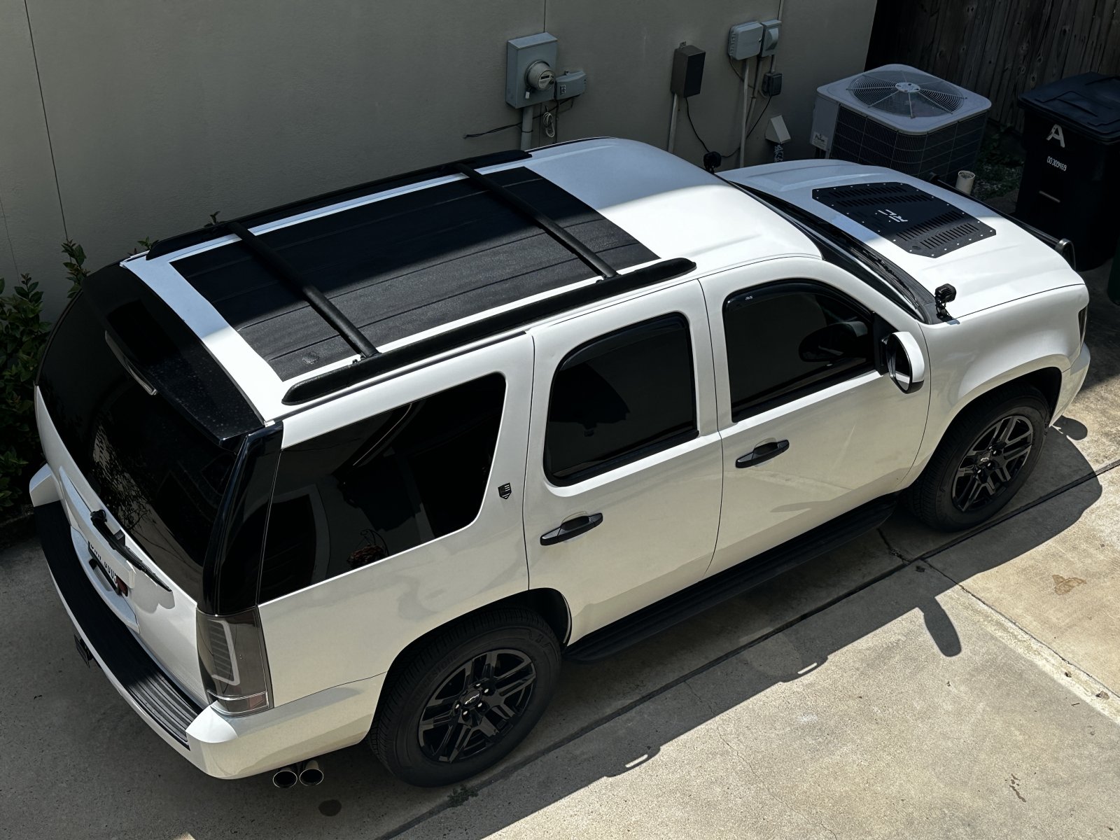

Nice! That’s exactly how I did it, even down to the tool from Harbor Freight. Here’s how my came out:
