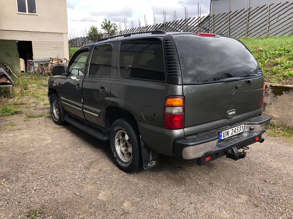

Some pictures from when i bought it in August aswell
View attachment 275161 View attachment 275160
