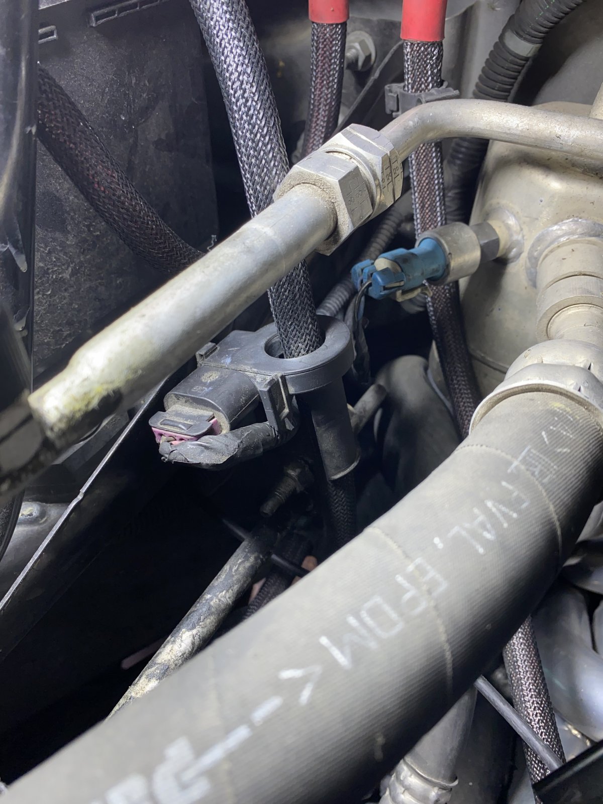

When I did my Big 3 (actually 4), I left all the factory grounds in place and just added the 1/0 to it. This meant my 1/0 was bypassing the RVC sensor. I fixed that today and upgraded it to a Big 5.
Factory grounds going through the RVC sensor:
