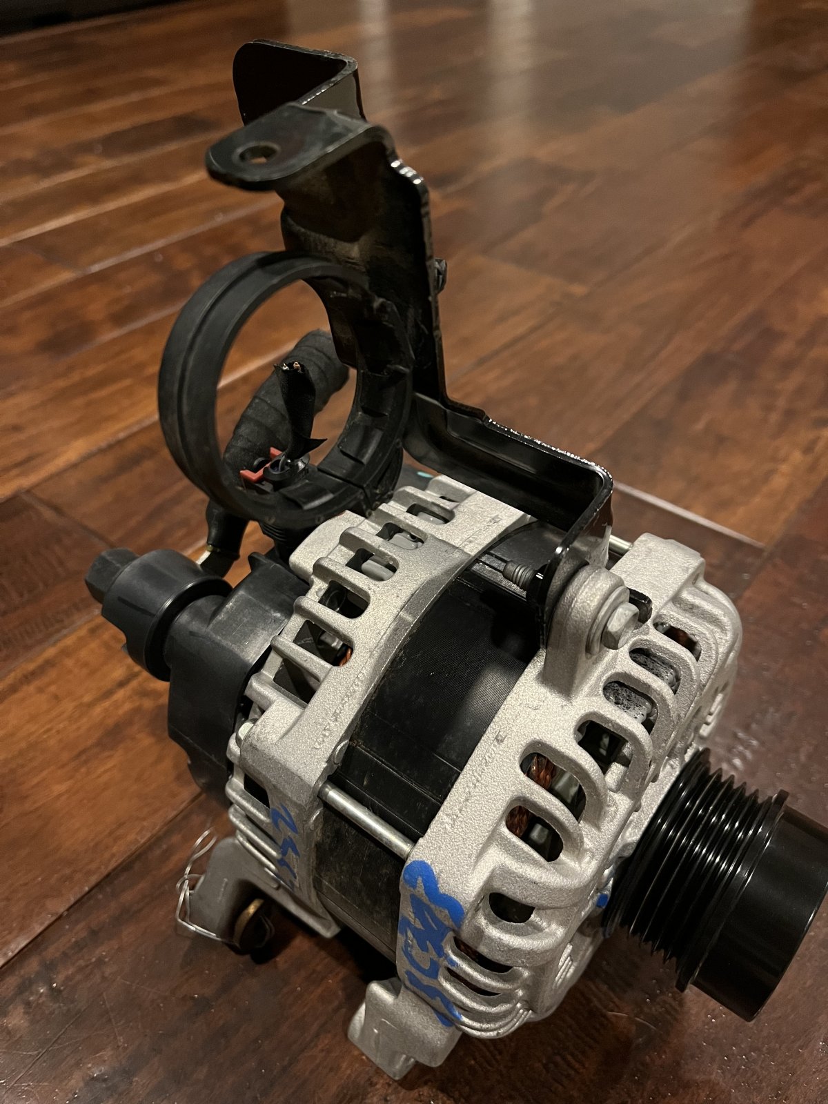

Well, this is a cluster. This alt has a totally different mounting arrangement than what I need. I went off the seller's description, which listed a part number of an alt that has the correct fitment. Their pics just showed the sticker on the alt so I didn't bother to dig deeper. Not when I had such a bōner for the super low mileage. Between the description discrepancy and their poor packaging leading to shipping damage, I emailed the seller requesting replacement or refund. On to the pics-
The original alt is like "Tab A" that goes inside "Slot B" of the accessory bracket on the engine. The new alt has the "Slot B" arrangement:
So, it'd be like this:
Which is basically this:

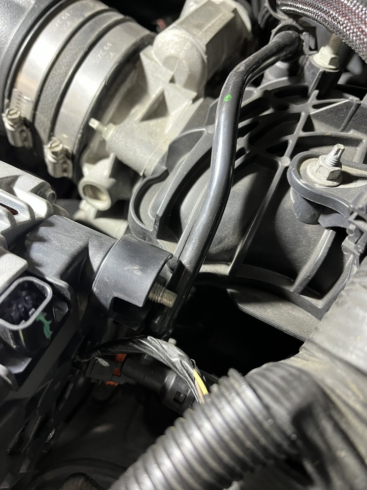

Also, the main lug interferes with the EVAP purge pipe:

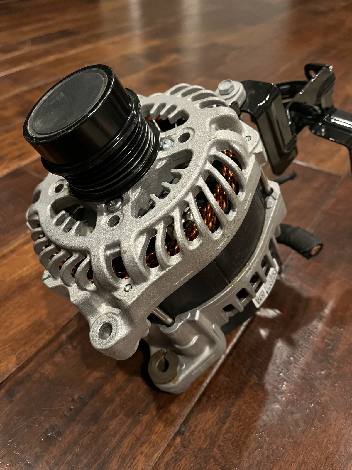

Other comparison photos just cuz:
44,968
Your eyes are not deceiving you. The pulley on the new alt is smaller.
Stock:
New:
I just kinda eyeballed it, but I think the center of the pulley is located further away from the mounting points to make up for the smaller diameter. Worse case, I bet I could make it work. But I'm not interested in such a project and it'd be too easy to screw up and then I'd be plagued with belt wear and/or noise issues. I hope the seller does the right thing.
