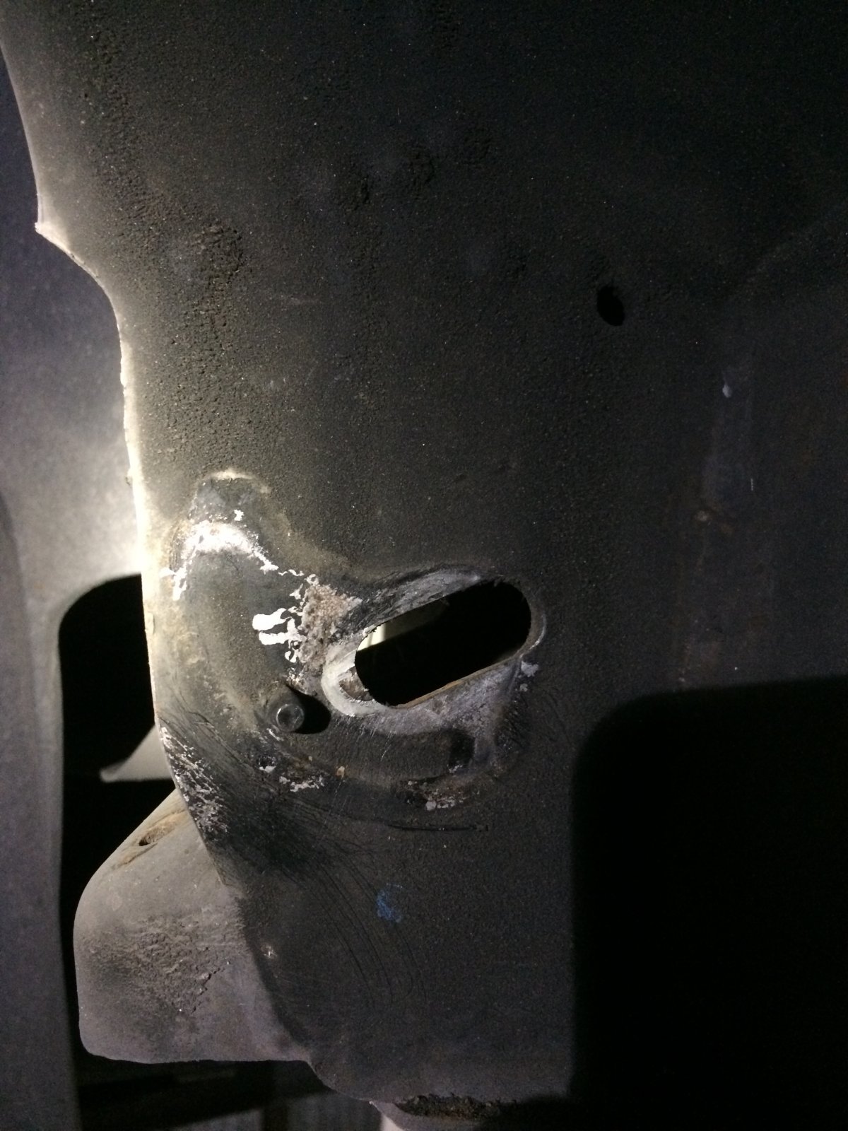

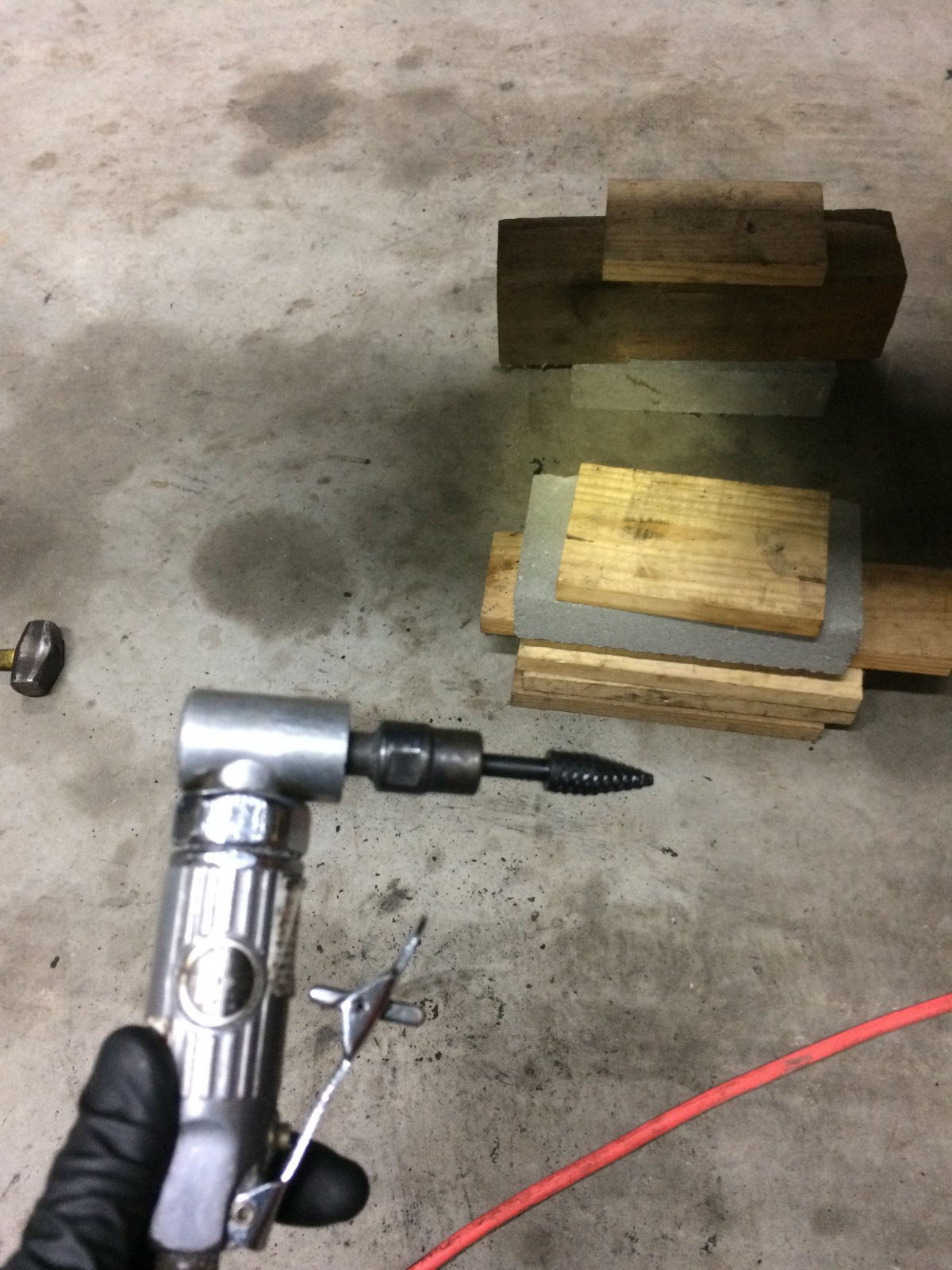

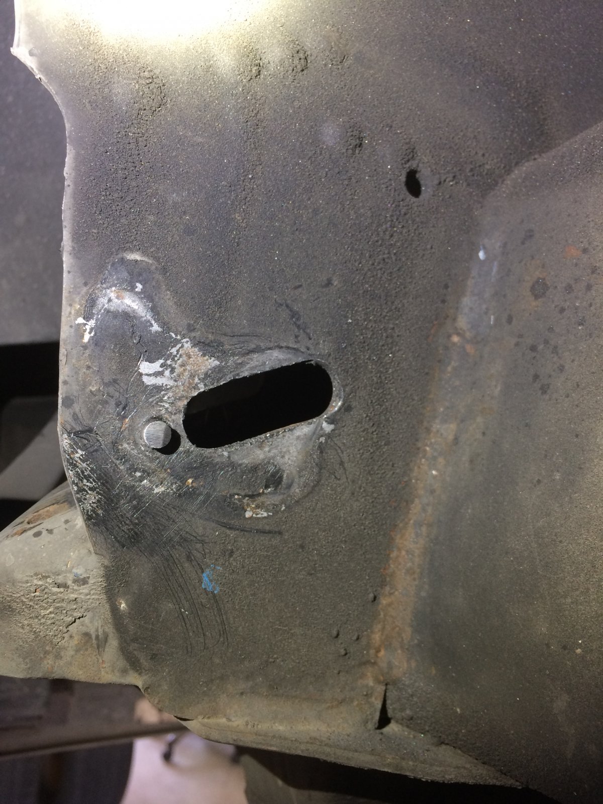

Did the free travel mod, removed the wheel spacers and un-lifted it.
Drew a line to have a general and "safe" starting point:
Sliced it along the line but cut it again higher so it'd be above the frame rail:
Didn't touch the tank! It was annoyingly close which is what made this take so long:
Whittled it down to where I wanted it and smoothed it all over with a flap disc:
Hit it with some flat black and moved to the passenger side. That one was SO much easier since I didn't have to perform the surgery around a fuel tank:

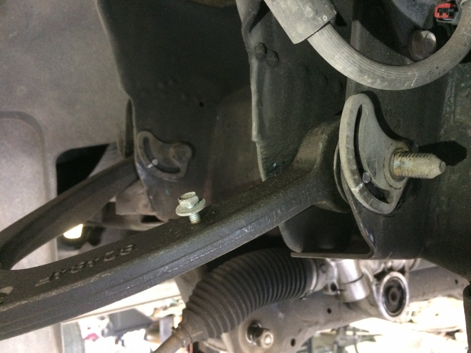

While I had the springs out, I compared them to the 3" McGaughy's coils and some "mystery" coils I wanna try:
I put the stock coils in, minus the 1" lift spacers so I can get baseline measurements of height, pinion angle, control arm angles, etc. Then I'll install the McG coils, ride around for them to settle in, then take more measurements and note ride quality. Then I'll swap those for the mystery coils and take more measurements and ride notes.
