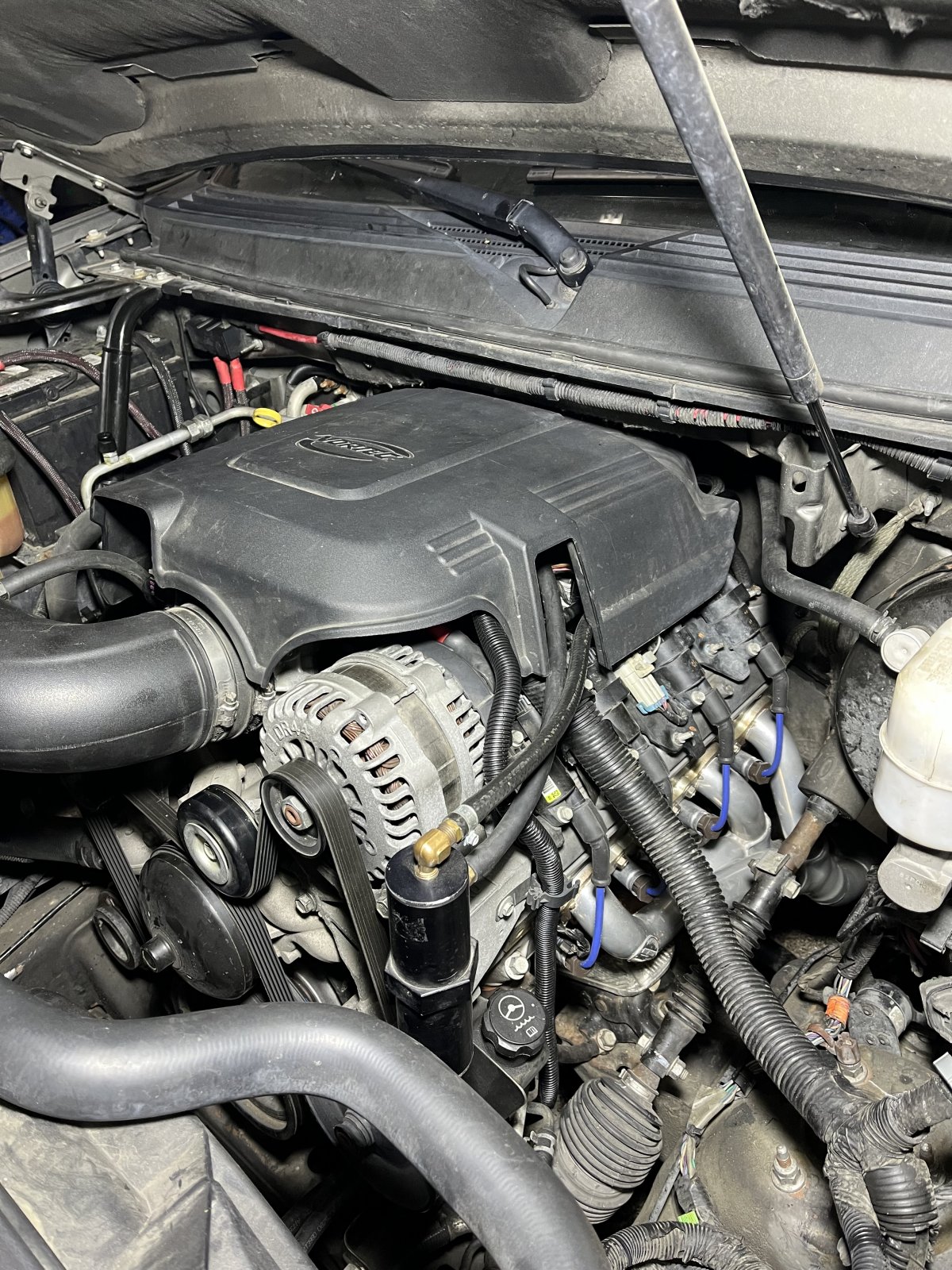

All the rest is just reassembly of stock components in the reverse of their removal, so no need for boring pics. All reassembly took place throughout that Saturday and the following Sunday.
On Sunday evening, around 1900, after priming the oil and fuel systems and filling it with two bottles of coolant system flush and hose water, I went for the first start:
It fired right up with no hesitation or stumble or lifter tick- all why I prime those systems first. I topped off the coolant and let it come up to temp while keeping an eye on all the vitals:
44,966
After a short drive around the block to watch the vitals and test the trans, I stopped in at the local Community Center for another vid. Tropical Storm Cristobal was still visiting so we were getting intermittent bands of rain. Also, neighbor wasn't around to help me reinstall the hood:
...And that sexy idle vid I posted elsewhere earlier in the week:
