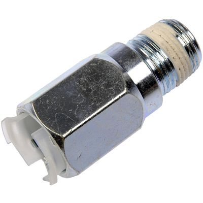

Ok, so i have been considering this as preventive maint. After researching the install video's on the all mighty u tube it seems that the feed/return line QD'S are just as likely to fracture at the plastic union as the "T" connector? Since we would have to adapt to the driver heater core with hose and clamps would it be wise to eliminate the QD'S entirely and simply run standard heater hoses for the feed/return lines to the "T" and from the "T" to the rear passenger core metal lines???. The OE hose's are like $50 to $70 each and still have the weak QD.

Yes... you can slip a regular hose end over the male end of the T-connectors to alleviate one plastic part that is prone to break.
If we get enough interest in these then Gruven will make them and they won't have QDs anymore. They will all be hose and clamp afterwards.
If it were not for the rear heater core lines we could just slip the hoses onto the front heater core nipples and clamp it and be done but that would bypass the rear heater core and we wouldn't have rear heat.

So your/gruven's design will allow me to hose and clamp all connections and eliminate all factory heater hose's up front with QD design?
