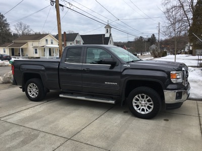

Welcome to the Forum from NH.
Pics of the truck, please.

Guys chime in n my hunch here. Didn’t GM update the pickups a year earlier to what our full size SUV are split between 07-14 & 15-20?
Wouldn’t that make his ‘14 Sierra a ‘15 body style?

As in a GMT K2xG?
