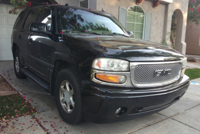

Newb as you all can tell. I am pretty new to it all but ultimately I would like to start keeping record of my time with my Denali. I first picked it up back in 2007 as a one owner vehicle with around 45k miles. Please feel free to comment with recommendations or comments. Here are some of the modifications I have done over the years and future ones I am planning on doing:

Sounds great but the image isn't pulling up

Haha I've been trying to figure out how to edit it, for some reason the link disappeared...

List looks good. Looking forward to the pics.

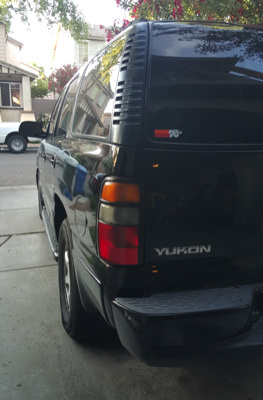

Good start, good list. Ditch the K&N sticker on the rear window. It does nothing for such a good looking vehicle.

Haha yeah it'll be coming off here soon. You definitely make a good point there kind sir.
