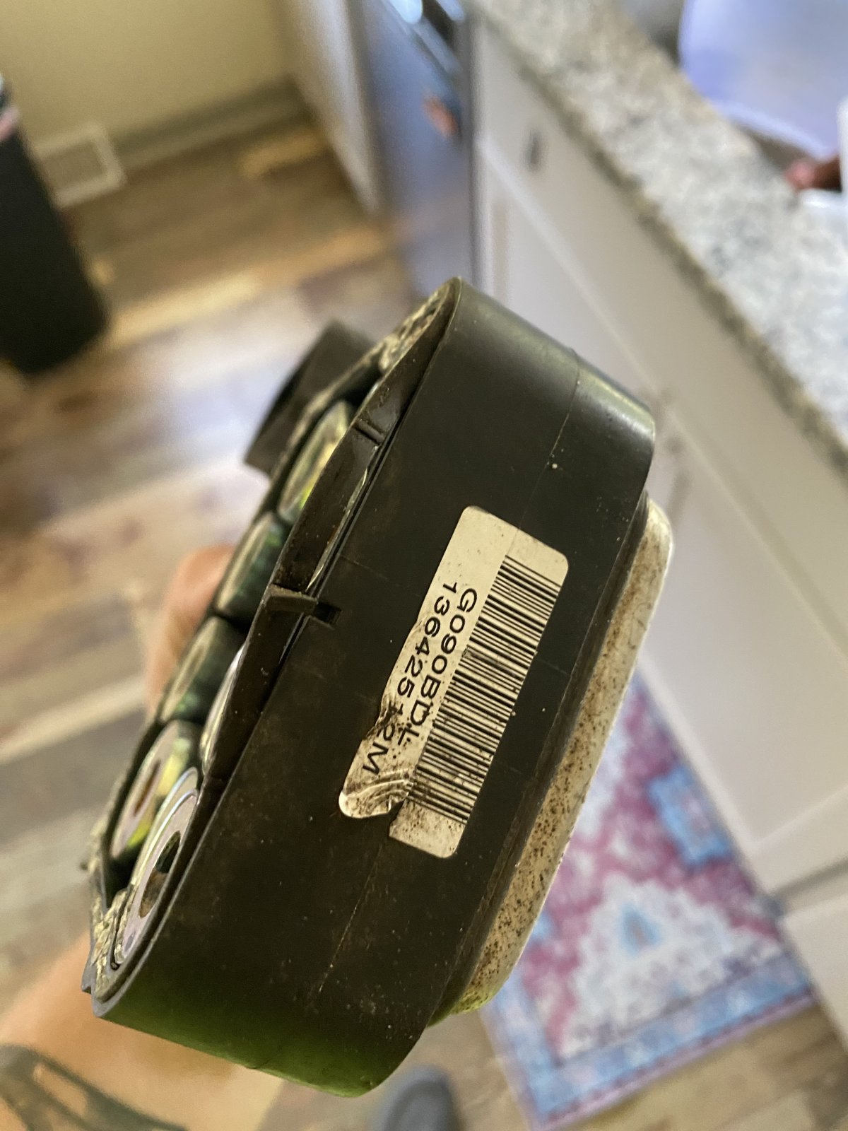

I have replaced the fuse, reinstalled the ebcm, cleaned and reset the ecu. Dismantled and cleaned the entire fuse box. Cleaned and prepped every ground and still all all the light and messages. I’m now learning that the abs module I have is discontinued. My rig is awd, with active brake control, and traction control. It essentially has every option and that module is no longer sold. Called gm they gave me a new part number that I get some hits on but from very no name websites.
Below is a picture of my unit. The new part number gm gave me based upon my vin is 19368154
