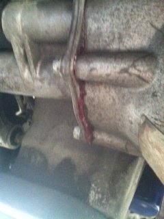

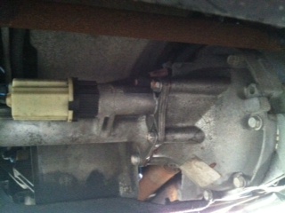

here are two pics with the red grease. its weird because it looks like trans fluid is coming from here. what kind of seal should be here.

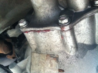

here is another pic to help locate where im talking about

that red stuff looks more like sealant than fluid?

the read stuff feels like grease. idk. i going to try the steering shaft first and go from there.
