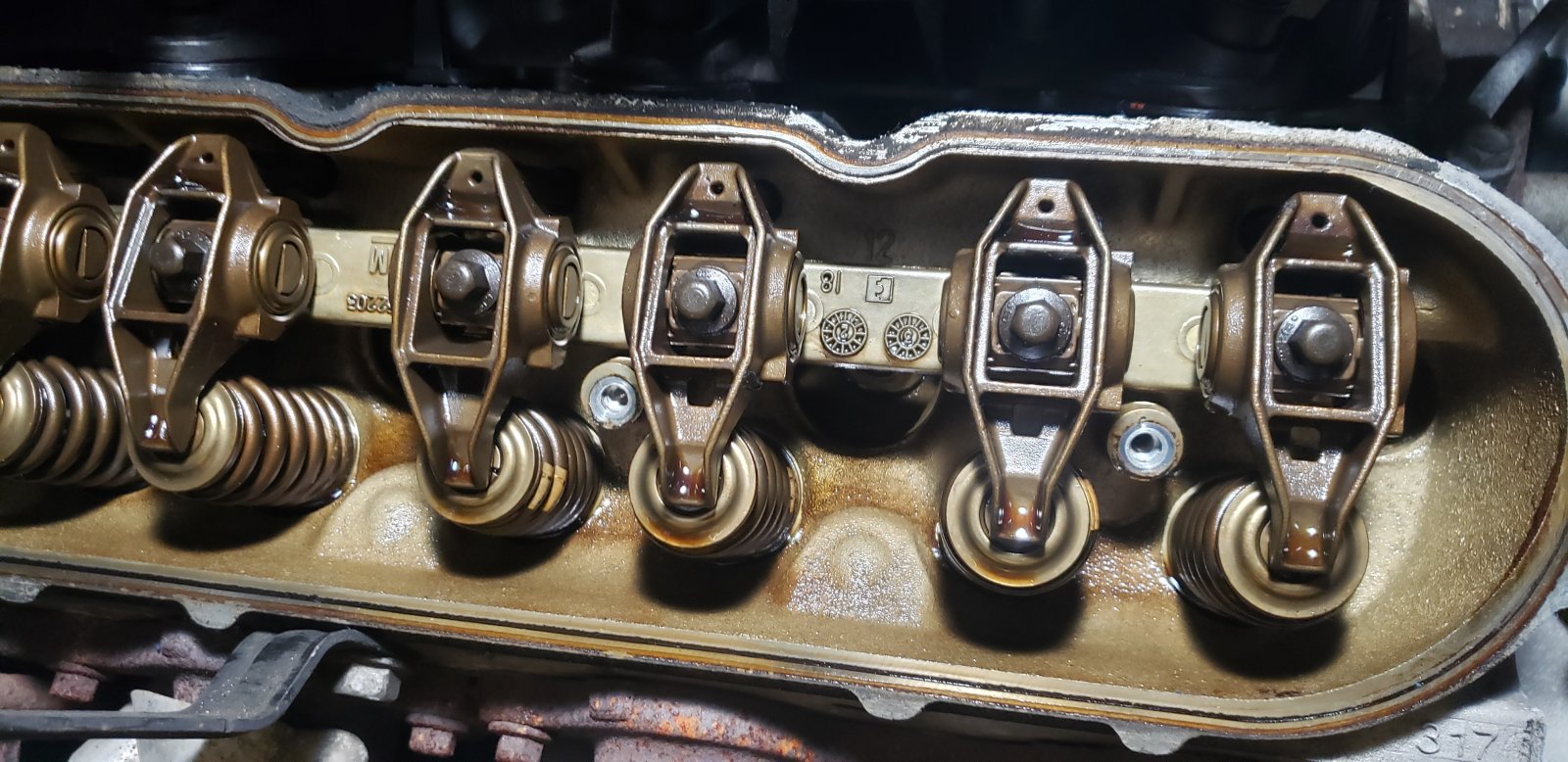

Judging from your old valve cover, you have a lot of engine blow by either past the rings or valve seals. Or simply a plugged PCV hose. Should look sort of golden inside. Below picture is an LS 6.0 at 120,000 miles, oil changes every 4,000 miles.
Had another set of heads on the shelf ready to go, and since I was pulling these off to change minor head gasket leak.... Put the other set of heads on with updated valve covers

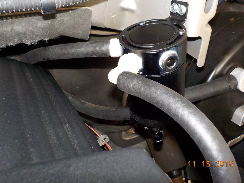

I added a catch can first and was catching 1 oz of oil every 100 miles. After the ds vc change and combustion chamber/piston soak it dropped to next to nothing, and remains that way still.

Yes, that picture of the inside of my head is a generation 3..... With a lousy PCV system that I upgraded to the newer 6.2 style valve cover. The old one actually used a PCV valve.... Looks like it had been doing its job properly though.
