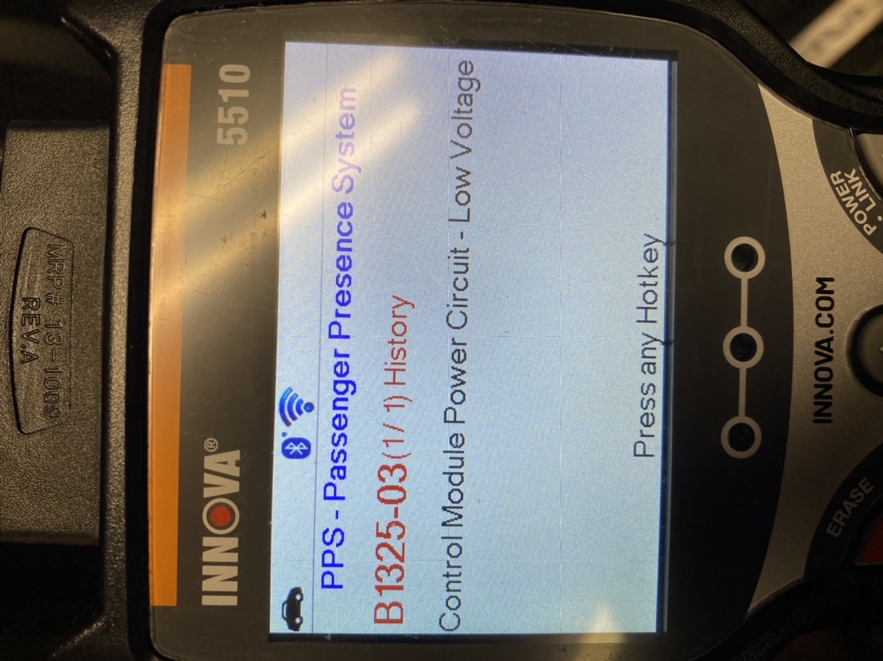

Bummer! Strange thing is my BT scanner found the ABS problem I have, but simply can’t find the SRS.
I’ll perhaps leave the airbag problem to a rainy day and jump into the ABS problem. Thanks for all the input!

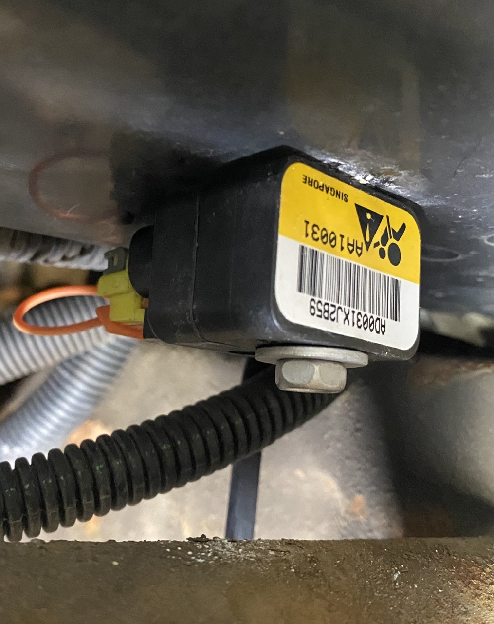

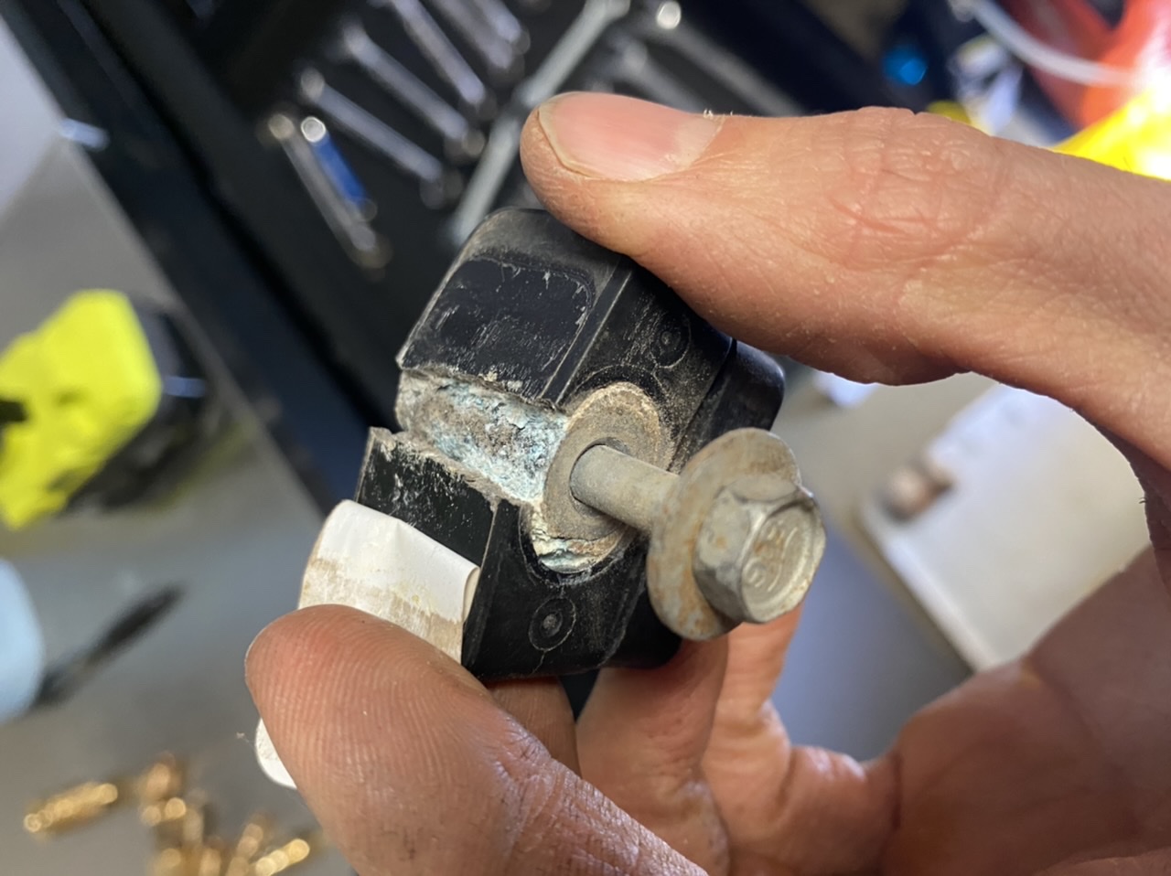

Well...first off...you know you’re a gear head when you’re working on the truck on a Friday night.
Anyways, I got under there and took a look at the front sensors and they both appear to be cracked from the looks of it.73E00803-37FC-42FD-9FB9-377DD05BFA04.jpeg
Anyways, I got under there and took a look at the front sensors and they both appear to be cracked from the looks of it.View attachment 259673

Is the leak coming from the transmission cooler lines that go from the trans to the radiator? If so, they’re not terribly difficult to replace so it depends on your skill level. As for the sensors, it looks like the common problem but you should go to an auto parts store and have the codes read because those are expensive. I didn’t realize they’re about $175 each.

If the codes do point to one or the other sensor, be sure to match the item number for the new one as Eric O. stated.
