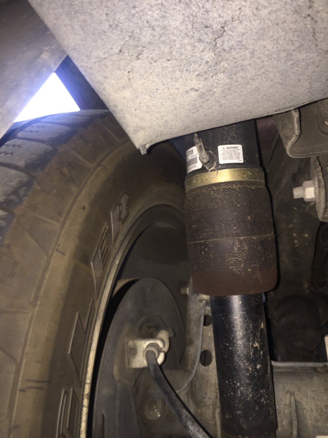

Do yours look like mine with the rubber bladder?
25,998
50,839
Make sure the air lines actually hook up to the shocks and check for air leaks where they connect using soapy water. Also look for blown out air bladders on the rear shocks and listen for air leaking;; fronts aren't air shocks, they only have electronic damping.
