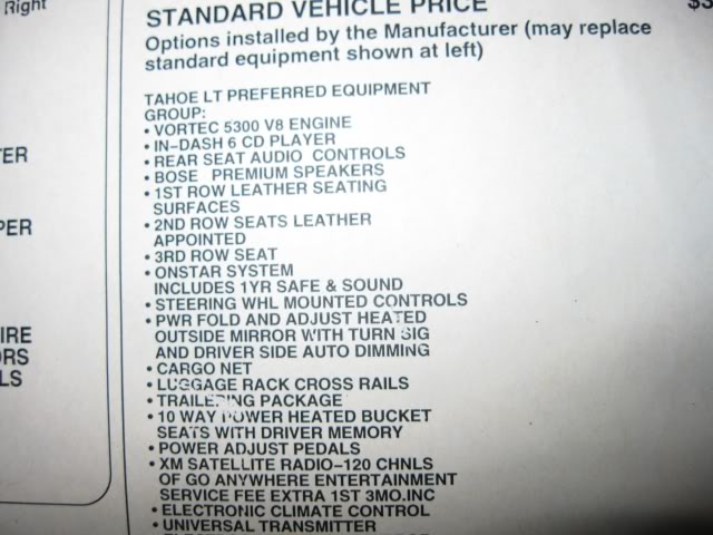

I just bought a 05 Tahoe this saturday. The dealer said I had Autotrac transfer case, with stabil trac traction control. But I am not sure. I have attached some option pages and photo of Transfer Case.
Can you tell me what Opts I have so I can figure what fluids I need to get?

not really looking for a vin look up as I already have the codes. I wanted to try and figure out what Trnasfer case/ drive system I have and what fluid it takes.
What I figure its a NR4 transfer case with stabiltrac control All wheel drive- Dexron III
fluid. The tranny I think is a 4L60E? not sure/

download the one for your year model and you can compare the RPO codes to determine all options.
for 2003 NP8 is autotrac and JL4 is stabilitrak... but they are exclusionary. you can not have both.
you have NR4 - transfer case open differential 2 speed
Included with (JL4) stabilitrak
