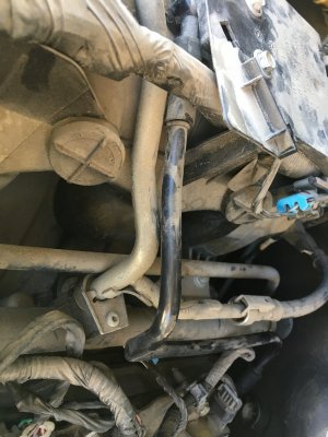

Decided to try this cheap endoscope somebody gave me to check for oil back by the camshaft position sensor, oil pressure sensor, etc. I know it’s blurry, but it looks like oil to me. I swapped the oil unit before. Anybody else think this looks like my leak? BA43D931-0B48-4C3E-84BD-1AD2576B6D74.jpegBA71FCA6-7253-41BB-8C5D-3387F35654DC.jpeg
