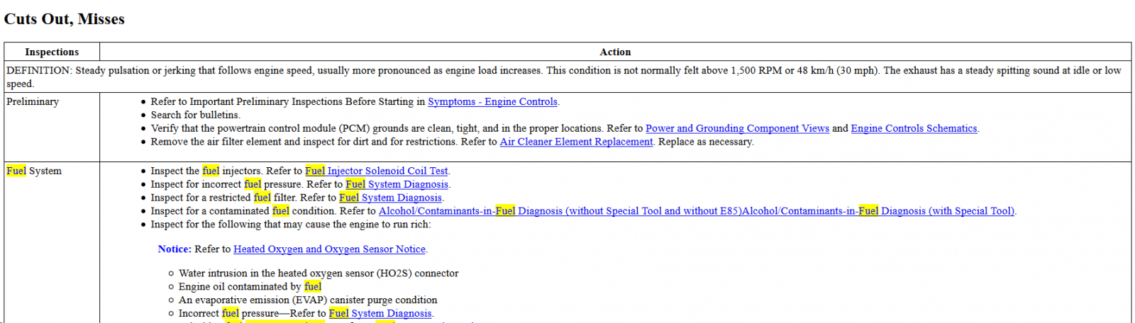

Sorry to hear you're still having this issue.
Here's a diagnostic tree I hope can prove helpful. It's a lot of things to check, but I think would be worth your time. If there's anything in here you need more guidance or specs on, let me know and I'll provide info :)

EGR will be a larger metal tube entering the intake manifold on the passenger side, just behind the throttle body. Ya can't miss it
Whoa. Awesome! Thank you!! I looked for the EGR after work. I definitely do not have one. FPR will be my next replacement. I also want to put a stock air intake back on. I’ve never really been a fan of these CAI. After the FPR if that doesn’t fix it I might take it to a shop.....super frustrating, if I wanted to hunt gremlins I would have kept my Audi haha
