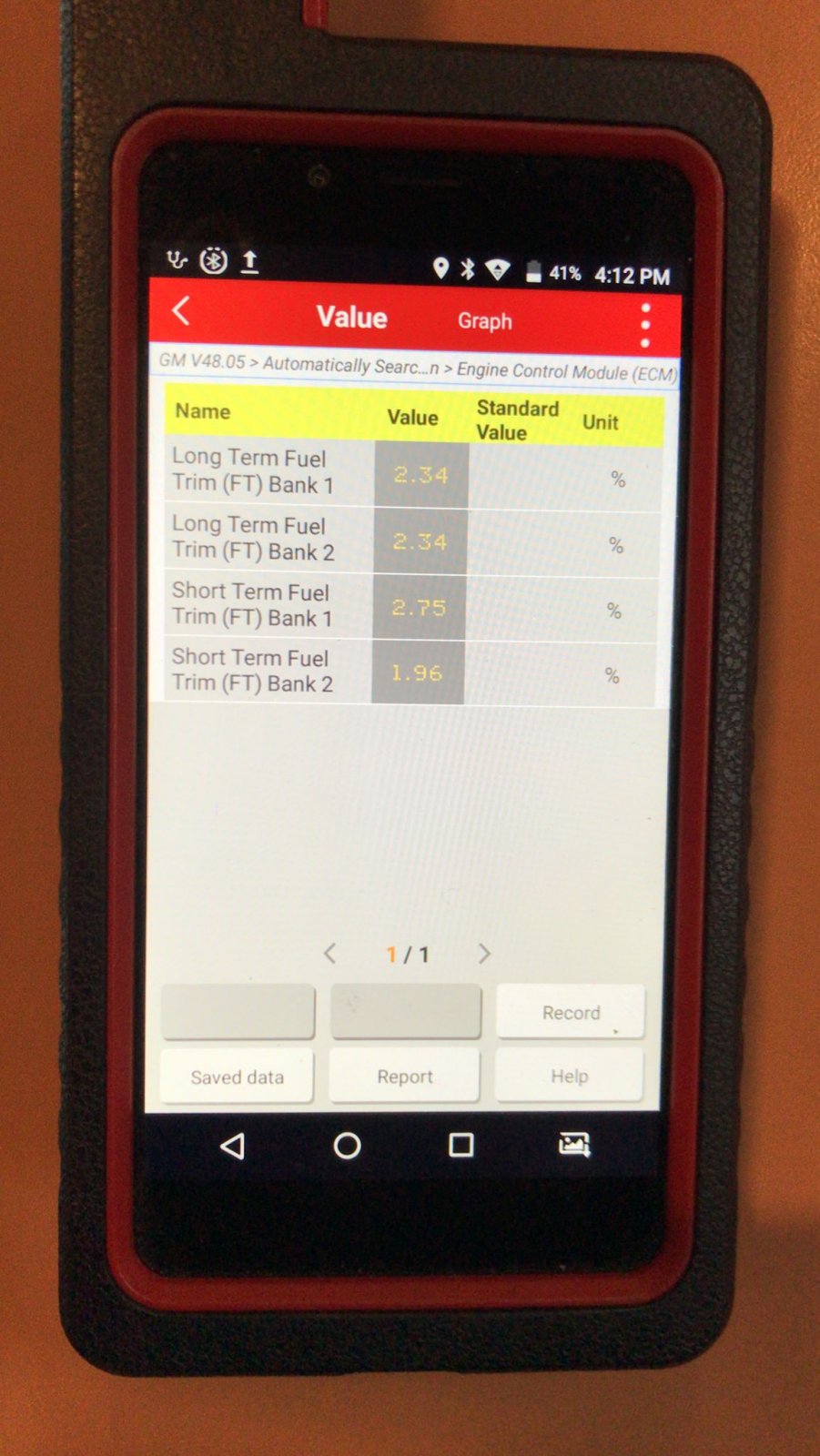

-4% fuel trims won't trigger the CEL; besides, that means it's in a rich condition, not lean, taking away fuel. We'd all have CELs if that was the case.

I disconnected the battery for 5 mins to reset the LTFTs. They almost immediately run up to +24.55% on idle (the max). But drop to completely normal values the moment you give it throttle.
I also did the water test on both banks for the inlet manifold gaskets. Zero rpm change and zero steam out of the exhaust, engine continued to run the same. So as far as I can tell that rules out my intake gaskets as the problem.
Seems like its a big vacuum leak on the intake side of things, but where :(
Sorry thats a typo. It was +4%. But indeed +/- 10% is considered normal and wont set a CEL.
I presume now having enabled some more PIDs on my scanner that its the LTFTs being pegged at +25% thats causing the CEL.

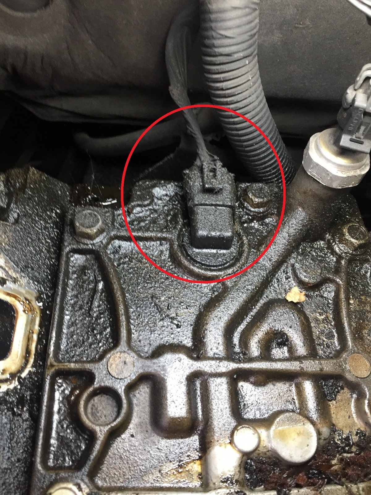

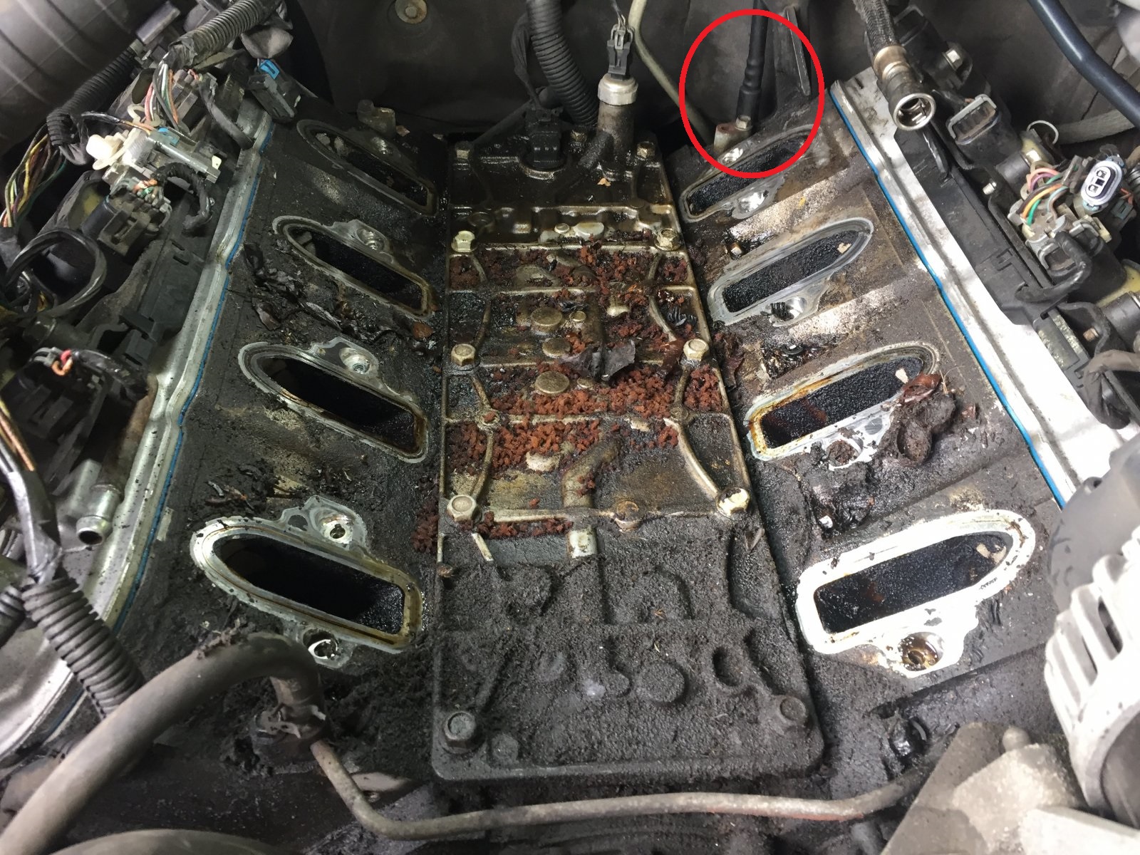

Just thinking out loud now... If the oil pressure sensor wasn't tightened down quite tight enough, could that cause a vacuum leak?

I managed to reset the LTFTs by disconnecting the battery.
On closed loop they rise to 25% (max) at idle quite quickly. On the road/under throttle they immediately lower to normal levels.
