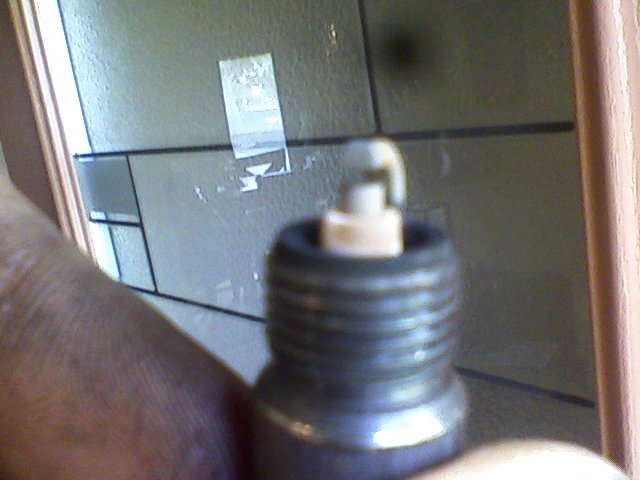

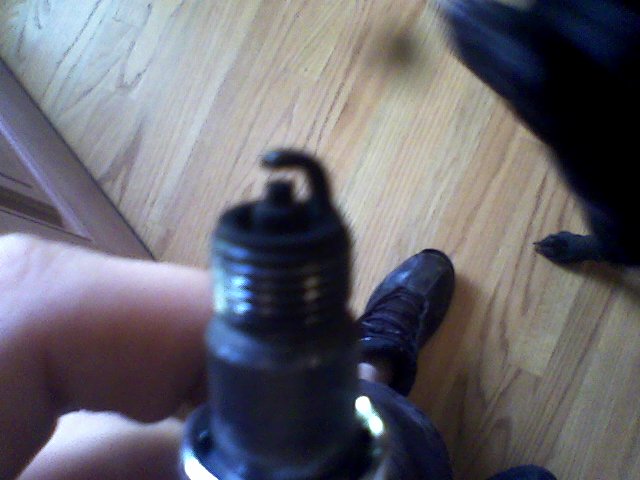

also the plugs on the drivers side are getting worse. 1 is not bad, 3 is a lil darker than a cream color, 5 is brown, and 7 is almost black on the porcelain.
