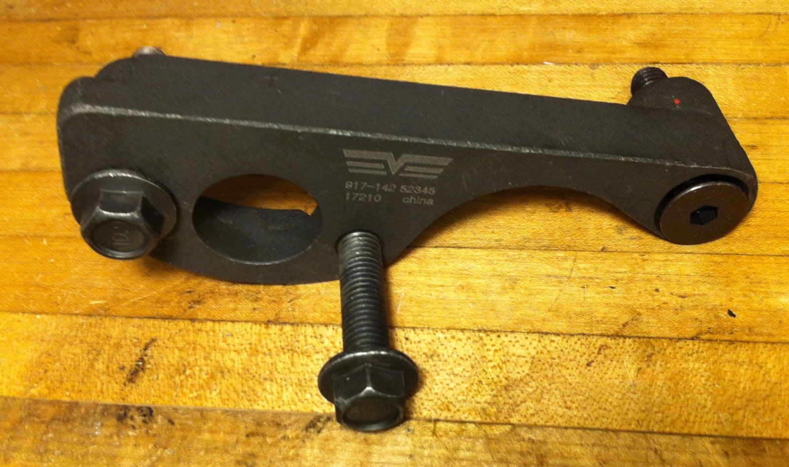

I have an '01 Tahoe (4.8L) that the rearmost exhaust manifold bolt on the passenger side has broken off of. I bought a Dorman exhaust manifold clamp (Dorman part #917-142) and attempted installing it today. The procedure went something like this:
I noticed that some reviews on Amazon (such as this one) indicate that bending the dipstick tube is required. I don't really want to bend this if I can avoid it--also, if I bend the tube, I think I'd also have to modify the bracket that secures the tube.
However, I then got the idea to countersink the hole on the manifold clamp and use a flathead allen bolt instead of the flange bolt that is supplied with the bracket:
This solved the problem of the dipstick tube rubbing on the manifold, but it still hits the clamp (though not as bad).
Does anyone have any experience with these that knows any tricks for installation?
I noticed that it seems like the dipstick tubes for later model GM's (including the 4.8's/5.3's) are routed differently, and go between cylinders 2 & 4 (like this one on PartsGeek; see also this GTO engine bay) instead of 6 & 8, like mine. I don't think I could use a dipstick tube that goes between 2 & 4 on my Tahoe because it doesn't look like there is a bolt hole to use for that.
I think my options are this: (1) see if I can find a dipstick tube that would router differently (maybe between cyl. 4 & 6?); (2) shave more material off of the manifold clamp--I think I could machine the problem side shorter; (3) get a tubing bender & try bending the dipstick tube.
Any ideas...? Anyone know anything about changes to the dipstick tube routing?
