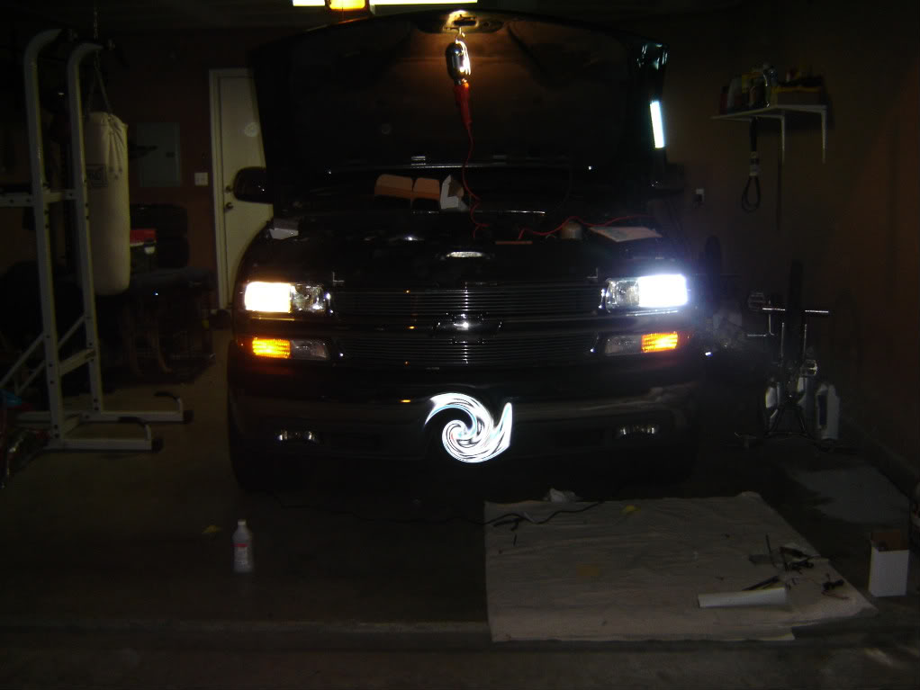

For those of you who said cut the extra wires you were right!:Handshake:
I checked the DDM website and found all the info under DIY. Once I got under the truck and saw if was all PNP easy!! Hell of a lot brighter. Nice and white. not really seeing the hint of blue. if it's there it is minimal. Downside I really need to adjust my headlights down now. :Boo:
