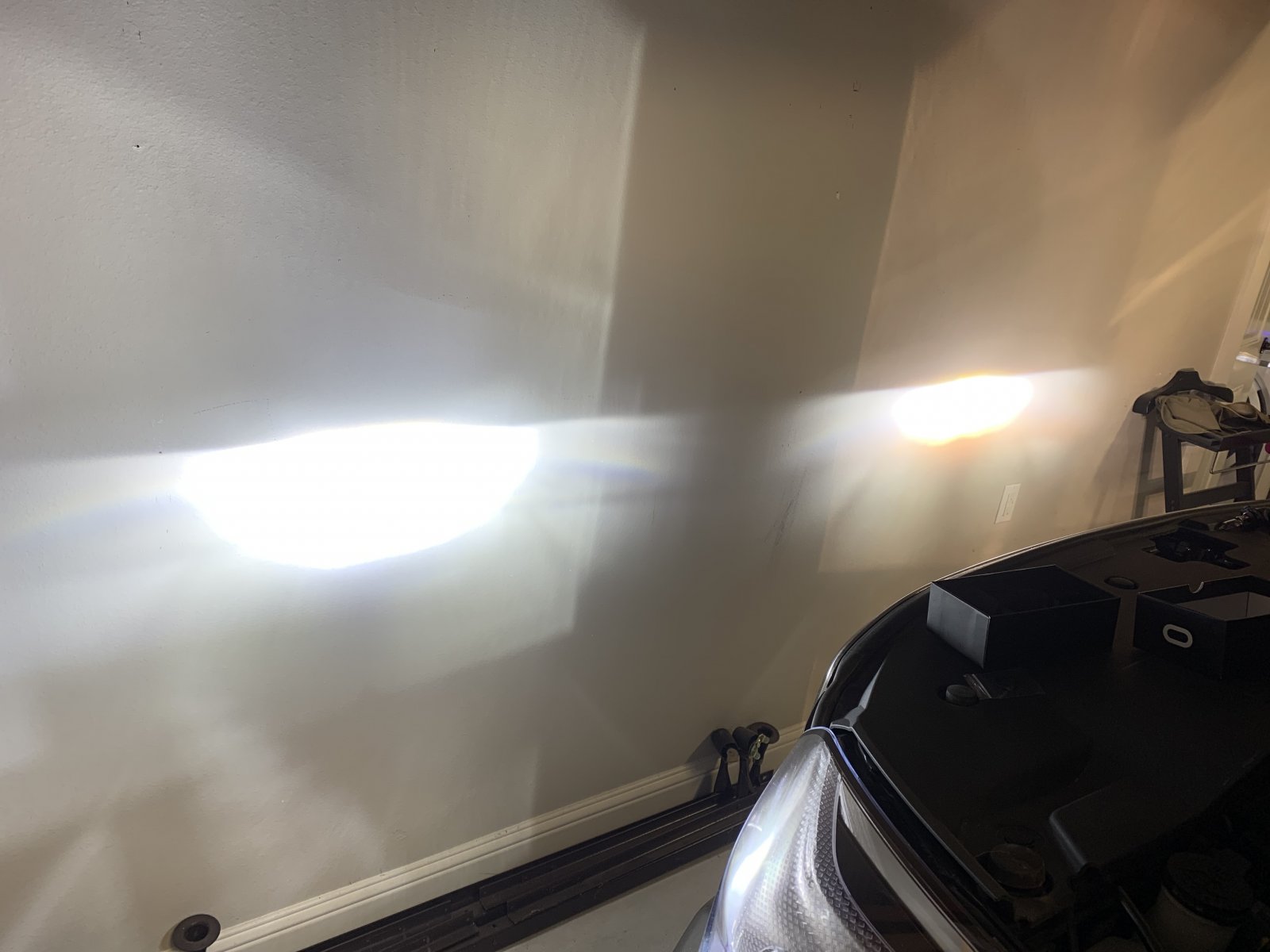

This is with LED low beams on, stock high beam in the right, and VLED in the left high beam.0EA6F8BC-DD3A-4A23-AD97-BA9A5CC63D17.jpeg

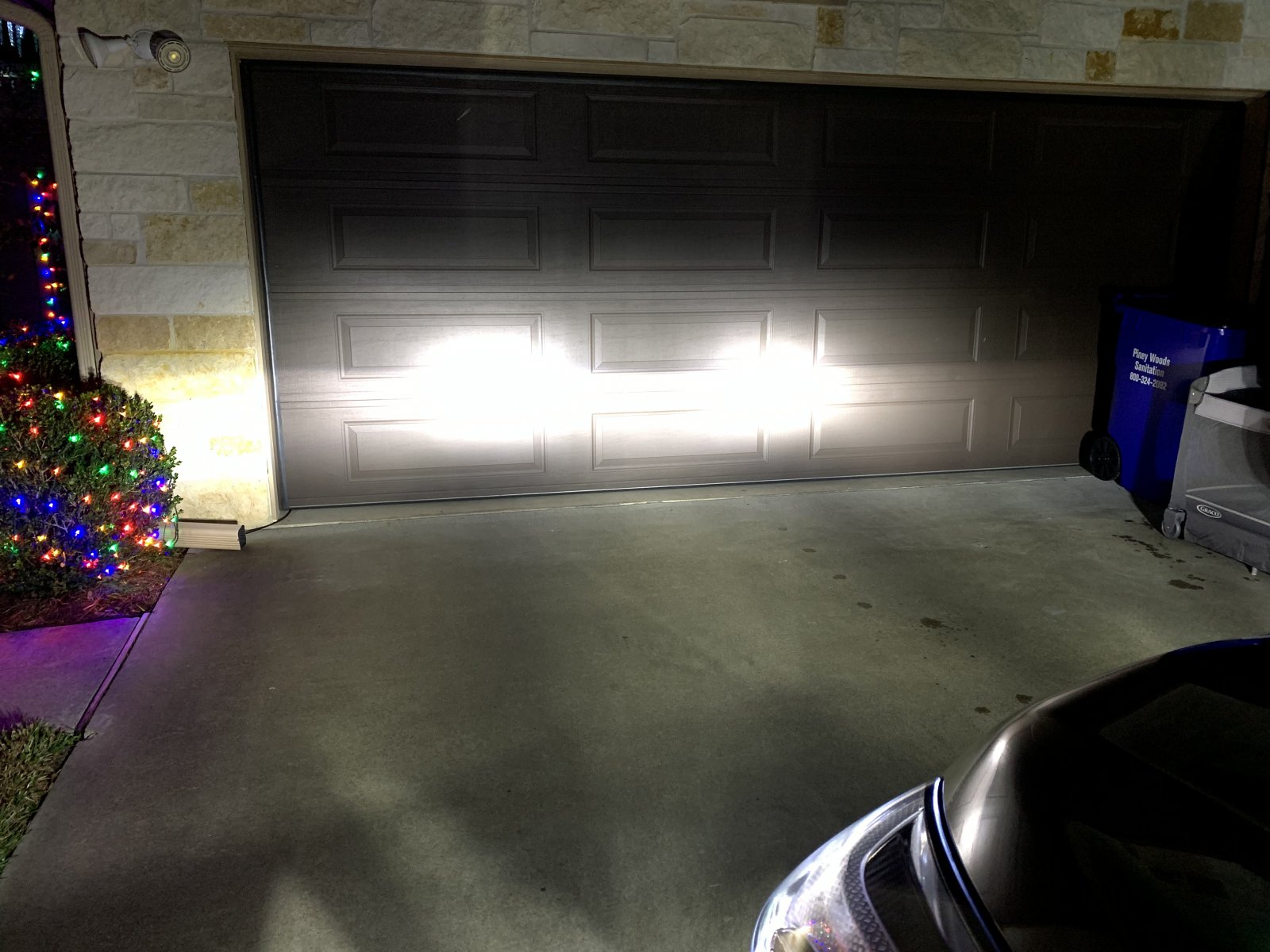

This is with low and high beams.

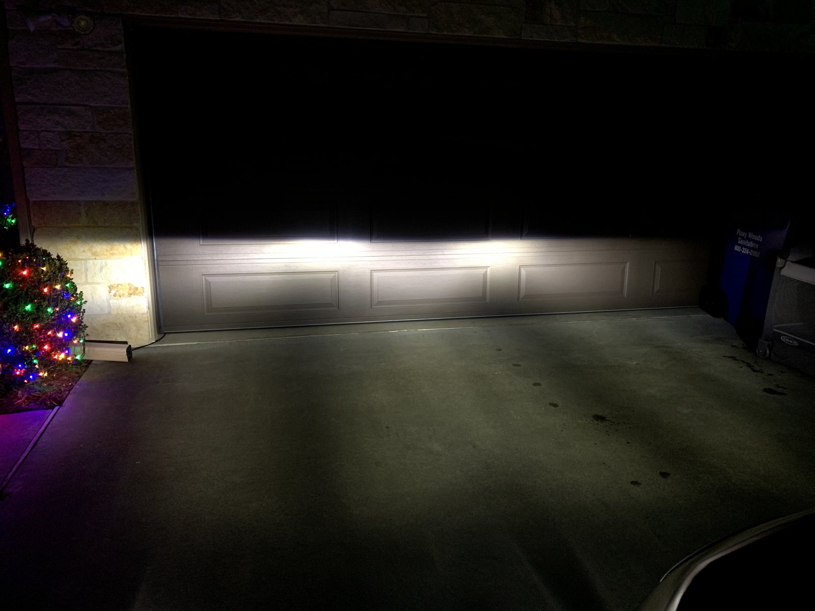

This is just low beams.
This is low and high beams.
