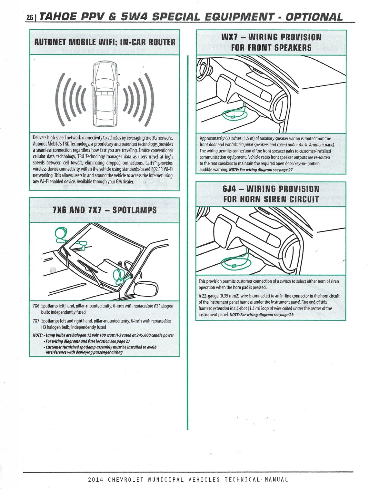

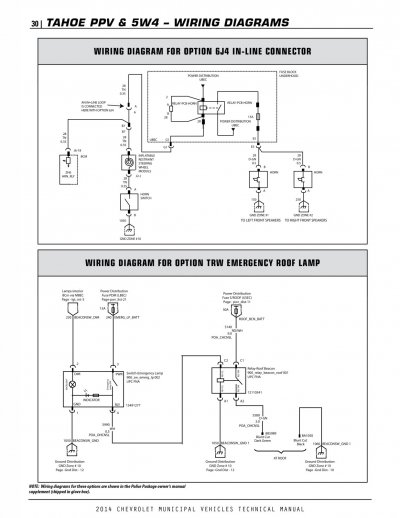

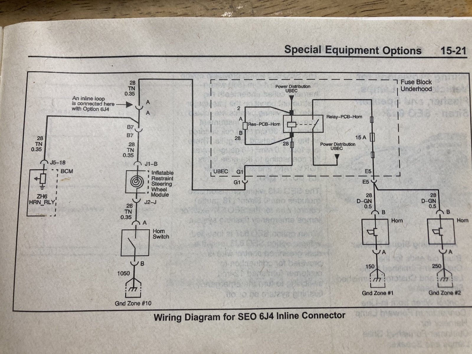

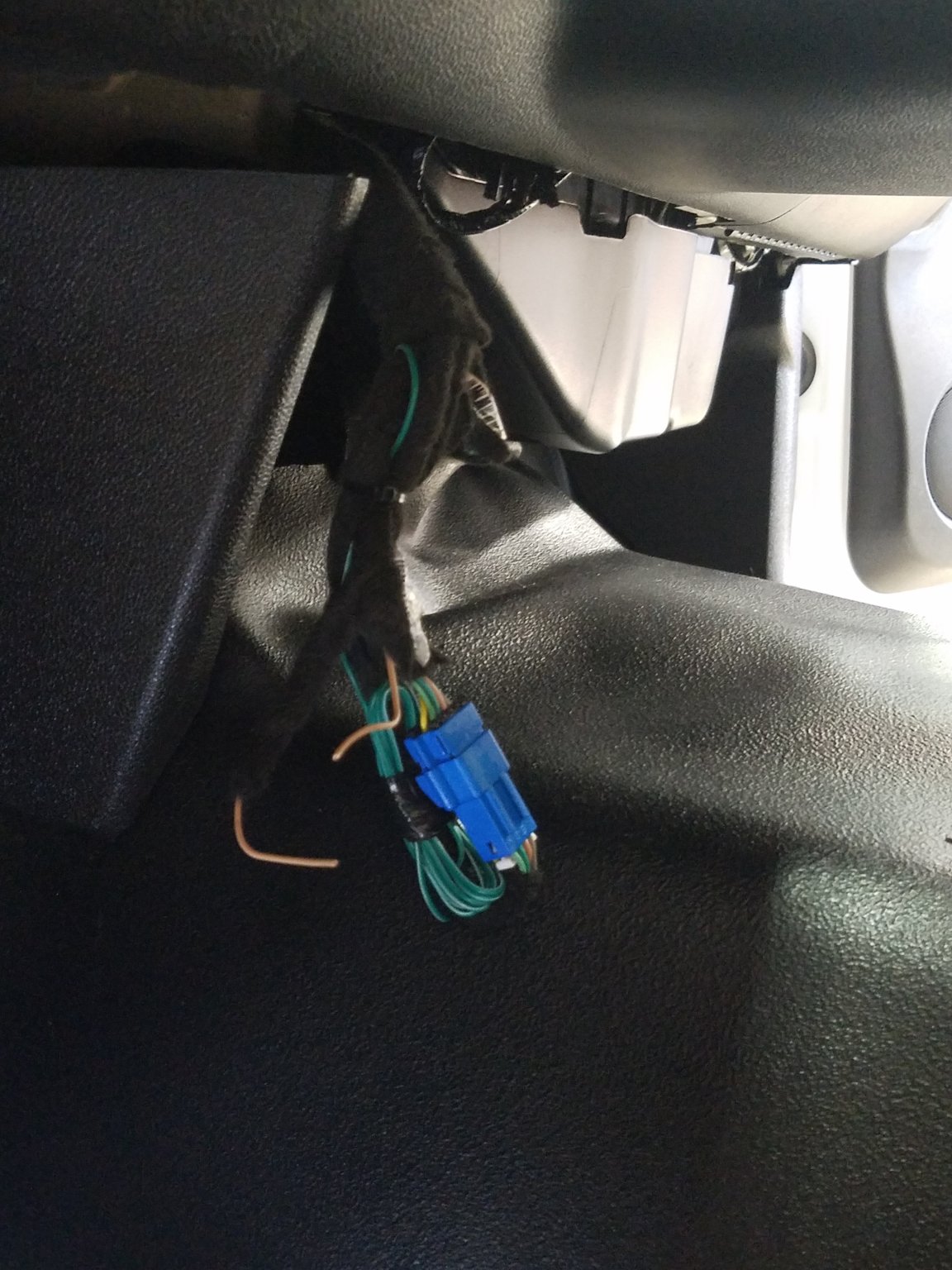

Check your RPO option codes, the sticker in the glove box. It may be wired for a siren. Gmupfitters web site has the wiring diagram for the extra wiring for police options there should be 2or3 extra harnesses stuffed under the radio also the ppv ssv owners manual supplement has info. under the hood on the left side on my ssv is a harness for grill lights and siren it has I think four wires , try a test light on those while someone tries to blow the horn. good luck . you can probably hook up your flashing lights also I would stay away from the BCM for now
JoieDeMort
May 18, 2016

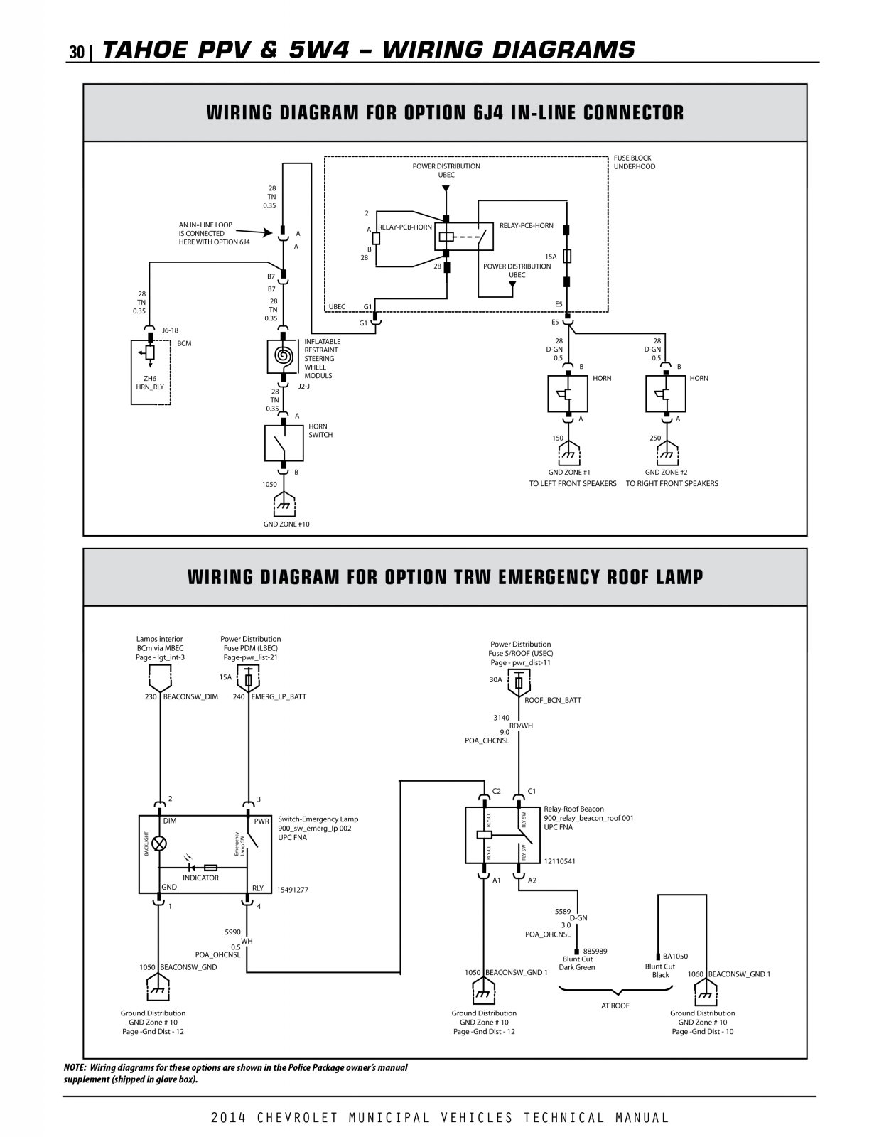

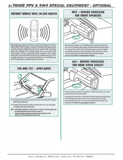

For mine, after hours of online and manual research and probing around, it was a very simple fix. I found the 6J4 information in the manuals as referenced in the images above, and I found the correct wire which was tucked in the dash under the radio. I lay down on my back under the dash, found the coils of wires, and I identified the jumper cable for 6J4. It's a really thin black wire. Whoever removed the siren switch simply clipped the jumper and taped the cut ends with electrical tape so that they didn't actually connect. However, for the horn to work, the wires have to connect. I simply unplugged and removed that section of jumper, and then all I had to do was to push the male and female spade connectors together without the jumper section. The horn instantly worked. Hope this is your issue.

Above posters are correct. i install police equipment all day long. This is called a horn ring wire. It is usually tapped so that the officer can set his siren to handsfree and use the horn button on the steering wheel to activate the siren without actually touching his equipment. Look under the dash and under radio. Most likely it was cut and not connected when they removed the equipment.

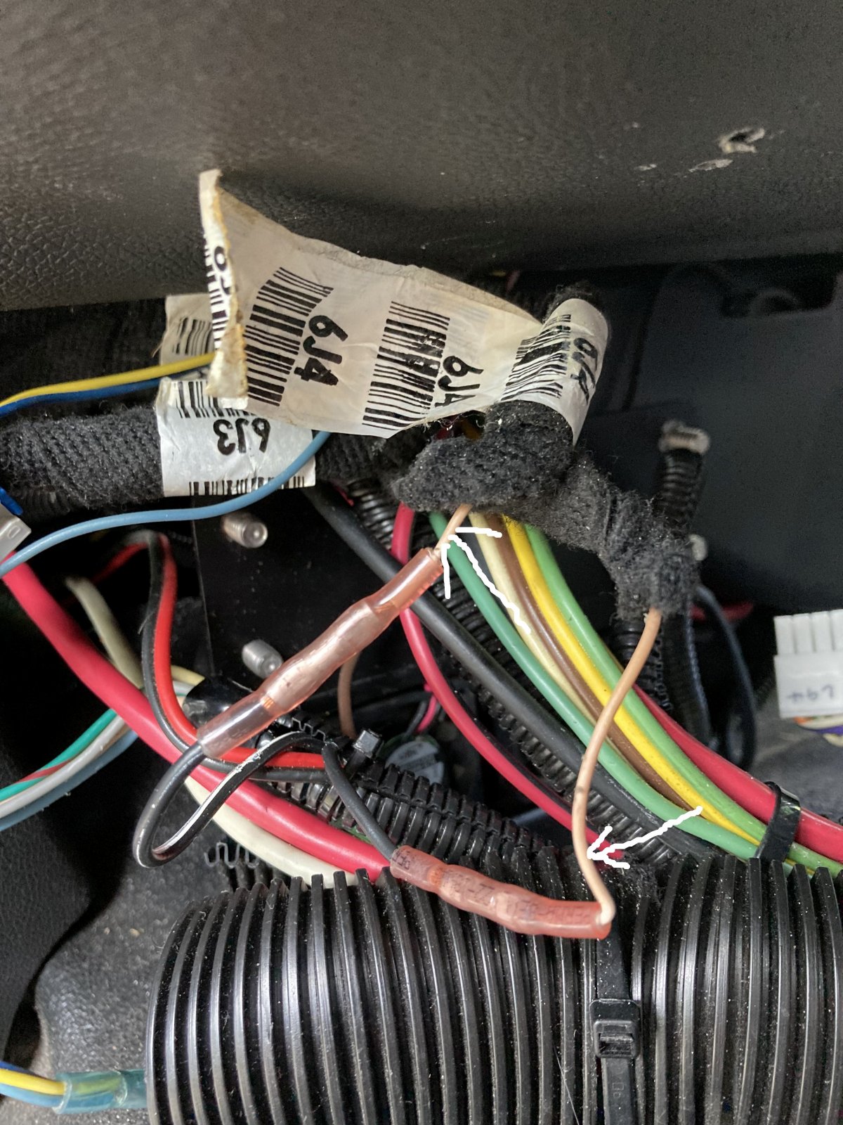

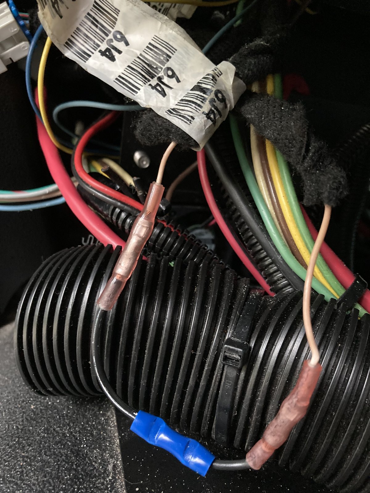

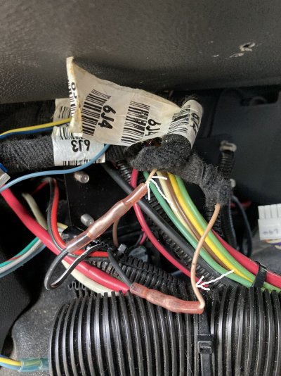

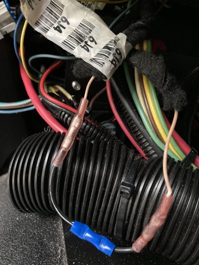

Had great success, thanks to you all and a facebook group.
You can see the two tan wires connected by the black connector. However after the red tube connector, it was spliced into a green wire as you can barely see. Right above it is the other tan wire, which is spliced into a pink wire.
I cut the two tan wires and connected them back into themselves, as shown below. Horn works.
