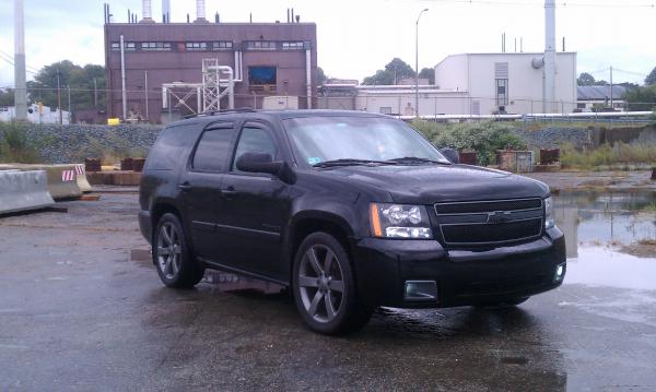

HAHA waking this thread up!...i wanted to see how it will look with my lowered yukon, but then again i think it will look ugly as its too big of a car...my buddys TBSS dont look bad without them but i think this is too big!
here. I got rid of mine and installed Street scene side skirts

They look pretty decent...sorta like a big TBSS...how much did those run you? gotta paint them as well correct

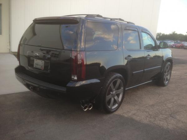

Heres mine with no running boards.
