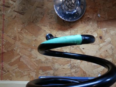

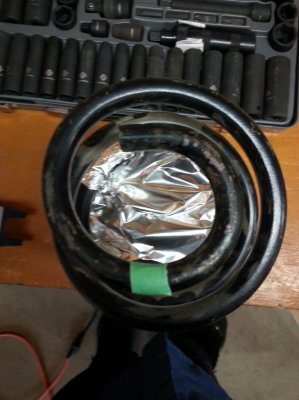

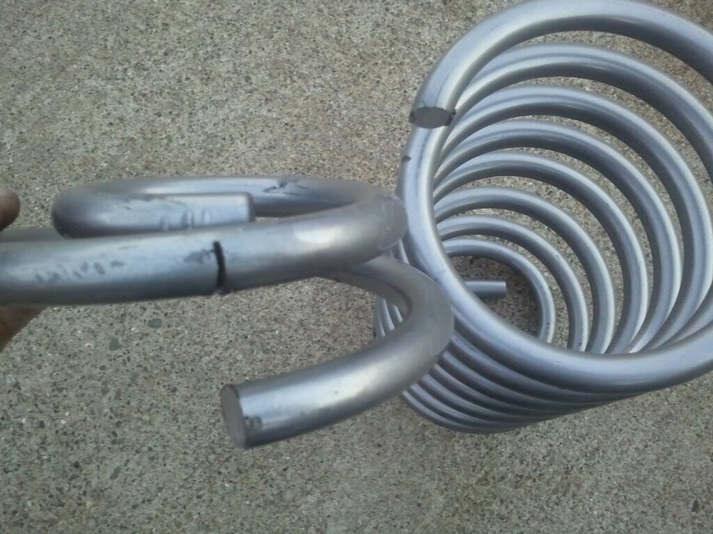

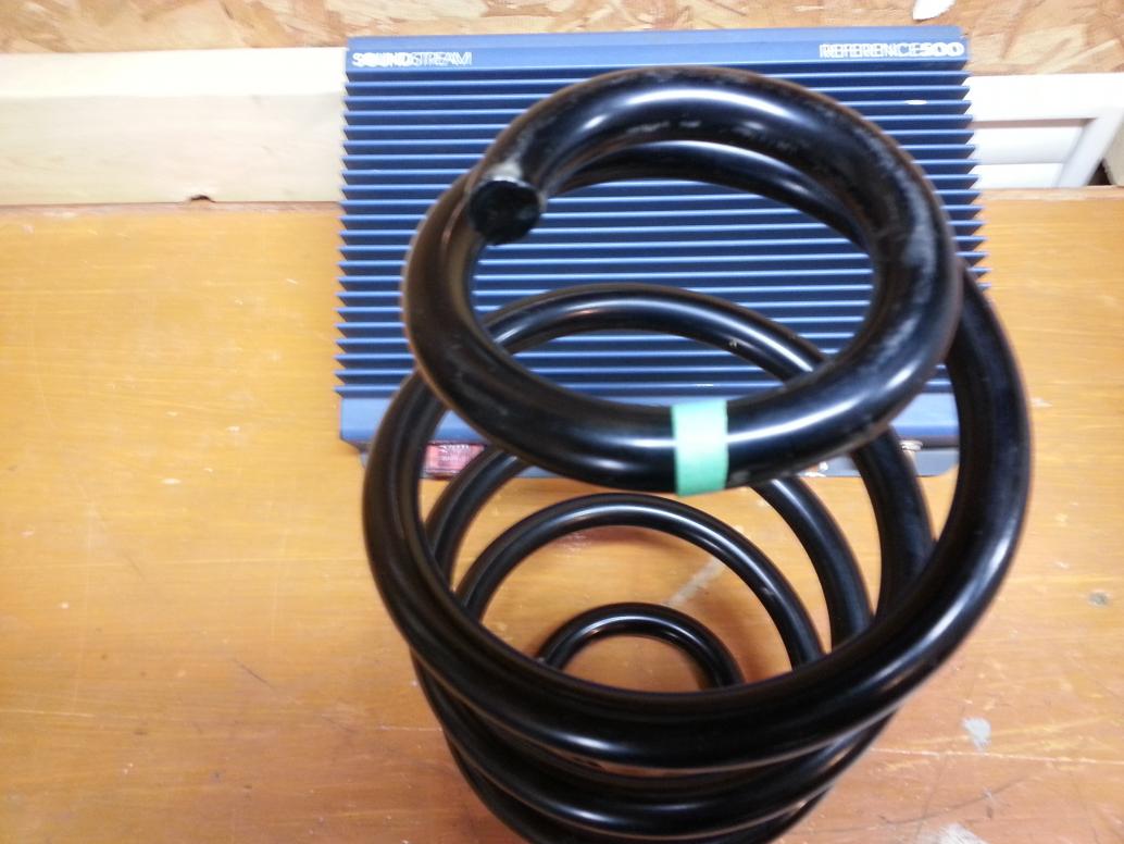

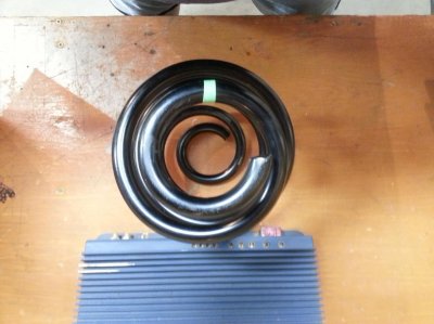

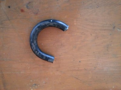

Thanks. When you cut for those two tahoes, did you get measurements? Did you go 1" lower? When you have chance PLEASE show pic of an actual spring w/ maybe tape or something to mark/show where you cut and how much it dropped? I think I might aim for 32" for now ( so 3/4" driver and 1/2" pass.) So I can use your example and judge from that. That would help so much, thanks in advance.

Thanks. Not exactly 3/6. Like most, mine is an ongoing process. I have a mix of parts/brands. Close to 4/6 right now. Current pics in album - this pic in front of graffiti is w/ 2/4 on 20's.
At this point its the lowest spring out there. You will need to cut and id do a loop off top side. Your only wanting like 1/2 inch more correct?
ALso remember if you go much lower you will need to notch the upper crossmember for panhard bar clearance.

Yes will start w/ 1/2" from lowest side ( and 3/4" from drivers ). I'm completely cool w/ notching that cross-member.
